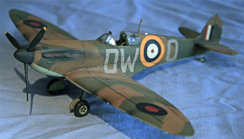

Max Headroom Posted August 17, 2015 Posted August 17, 2015 Hello in the BoB Group Build I'm doing Spitfire I DW*O of 610 Squadron. As you can imagine specific photos are rare and all I can find are the Tamiya 1/72 and 1/48 built up models like this http://4.bp.blogspot.com/_pgmxuPRFcLs/TRqaDbh2msI/AAAAAAAAHT4/5axuioSpVhY/s1600/spit_DW-O_2_light.JPG My problem is this. They all depict the aircraft with undersised wing roundels and not the usual (56"?) type. Is there any evidence that this was the case? All other 610 Sqn machines of which I have seen upper views, seem to have 'normal' size. The only photo of DW*O I have seen is this (or a variation of it) https://scarfandgoggles.files.wordpress.com/2013/02/610_june_1940_1.jpg As you can see it's a sideways only view. Incidentally I may be imagining things but that tail flash to me is reversed in colours as well as being undernourished. So if it did fly with shrunken wing roundels as well as the tail flash, that would be unusual? Any thoughts? Thanks in advance. Trevor
