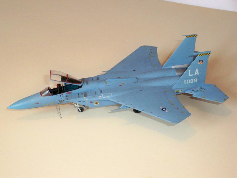

Enzo the Magnificent Posted June 7, 2020 Author Posted June 7, 2020 2 minutes ago, CT7567 said: The prototype and very early service F-15s wore the short-lived "air superiority blue" scheme before the Compass Ghost Grays became the standard. This was FS 15450 gloss over 35450, so essentially a monochromatic light blue (with a grayish tint). Like this? 7

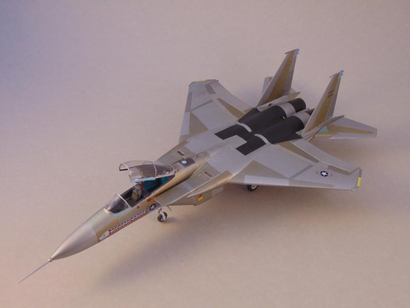

Enzo the Magnificent Posted June 7, 2020 Author Posted June 7, 2020 This one isn't quite so blue... 6
CT7567 Posted June 7, 2020 Posted June 7, 2020 1 minute ago, Enzo Matrix said: Like this? Nicely done! Which kit is that? I see it has the "full length" airbrake with the external rib. 2
CT7567 Posted June 7, 2020 Posted June 7, 2020 2 minutes ago, Enzo Matrix said: This one isn't quite so blue... No, but she did go "up, up the long delirious burning blue." Nicely done Streak Eagle. This one's on my long-term build plan. 1
Enzo the Magnificent Posted June 7, 2020 Author Posted June 7, 2020 1 minute ago, CT7567 said: Nicely done! Which kit is that? I see it has the "full length" airbrake with the external rib. It's the Academy 1/72 F-15C. The kit has the earlier jetpipes so an F-15A can be built. The external rib on the airbrake was simply a piece of plastic card filed to shape. 2
