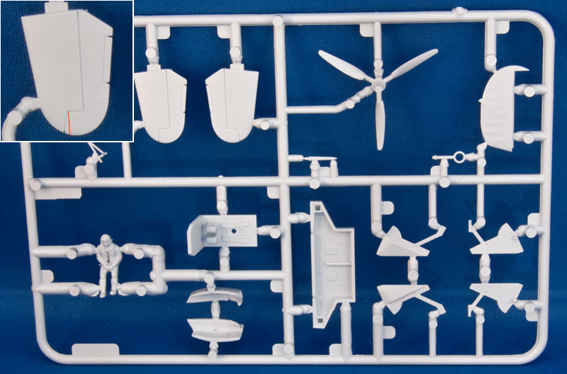

Work In Progress Posted July 5, 2014 Posted July 5, 2014 And the bizarre and inexplicable error in the shape of the elevator balances http://www.britmodeller.com/reviews/airfix/hurricaneiic72/sprue3.jpg
Nick Millman Posted July 5, 2014 Posted July 5, 2014 And the bizarre and inexplicable error in the shape of the elevator balances http://www.britmodeller.com/reviews/airfix/hurricaneiic72/sprue3.jpg Maybe not so inexplicable because the Hawker GA drawings I mentioned above have exactly the same shape! That was really my point - that the Airfix kit matches the drawing almost exactly, including the nose shape. Nick
Graham Boak Posted July 5, 2014 Posted July 5, 2014 Which underlines the message that manufacturer's GA drawings were not intended to provide a detailed accurate shape of the aircraft, and should not be taken as such. Their purpose is to give a good impression of the appearance of the aircraft; to provide a placing for relevant dimensions; and to be the top reference in a hierarchy of drawings that become more and more detailed as you proceed down the hierarchy until reaching those of production parts. They were usually drawn in advance of the detailed shape being decided, and were rarely updated to show other than gross changes. 1
Work In Progress Posted July 5, 2014 Posted July 5, 2014 (edited) Maybe not so inexplicable because the Hawker GA drawings I mentioned above have exactly the same shape! That was really my point - that the Airfix kit matches the drawing almost exactly, including the nose shape. Nick Explicable in those terms, yes, but it's so glaring that it's inexplicable if you assume that anyone involved in the kit had ever actually looked at a Hurricane. Mind you, the doghouse error on the Hawker GA drawings is also a blatant and obvious difference from the real aeroplane (prototype apart) and Revell completely missed that in their 1/32 kit. Edited July 5, 2014 by Work In Progress
