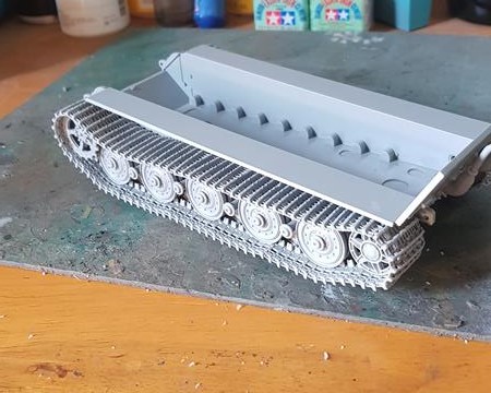

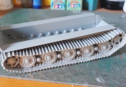

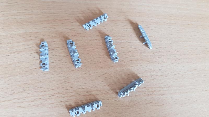

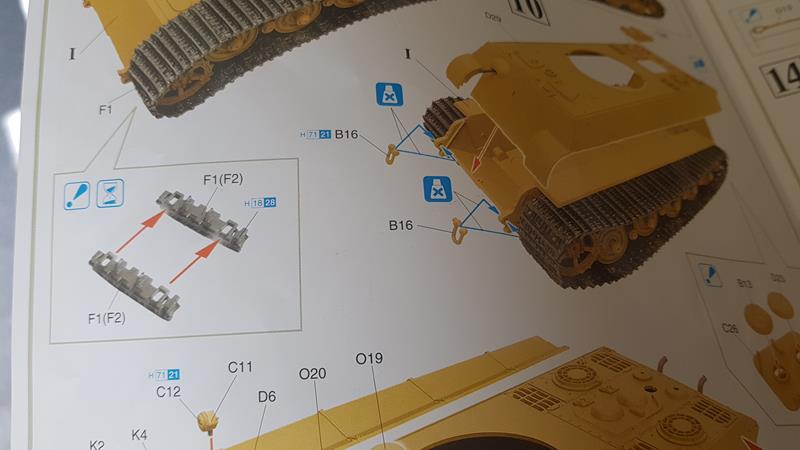

Rodders154 Posted August 16, 2018 Posted August 16, 2018 I have the Dragon King Tiger Late production kit and I am just about to give up on it. The problem is the tracks I cant see how I am going to build them! They dont stick togeather unless they are glued and they are no good to me I need to get some rubber track but where? the pictures below illustrate the problem As you can see there is nothing to hold the tracks togeather this is the instruction sheet I didnt realise they are handed as well and there is no indication of the numer to be glued in a straight line as that would help It says "new pattern tracks" I would settle for any workable tracks to finish the kit There are a lot of them any ideas welcome on how to get them to connect Many thanks Rodders
Ozzy Posted August 16, 2018 Posted August 16, 2018 I find using cello tape sticky side up helps, put a link on then add glue to another repeat the process until you have a good run. Leave to dry a little, then move into position. Leave the tape on until dry, take the tape away leaving the tracks in place. hope this helps Rodders. 5

Rodders154 Posted August 16, 2018 Author Posted August 16, 2018 20 minutes ago, Don149 said: Rodders , if you`re rubbish at these tracks , so am I ! . Early this year I scrapped a Bronco Comet because of the tracks , even bought the " workable " ones for it . They were little different to the kit tracks , I wont fall for that one again ! . Bring back the old one piece jobs , carefully painted / muddied there`s nothing wrong with them . Don . Thanks I thought it was just me. I will try ozzys idea but don't hold out much hope Rodders

rayprit Posted August 17, 2018 Posted August 17, 2018 Having built a fair few sets of tracks over the years I find the best approach is to set yourself a number your happy with...……….mine is 15...…...I glue groups of 15 together, then join them to the previous 15, and so the track progresses, when it comes to the idlers, or where the track goes around the sprockets, this is where my system changes, having served on tanks for a number of years I got the chance(or chore) to track bash or remove real links, knocking track pins out with sledge hammers...………..I find it impossible to make links appear naturally and sit properly as they go around idlers, my solution is to do away with gluing them one link at a time, so, I follow what the real thing does and also A/M track manufacturers, I individually drill out the track pin and replace it with an appropriate width of brass wire, it may sound hard work, but remember, there may only be 15 links going around(each) sprocket...………..looks a lot better. It plays havoc on the tips of your fingers and thumbs, but well worth the sacrifice...….I think I use a 5mm drill and drill from both ends, its dead easy when drilling to go off centre and the last couple of milimeter your drill appears well away from where the other end of the track pin should appear. White metal tracks your advised to ream out the holes in the track as their maybe clogged holes, so, why not do it with plastic tracks. I build my tracks placed against the edge of a steel rule, just to keep them straight...……..no tape, just number 1 eyeball and placing the tank ontop of the track - as the track grows, just to get an idea as to where the links start to lift off the ground to go around the idler... ……...when worn tracks(real ones) are returned to base workshops, they where joined together, about 6-7 links and rolled into a circular track with 2 track pins, one either side, allowing 2-3 men to pick up the links between them and load them onto a vehicle...…...that's possibly changed now and they now use a fork lift...……….. 3

Bigglesof266 Posted August 17, 2018 Posted August 17, 2018 For me, steel rule straight edge x2 and Tamiya Extra Thin brush-on liquid cement or equivalent are my friends when it comes to putting together any kind of hard plastic individual link track. rayprit offered some excellent "how to" suggestions in his post. Even so, temperament counts. They definitely fall into one of those love 'em or loath 'em prejudices in modelling. I love them (e.g. Dragon Magic Track), much preferred over continuous run, although I can appreciate the love for the latter when they are half-decent like Dragon's DS. But then I also don't mind tasks requiring repetition, time and persistance. e.g. learning to play guitar. Are you rubbish at modelling individual link tracks? I don't think so. You just don't enjoy it and get frustrated with them. And that's OK. I think that for most modellers, link and length are possibly the middle ground compromise. I don't mind those either, so long as they have sag moulded in the top horizontal runs if and where applicable. They are definitely becoming the default inclusion in most contemporary new mould kits where soft continuous run aren't. Even Dragon has abandoned individual link Magic Track inclusion now in favour of their flexible continuous run DS. Continuous run. Not a lover of. But I don't hate them either, so long as they are quality. Certainly the 'a lot quicker' option. Best of them I've use personally are Dragons DS. I haven't tried Tamiya's latest implementation of flexible continuous run, although coming from Tamiya in 2018, I would expect them to be light years ahead their predecessors and as good as Dragons DS? IME Trumpeter frequently include link and length and continuous run, although the latter in the couple of kits of theirs I have, KV-1 & KV-2, are still primitive 70's Tamiya/90's Zvezda style. 1
cocky05d Posted August 18, 2018 Posted August 18, 2018 Hi ,finishing the Zvezda King Tiger ,which is a re boxing of this Dragon kit ( i think ),i found if you file slightly the sticky out bits they are easier to fit together . I found that making groups of 4 and waiting until they are set ,and then making two long lengths ,one for the top and one for the bottom helps . Then you can concentrate on the lengths of tracks that go round the idler and drive wheels . 1
Rodders154 Posted August 19, 2018 Author Posted August 19, 2018 I DID IT I GOT THEM TO WORK Thanks to eveyone who suggested how to do it I have managed to get them to fit around the wheels I am so pleased they even fit togeather after a fashon. I will use plenty of mud to disguise my workmanship but once again Britmodeller chums came up trumps 6

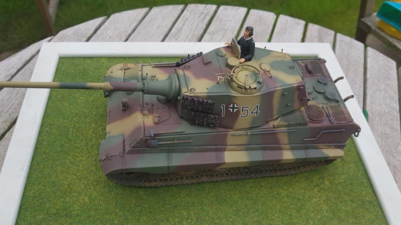

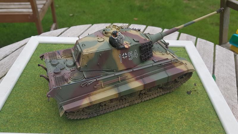

Rodders154 Posted August 23, 2018 Author Posted August 23, 2018 FINISHED!!! Got there in the end Thanks for everyones help Just some ariels to do and then i will call it a day Rodders 4
Dads203 Posted August 23, 2018 Posted August 23, 2018 Very nice work Rodders, that's turned out really well fella, congrats Dan 1
TallBlondJohn Posted August 24, 2018 Posted August 24, 2018 Proper job. Especially considering your vertical workbench which must be very space-saving. 1 1

Sandlapper Posted November 3, 2018 Posted November 3, 2018 On 8/24/2018 at 4:53 PM, TallBlondJohn said: Proper job. Especially considering your vertical workbench which must be very space-saving. You beat me to it! I was going to say the tracks also have great traction now!😆 1
