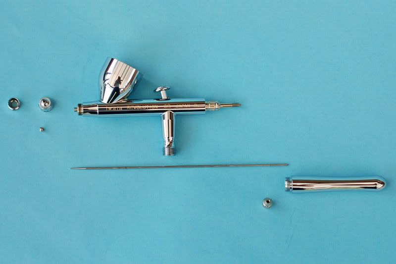

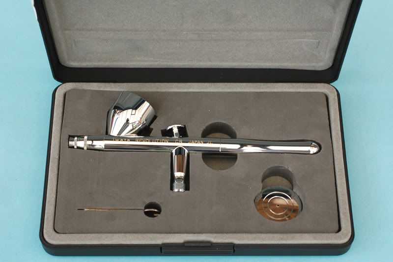

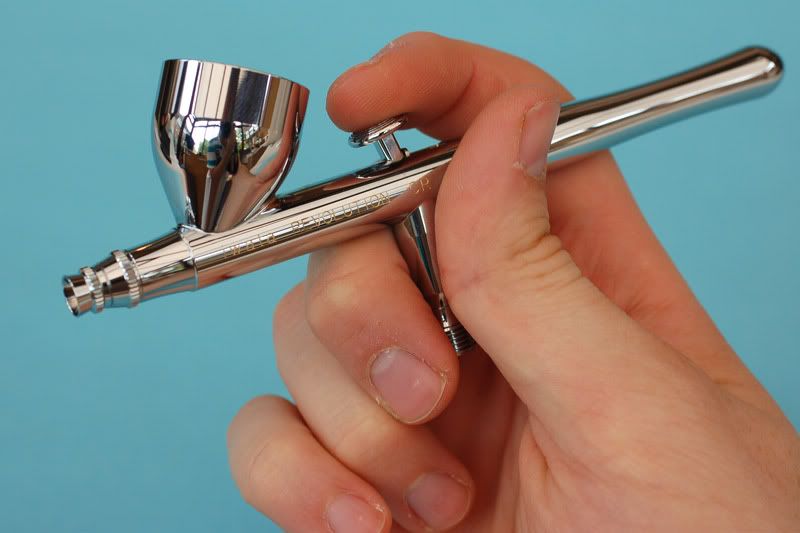

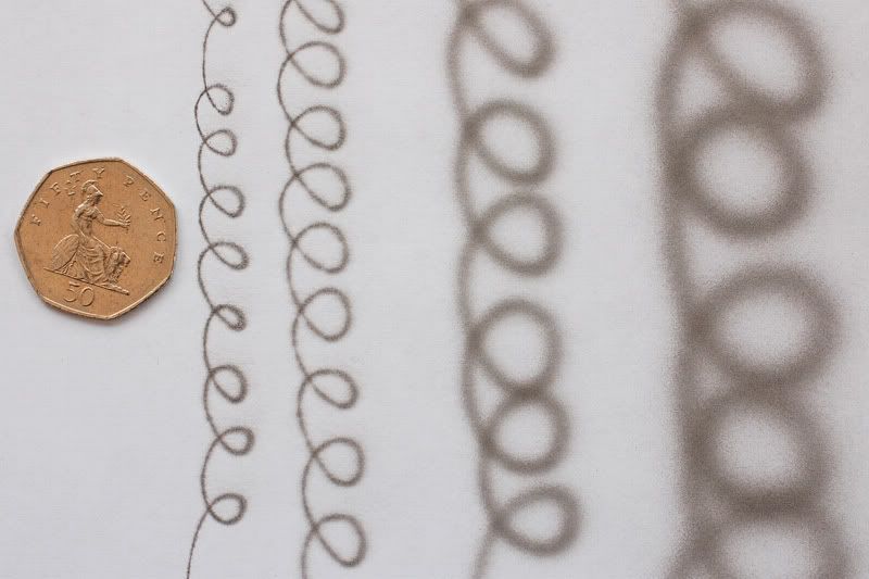

Paul A H Posted May 8, 2010 Posted May 8, 2010 (edited) An airbrush is a tool that, once acquired, quickly becomes indispensible. I know this to be true because my old Badger airbrush packed up a couple of weeks ago and life hasn’t been the same since. Models that I was looking forward to painting suddenly filled me with a sense of panic as I realised I could not finish them to my liking. There was nothing else for it; the Badger was gone and it wasn’t coming back. I had to bite the bullet and find a new partner in crime. I considered a new Badger (after all I still had the spare needles and tips) but, being on a budget owing to the unexpected nature of my airbrushlessness, I had to rule that out. I was tempted by the Premi-Air G35, but in the end I plumped for the basic model in the Iwata range – the Revolution. The Revolution series is marketed by Iwata as an ideal introduction to airbrushing whilst, they claim, still being suitable for users of all levels. I am by no means an airbrushing expert (not by a long chalk), but having been used to a decent dual-action gravity-feed airbrush, I was hoping that Iwata’s product would live up to the marketing. Happily I can report that it does. The Revolution arrives in a sturdy rubberised plastic case containing the airbrush itself, a lid for the paint cup and a small spanner for removing the paint nozzle/ All this is held in place by grey foam packing material. This particular model is the Revolution CR, which features a large 9ml paint cup and a 0.5mm paint nozzle fitted as standard. As you might expect from a company with Iwata’s reputation, the Revolution feels like a quality product. This chrome beauty feels reassuringly solid in the hand, which is not surprising given the all-metal construction. It also features a slightly contoured handle designed to make painting over long periods a slightly more comfortable experience for the user. The balance of the airbrush is nice and neutral too. The trigger has a smooth, positive action with the spring mechanism providing a nice amount of resistance, although it does feel a little stiffer than the Badger I’m used to. Being a dual action airbrush, the user can easily control both air and paint flow with one finger. The trigger features a fair amount of horizontal travel too, which translates into a lot of control over the flow of paint. With the trigger drawn fully back, this airbrush is capable of emptying its voluminous paint cup quite quickly. The 0.5mm nozzle is designed to make painting wider areas nice and easy, but care will be have to be taken to make sure the subject does not become saturated. Having said that, this airbrush is definitely no blunt instrument. With a little more restraint, very fine lines are possible. This is something I had always struggled to achieve with the Badger, even with a fine needle and head combination in place (although this may be a result of my own lack of skill). With the Iwata, I’m genuinely astonished at how easy it is to spray very fine lines. For particularly fine lines, the needle cap can be removed to allow the user to get the end of the brush even closer to the model. I had expected this to result in some splattering, but I needn’t have worried. Nevertheless, care will have to be taken to avoid bending the tip of the needle when the needle cap is removed. For even finer work, a 0.3mm nozzle and needle are available, thus adding to the versatility of the airbrush. The large paint cup is an advantage if you are spraying a lot of one colour in a session, but I can see how it might get on some users’ nerves. Personally, I’m used to a big paint cup. If you’re not, or if you prefer a smaller one, the Revolution BR, with its 1.8ml cup, might be more to your tastes. Cleaning the Revolution is a simple affair. A quick squirt of thinner or airbrush cleaner is enough to flush out most left-over paint from the cup. Backflushing is easily achieved by covering the needle cap with a cloth for a slightly more thorough clean. For deeper cleaning the airbrush will have to be stripped down and fortunately Iwata make this relatively painless. The needle cap and nozzle cap unscrew from the body of the airbrush by hand, exposing the needle and the nozzle itself. The nozzle is a tiny component and great care will be needed to avoid damaging it, particularly as it has to be removed by the supplied spanner. I’m willing to bet it’s very easy to lose too, so I might be investing in a spare in the near future. The rear of the airbrush can also be unscrewed by hand to reveal the needle chucking guide, spring, spring guide and needle chucking nut. Loosening the chucking nut allows the needle to be withdrawn completely for cleaning, replacing or lubricating. The airbrush comes supplied with a small sample tube of Iwata’s own lubricant (mine actually came with two) which they recommend you apply periodically to keep everything running nice and smoothly. Conclusion This lovely airbrush is a real pleasure to use. Its versatility and user friendliness will endear it to owners and with a little care, particularly with the nozzle, it should prove to be a durable tool. I ordered mine from an official Iwata dealer so it came with a 10 year guarantee, which provides real peace of mind in case anything does go wrong. The usual retail price is around £80, which in my opinion offers very good value for money. Airbrush supplied by SBX Models of Ipswich, courtesy of my poor credit card. Edited May 11, 2010 by Paul A H 2

thx6667 Posted May 12, 2010 Posted May 12, 2010 ..no idea what a Leopold is but the PremiAir G35 does a pretty good impression of the CR at around £35 for anyone just wanting to put a toe in the water..haven't picked up my Badgers since I got it. I like to think I could upgrade to the CR but I can't for the life of me see any difference between the two brushes...I guess its all in the 'feel' and the 'action' ..any experts care to comment ? I've got the G35, its good but seems to lack a consistency when it comes to spraying very fine lines.
denstore Posted May 12, 2010 Posted May 12, 2010 I've got the G35, its good but seems to lack a consistency when it comes to spraying very fine lines. If you are looking for fine lines, the HP-CR might not be the best choice. 0,5mm nozzle isn´t the ideal for thin lines. It´s an OK alround brush, but not a detailer.
