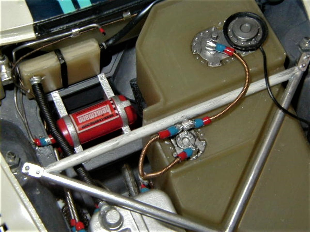

Pascal Posted July 19, 2021 Posted July 19, 2021 Very nice work ! For the tubing : I would use copper wire. A large diameter for the core and a small diameter that you wrap around the core. Secure both ends with a drop of CA glue. The tubing remains flexible, so you can bend it into any shape you want. Or you can go for this type of tubing. I would make that sort of tubing by wrapping very small strips of tape around a copper core. : Sincerely Pascal 1
silver911 Posted July 19, 2021 Posted July 19, 2021 May I suggest you look at page 12 on my 312T thread Andrew. If you scroll down near the bottom...you will see a very similar hose that I made...and a description of how I made it. The technique is simple...and once you have it shaped to your needs...it can then be painted yellow. Hope this helps Ron 1

silver911 Posted July 20, 2021 Posted July 20, 2021 11 minutes ago, Octavian said: Ron, Thanks for this; the tube you created is stunning. I will experiment with that and perhaps try the copper wire approach Pascal suggested too and see which one I am able to pull off more convincingly. I fear I might not be able to duplicate your results; I will try though. Your feedback is, as always, greatly appreciated. Best, Andrew Your very welcome Andrew Here is another option...(they have other sizes).....https://prime-miniatures.co.uk/content/course-simulated-conduit-19mm-brass-colour-45cm Ron 2

Codger Posted July 20, 2021 Posted July 20, 2021 (edited) DUH! Ron's link just reminded me that guitar strings (wound wire) are perfect match for his example and your needs! I have much of it in many various sizes, long forgotten! EDIT: Here it is on long-ago built 1/12 935: Edited July 20, 2021 by Codger 3

Sabrejet Posted July 23, 2021 Posted July 23, 2021 Ditto here about guitar spring: however I usually hand-wind thin copper wire around a suitably-sized drill bit to get a similar result. 1
