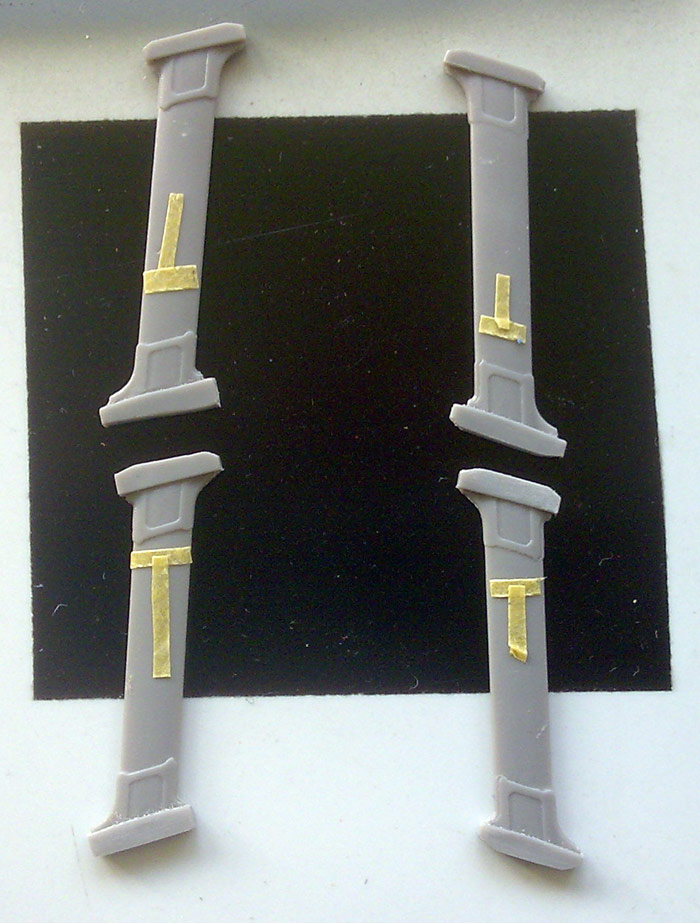

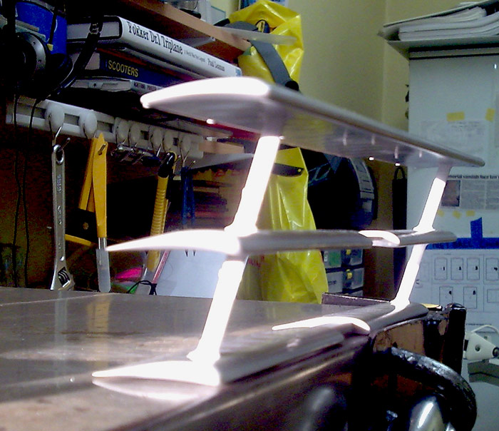

Bobs_Buckles Posted December 28, 2009 Author Posted December 28, 2009 A small update on the boring bits. The struts come as a one piece affair. I have found that cutting them in half and aligning each individually makes for an easier time of it. I'm all for an easy option Wings dry tested. That will do for now. Happy New Year! BVB

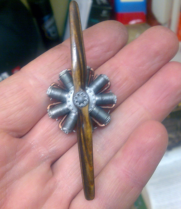

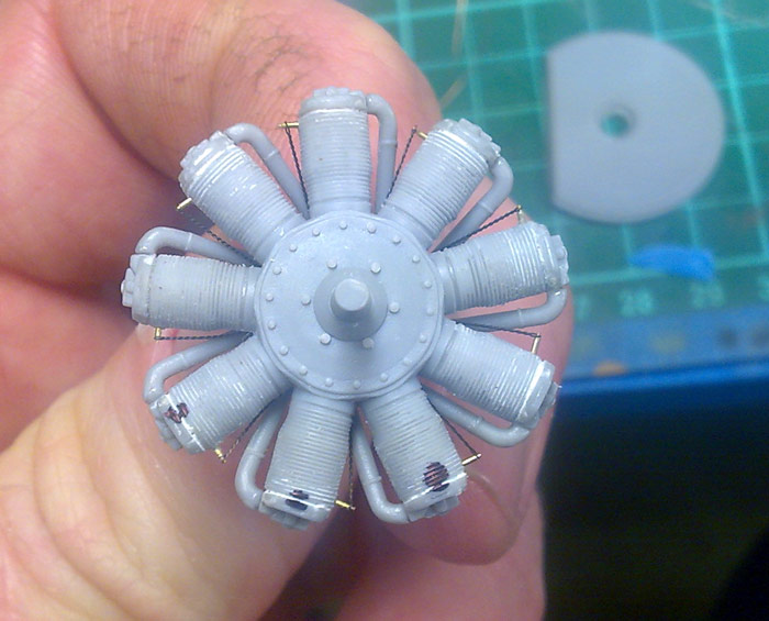

Bobs_Buckles Posted December 30, 2009 Author Posted December 30, 2009 Hello all, Engine needs final touch ups before paint. The original Spark plugs (plastic stubs) were lopped off and replaced with brass tubes. The outer tube being 0.4 with a 0.2 tube running through it. The wire ignition leads hang from the 0.2 ends. I did contemplate valve springs and rocker arms but knew I would become bogged down with AMS. This build is all about fun, lets hope it remains so. Thanks for your time. BVB

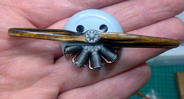

Bobs_Buckles Posted December 31, 2009 Author Posted December 31, 2009 Engine 90% finished. Just a few more washes followed by a wee amount of dry brushing will see the job done! The prop boss was cut from the plastic prop and grafted on the wooden wonder . Martin Digmeyer takes the credit for producing the prop. Happy new year! BVB
T-Tango Posted December 31, 2009 Posted December 31, 2009 Absolutely superb Bobsie me ol' mate, that prop looks the proverbal dogs dangly bits, waiting to see the rest of your build coming together. Poitiers Pete

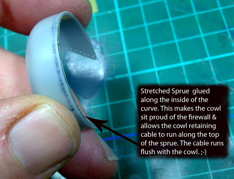

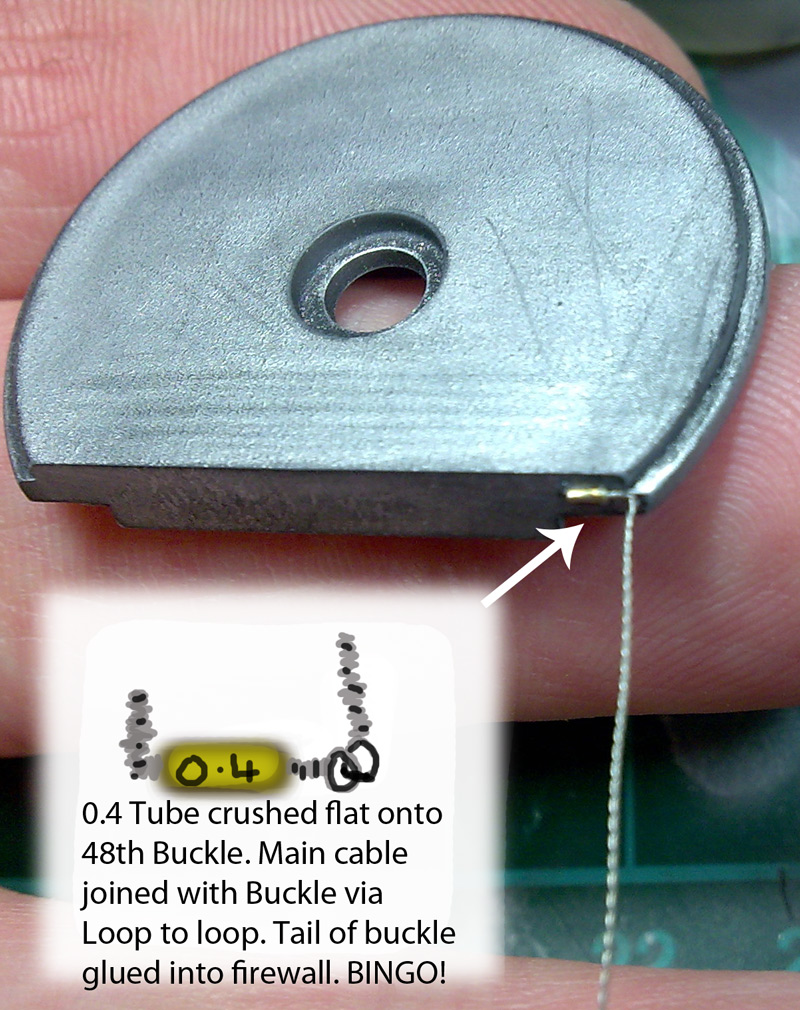

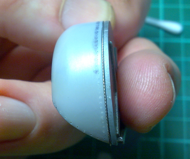

Bobs_Buckles Posted January 11, 2010 Author Posted January 11, 2010 Once again my friends I have descended into madness Cowl retaining cable: Please thumb through the glossy photos for an idea of what I'm trying to achieve. Please tell me there is a cure for this problem God bless, Bob

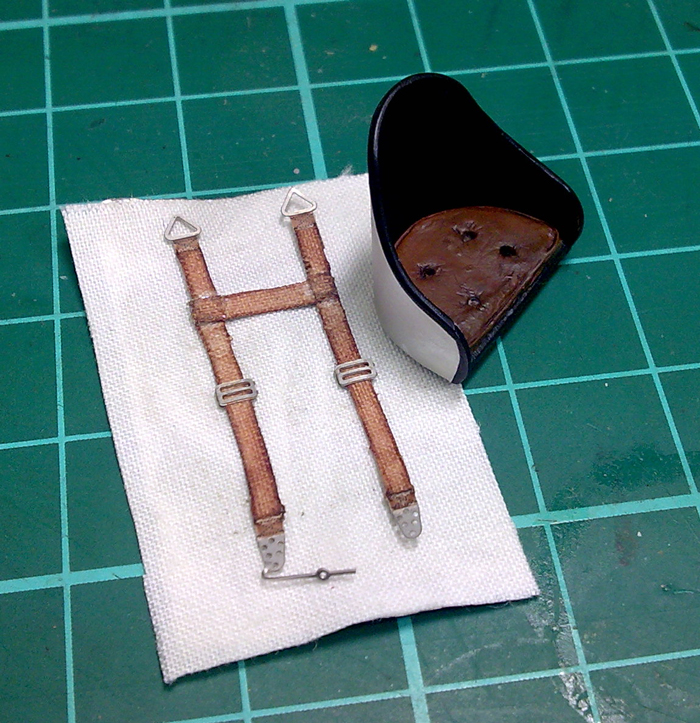

Bobs_Buckles Posted February 19, 2010 Author Posted February 19, 2010 Hello All, A wee wee update for you. I did say this will be a slooooow build ;D Seat: Bare metal foil back. Stretched sprue lip glued on the outside edge of the seat to represent overlap of seat covering . Cushion made from green stuff, painted with a mixture of Vallejo leather and Games workshop brown and finished with a games workshop wash. Harness. Using the Eduard harness as a template I cut 2mm wide lengths from fine cloth with a stencil cutter. Butchered the Eduard harness freeing all those lovely buckles. Glued buckles to my home made harness with Gator glue. Harness given a Games workshop Sepia wash to finish. Lap belts next! That will do you for now Bob Von Slowcoach

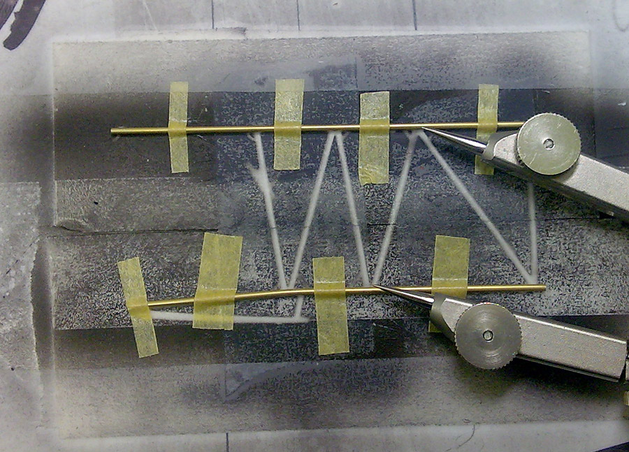

Bobs_Buckles Posted March 9, 2010 Author Posted March 9, 2010 I'm slowly knocking up the cockpit framing from brass tube. I placed the original kit parts on the sticky side of masking tape. Sprayed a thin coat of Games workshop Chaos Black over the frame, allowed to dry and pulled off the frame to reveal a nice crisp template for my brass tubing to follow. I'm unsure whether to solder or superglue the joints. Cheers, Sloooooooow Hand Bob
