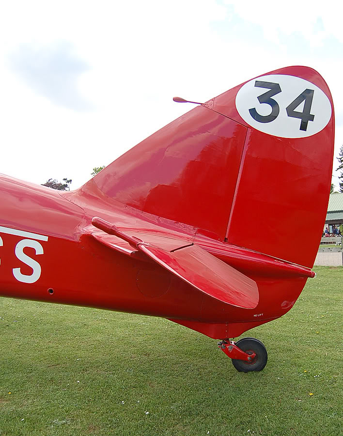

geedubelyer Posted October 16, 2014 Author Posted October 16, 2014 Thanks for the suggestion Christian. I wholly agree with you that the rib detail should be subtle, especially in this scale. If you have a peep at this photo from the Walkaround section here on BM you can make out the detail I was describing earlier. http://www.britmodeller.com/walkarounds/aircraft/dh88/88%2017.jpg In your experience, would the strips of decal work for this sort of effect? Cheers.

geedubelyer Posted October 17, 2014 Author Posted October 17, 2014 Excellent suggestions, thanks guys. I tried to cut thin strips of decal for the ribs but failed to get a clean edge. Plus, it was difficult to maintain a parallel cut. That does n't bode well for possible future applications, i.e. canopy framing. Time will tell. Thanks for the reminder on the Solartrim John. I think woody suggested it for the canopy framing on my build thread. There are a number of possible solutions that I need to try. At this juncture I have had a dabble with stretched sprue glued to the rudder. After seeing how that looked I think I'm tending towards heeding Christian's advice and leaving the surfaces devoid of detail in this scale. Comparisons with reference photos viewed at a scale distance make it almost impossible to see this ribbing. I'm very grateful to everyone for the ideas, thanks.
