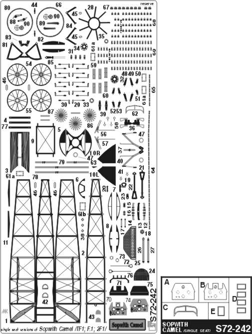

blimp Posted February 8, 2010 Posted February 8, 2010 . . . from the home of the totally insane http://www.part.pl/s72/s72242.jpg
ollieholmes Posted February 8, 2010 Posted February 8, 2010 I wonde how many times enlarged that photo is? Only they would produce a bomb bay for a 1:144 Lancaster.
