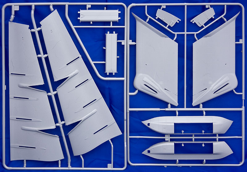

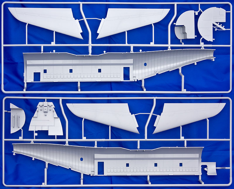

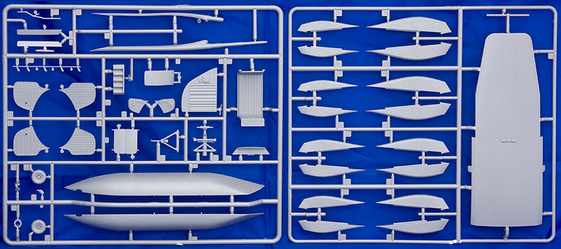

The plastic parts are exactly what you would expect from a modern Revell product; clean mouldings, nicely engraved panel lines and lots of detail. The fuselage is moulded in two large halves and the upper wing is moulded in a single huge span. This should avoid any issues of an awkward fit around the upper wing roots. There are two raised ribs on the inner surface of the upper wing, which should give the structure plenty of additional strength. The downside of this approach is that it has left a couple of long sink marks in the outer surface of the wing. There are also noticeable sink marks in the fuselage where the location points are, well, located. Whether this is due to insufficient injection pressure or just because the sheer size of the parts shows up the limitations of the injection moulding process, I’m not sure. Either way, a squidge of putty and a rub down should sort things out.

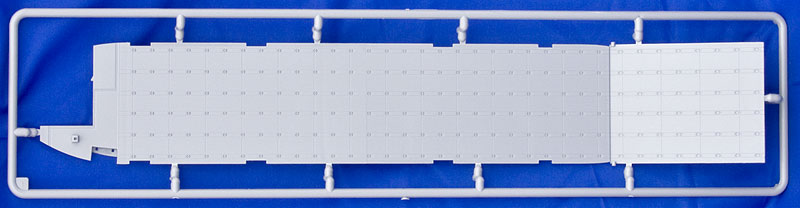

As mentioned above, Revell has included a full interior with this kit. Detail in and around the cockpit is excellent. The consoles and instrument panel feature fine, raised details, although decals are provided if you prefer to use them. The instrument panel itself features 9 LCD displays, whereas the real thing seems to have fewer than that, but this shouldn’t worry you as little will be seen of it once the fuselage halves have been closed up. Behind the cockpit bulkhead is a neat little staircase that leads down to the main load area. Rather than being moulded on the inside of the fuselage halves, the walls and floor of the detailed load area are made up of separate parts. This means that he fuselage of the model is actually double skinned as it is made up of inner and outer halves plus a floor. In turn, this means that Revell have been able to go to town with interior detail, and boy have they made the most of it. This approach also makes the model much stronger (and heavier).

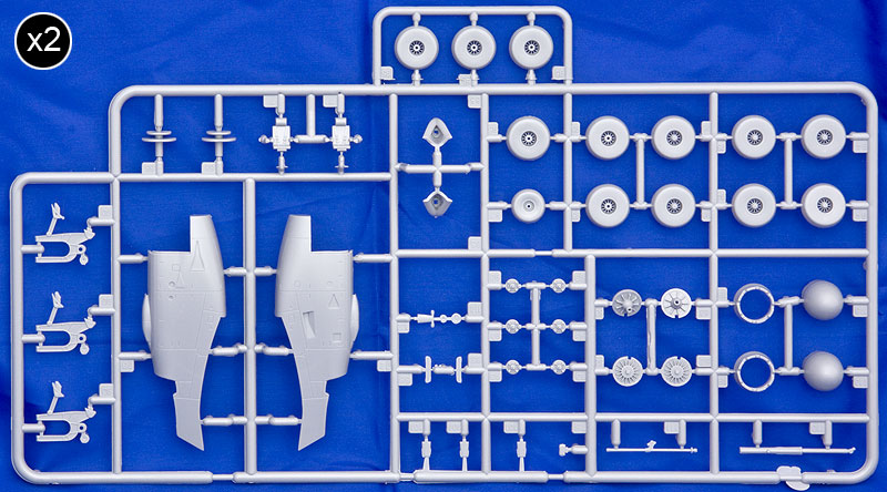

The landing gear on the A400M is housed in pods on either side of the fuselage. When assembling this part, I would recommend taking great care to make sure that all 12 main gear wheels are flat on the ground at the same time, as any flaws here will show up a treat. The undercarriage is complex and will probably require a fair bit of patience to assemble and paint. The wheel hubs look noticeably too smaller than they should be, which in turn makes the tyres look too fat. Hopefully this won’t be too noticeable on the finished model though.

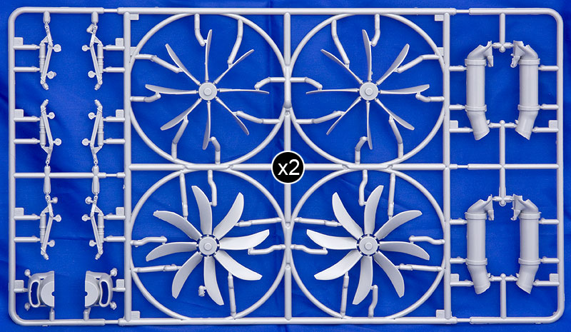

The engines are nicely detailed and, unusually for a turboprop, full-length intakes and exhausts are provided, as well as turbine faces. 2 sets of huge 8 bladed airscrews are provided, so you can finished your model with fully-forward or feathered props.

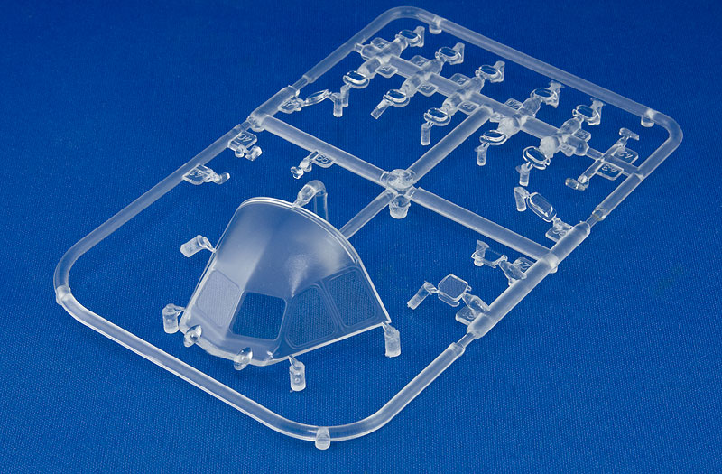

The single clear sprue is nicely moulded and the windows are thin and transparent. The corners of the windscreen are rounded, which could be tricky to mask, but I understand that Eduard will shorlty be releasing a set of paint masks for this kit. Hopfully they will include masks for all those tyres too!
