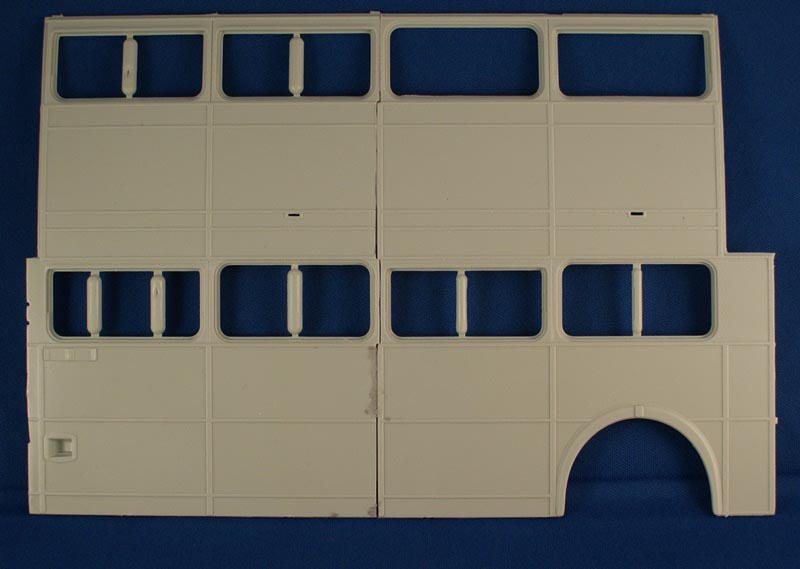

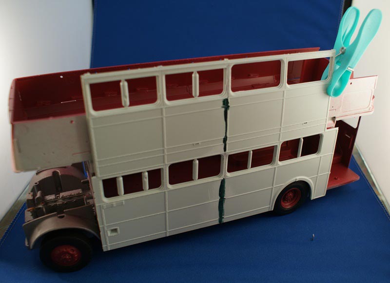

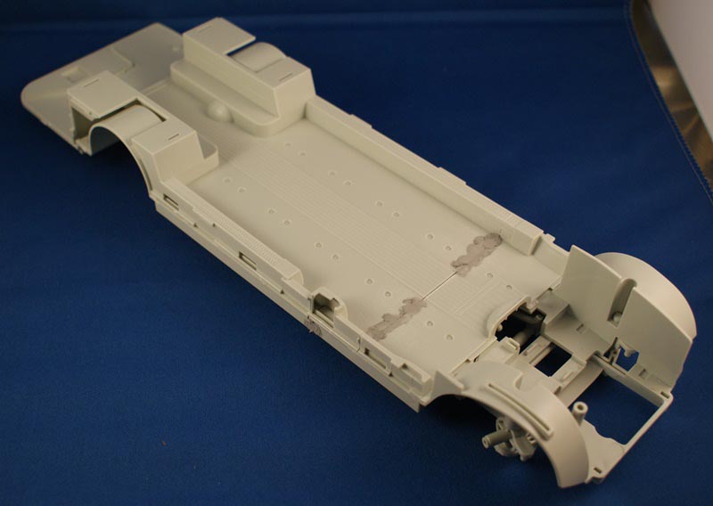

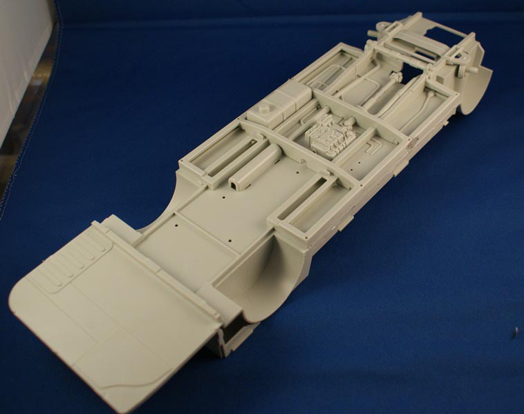

richellis Posted December 29, 2011 Posted December 29, 2011 Hi, First out of the blocks is my RM conversion of the Revell kit. The real RM is 2"6' shorter than an RM, this is the small section in the middle of the bus (square windows) you need to chop out this section, about 27mm and how I did the cuts isnt straight! I followed the panel lines! This is the first side done, and it needs filling and sanding. I then moved on to the chassis, again 27mm needs removing and over the 3 parts (Interior floor, chassis, and front subframe) I staggered the cuts for strength, You can see how I staggered the cuts in the pics. I also shortened the prop shaft and exhaust pipe as these need adding before the subframe part! Does any one know if I can fit the engine at the end of the build?

Selwyn Posted December 29, 2011 Posted December 29, 2011 Hi,First out of the blocks is my RM conversion of the Revell kit. The real RM is 2"6' shorter than an RM, this is the small section in the middle of the bus (square windows) you need to chop out this section, about 27mm and how I did the cuts isnt straight! I followed the panel lines! This is the first side done, and it needs filling and sanding. I then moved on to the chassis, again 27mm needs removing and over the 3 parts (Interior floor, chassis, and front subframe) I staggered the cuts for strength, You can see how I staggered the cuts in the pics. I also shortened the prop shaft and exhaust pipe as these need adding before the subframe part! Does any one know if I can fit the engine at the end of the build? Rich, be careful how you cut the other side, so the fuel filler ends up in the right place! Selwyn

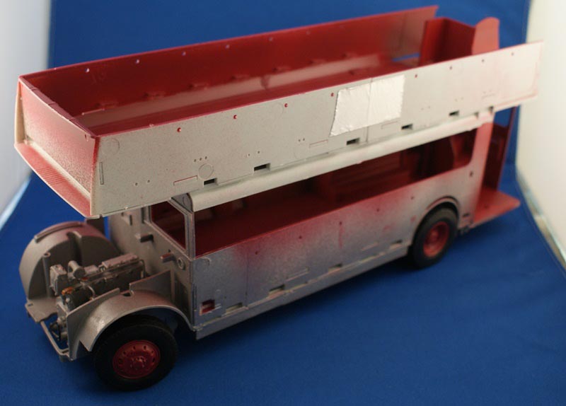

richellis Posted January 6, 2012 Author Posted January 6, 2012 OK, picture update, done alot, the chassis is done painted, the sides are cut and joined and the top deck is done. I have painted the dark red on the inside, and Ill mask and paint the Brown floors. When that is done Ill do the stair treads in Grey and add some details. I need to sort some period ads for the inside, any ideas....
