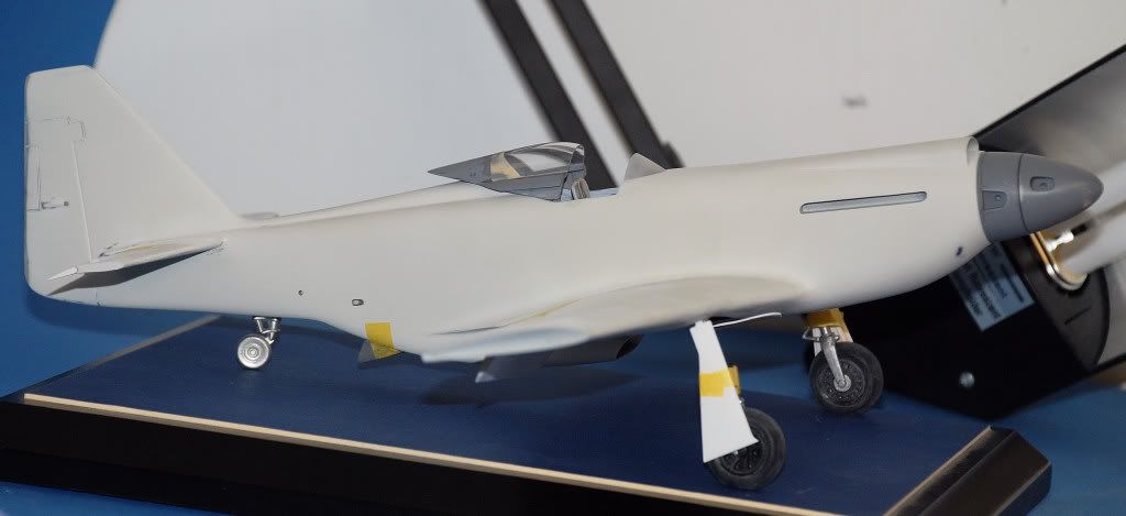

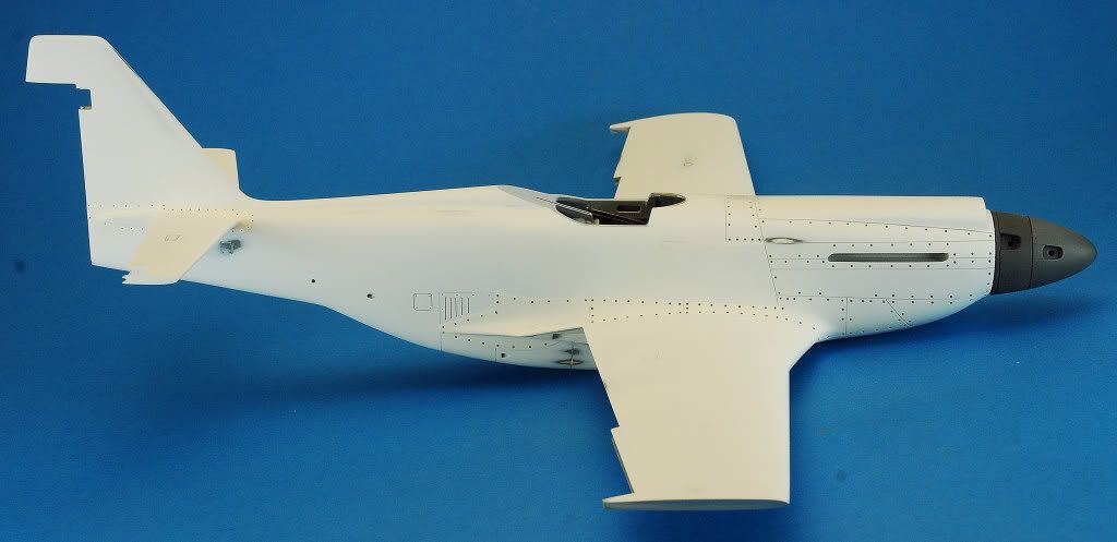

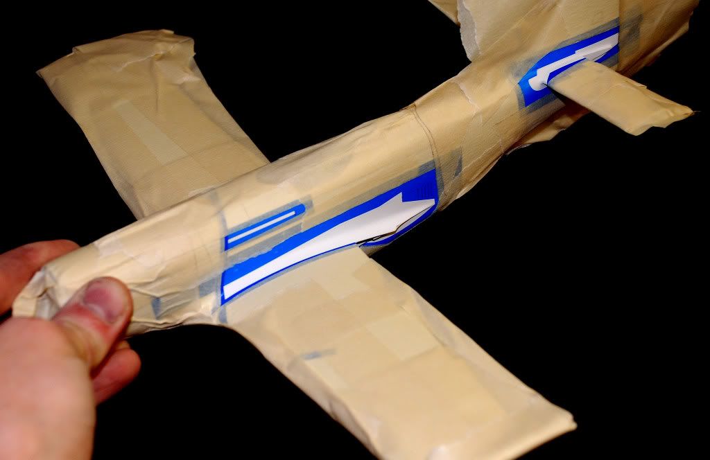

turnerdad Posted October 3, 2009 Author Share Posted October 3, 2009 Quick update, model is now ready for painting, will spray the white tomorrow. Anyway, a quick fit together ages ago as I remade the canopy. I wasn't happy with the shape, now much better. I will also be fixing the main gear doors shut as the aircraft was often parked like that, especially when on show, and plus it helps to maintain the sleek lines of the plane. I wanted to add the raised wing/tailplane roots areas, and there also seems to be a strengthening plate (or something) running up to the rear of the engine bulkhead, as everything infront was new. I had some vinyl masks cut and applied them to the relevant areas, before spraying 12 or so light coats of Halfords white primer. When removed it left a very nice raised area that needed a light rub down to smooth out. I then added all the fastener detail, drilled out very shallow with a .71mm drill bit. The Baron was covered in very prominent silver fasteners that stood out against the red fuselage, and I'm having a load of .5mm photoetched steel discs made (should get them next week from PPD Photoetchers in Lochgilphead, Scotland-they are very good). Hopefully, if all goes well I'll add them after all the gloss coats, washes etc. A risk but I've been practising on some test pieces and the results were lovely, albeit with punch and die plastic discs. All the other bits are ready for whiting, good weather forecast tomorrow and plenty of time to work, can't wait. Cheers all. Link to comment Share on other sites More sharing options...

Seamus Posted October 3, 2009 Share Posted October 3, 2009 It's looking epic chap, top drawer stuff as ever Will you be bringing her to Telford if she's finished in time? Link to comment Share on other sites More sharing options...
turnerdad Posted October 3, 2009 Author Share Posted October 3, 2009 Will you be bringing her to Telford if she's finished in time? Thanks Sean. Yes, my plan is to have her ready for Telford, albeit a year late! One advantage of a nice clean gloss finish is painting should be fairly straightforward, no extensive weathering processes. Link to comment Share on other sites More sharing options...
