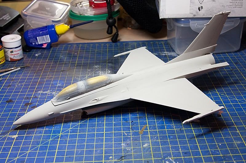

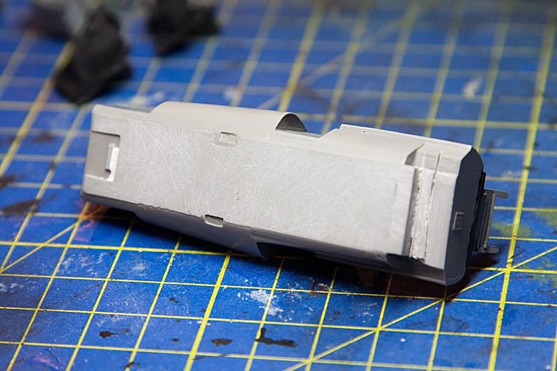

Peter W Posted April 14, 2012 Author Posted April 14, 2012 Mike, the Aires cockpit has been my job for the day and it's not that bad. The fiddliest bit is notching around the front instrument coaming but if you take your time and fettle away carefully and check regularly it goes ok. The rear end of the cockpit needs thinning to paper thin and a chunk cutting out to miss the internal intake moulding on the kit, but again not too bad. I'll take a picture of the resin part on its own next post so you can see what I mean. Here is one of it in place for starters: - More soon Pete

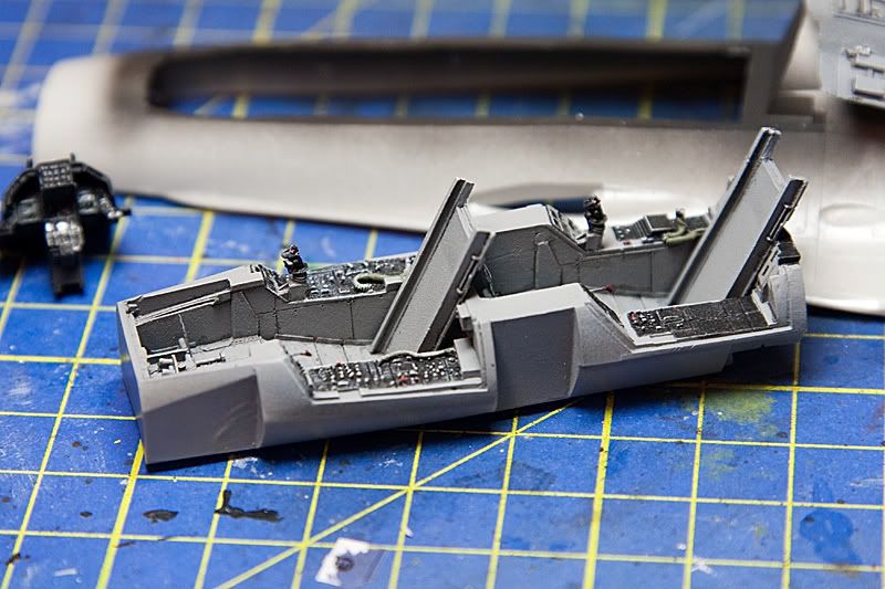

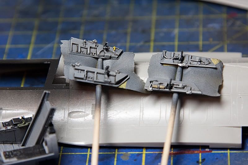

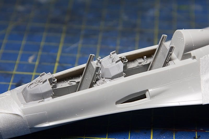

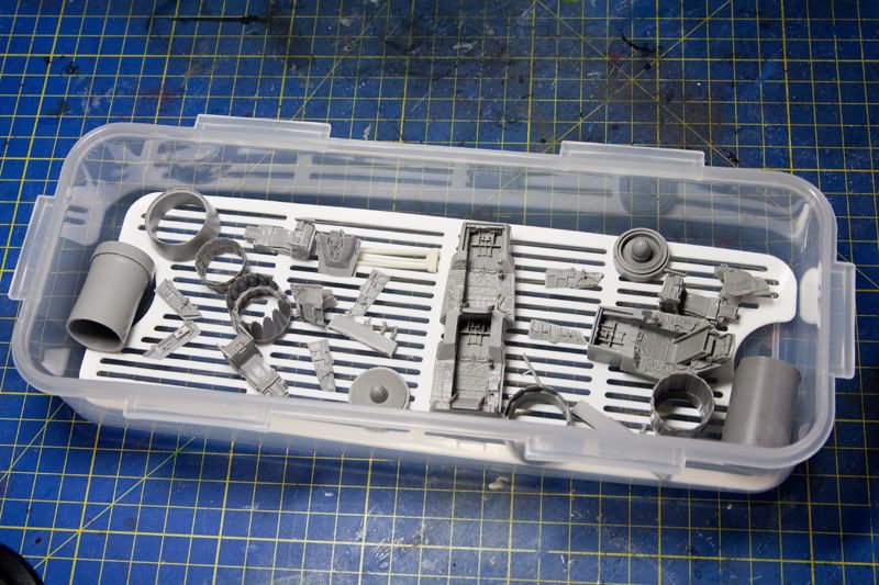

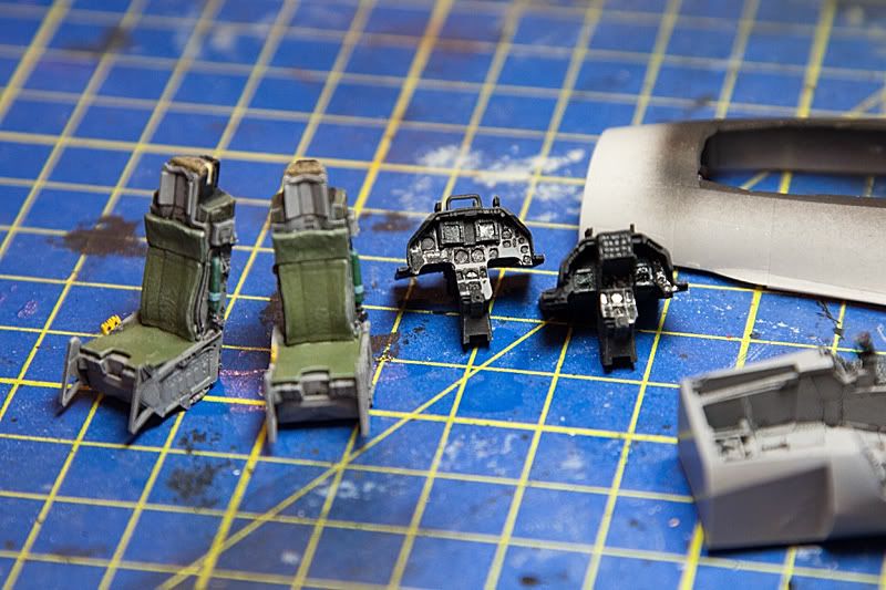

Peter W Posted May 7, 2012 Author Posted May 7, 2012 A little bit more done on this one and although slow, progress is being made. I've got the cockpit almost ready to glue in place and just the ejector seats to finish up. First picture is the resin all ready for a wash (both my F-16 builds bits in the tub): - Next, a few pictures of the cockpit as it stands: - And one dry fitted in place: - And finally one for Mike. Sorry it took so long but this is how much the bottom needs thinning and the cut-out at the back to clear the kit plastic: - Lots more to do but I'm nearly through the slowest part of all my builds. More soon Pete
Mike N Posted May 7, 2012 Posted May 7, 2012 Nice work there Pete, and cheers for the photo! Coming along nicely Mike

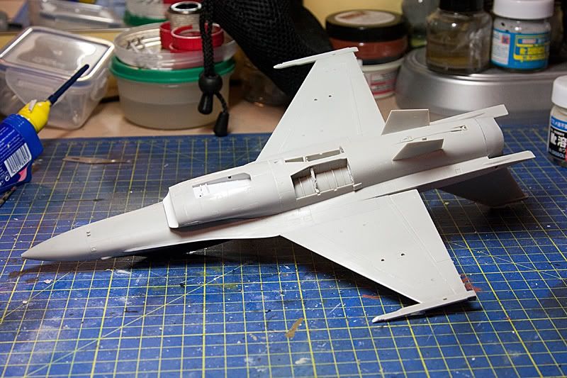

Peter W Posted June 5, 2012 Author Posted June 5, 2012 I can't believe that it's been a month since I posted anything on this one, where has it gone? Things have been progressing though, although obviously slowly even though it doesn't feel like it has. I have got everything glued that needs to be before paint can be applied. The seams took a bit of work to get right but all looks good now and I'm onto the colour adding phase. A minor hiccup was put right after I realised that I had painted both horizontal tails the same way up, not good but all correct now, I hope. More soon Pete

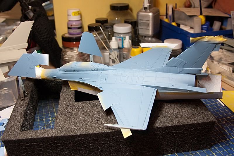

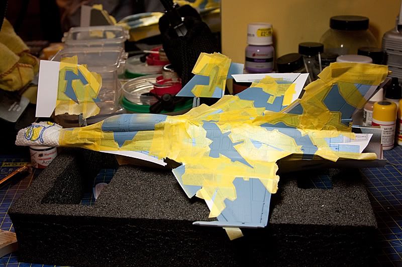

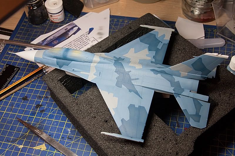

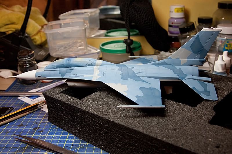

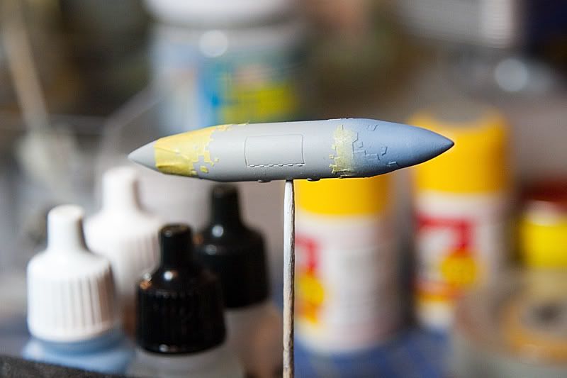

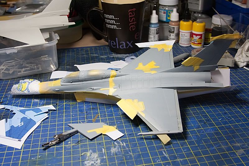

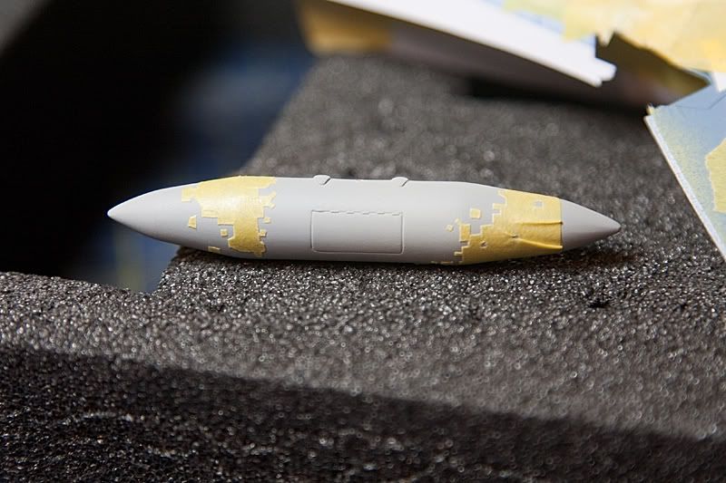

Peter W Posted June 8, 2012 Author Posted June 8, 2012 (edited) Mike - Good luck with the A cockpit but when are you going to get around to releasing the F-22 correction bits for the Academy? I have money burning a hole in my pocket waiting to place an order. I've done a bit more work on this one. Several hours of masking took place before I could get the next colour on. I had to mix an acrylic version of the darker blue FS35109 because nobody makes it, not that I could find anyway. A combination of Vallejo Dark Blue, Light Turquoise, Intermediate Blue and Black gave me something that I like and can live with. I also did a bit of masking on the baggage pod which was headache inducing but it's getting there. First a shot of the immense masking job: - And the pod: - And finally a few of the paint job so far. I've got all the basic colours on and a lightened mix of each for panel fading. I'm quiet pleased as there's only one touch up required where a bit crept under the mask near the tail: - Oh and nearly forgot the pod so far, one colour on and more masking to do: - The next step is to remask the wing tips and spray the pylons as well as the nose RWR's? and then the wheel bays. I'm getting there. More soon Pete Edited June 8, 2012 by Peter W
AndyC Posted June 8, 2012 Posted June 8, 2012 That's a really great scheme Peter and very well executed too! Brave man!
Mike V Posted June 9, 2012 Posted June 9, 2012 Mike - Good luck with the A cockpit but when are you going to get around to releasing the F-22 correction bits for the Academy? I have money burning a hole in my pocket waiting to place an order.I've done a bit more work on this one. Several hours of masking took place before I could get the next colour on. I had to mix an acrylic version of the darker blue FS35109 because nobody makes it, not that I could find anyway. A combination of Vallejo Dark Blue, Light Turquoise, Intermediate Blue and Black gave me something that I like and can live with. I also did a bit of masking on the baggage pod which was headache inducing but it's getting there. And finally a few of the paint job so far. I've got all the basic colours on and a lightened mix of each for panel fading. I'm quiet pleased as there's only one touch up required where a bit crept under the mask near the tail: - The next step is to remask the wing tips and spray the pylons as well as the nose RWR's? and then the wheel bays. I'm getting there. More soon Pete Impressive mask/paint work; bravo The F-22 stuff should be out by next month, though in limited quantities. We're negotiating an export to Japan. Coupled with the IPMS Nationals this August, most of our product line will be limited for the next few months. We'll also be discontinuing a few items from our initial line up to make way for new products. The Tamiya F-16A Conversion is proving to be a major undertaking, though is well worth the results. More to come. Looking forward to seeing this one completed. Mike V

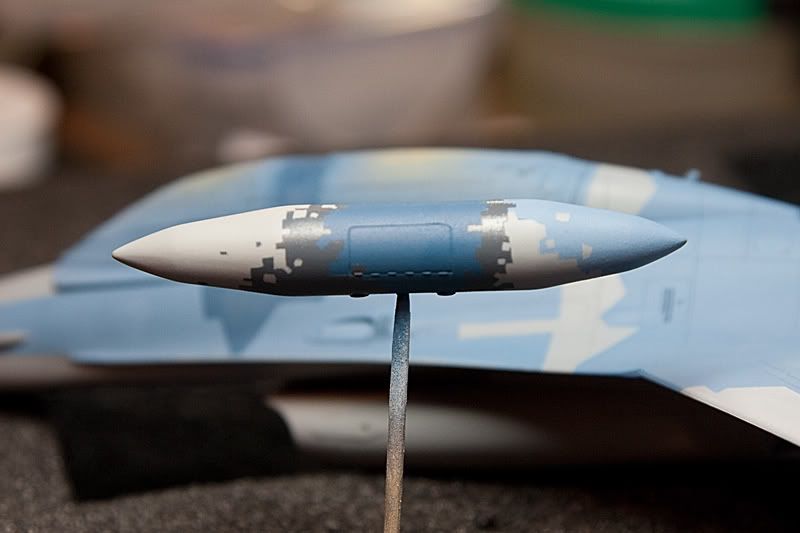

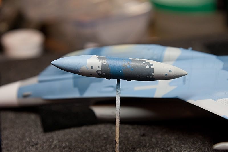

Peter W Posted June 9, 2012 Author Posted June 9, 2012 Thanks guys. Small update today. I managed to get the touch ups and odd bits painted today and I think that it's nearly ready for a gloss coat. I also spent a bit of time getting the baggage pod sprayed, masked up and sprayed again and this is in the glossing pile too. Just a couple of pics of the baggage pod for now. It's not exactly accurate but gives an impression of what it's like: - Tomorrow should see some progress on the white bits, sidewinders and Tacts pod. I feel like I'm finally getting somewhere on this one now. Back soon Pete
Parabat Posted June 9, 2012 Posted June 9, 2012 Epic! Lovely work on the masking, I love the way you achieved the Digicam, superb!

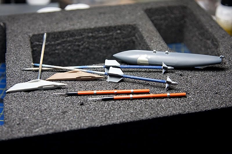

Peter W Posted June 10, 2012 Author Posted June 10, 2012 (edited) Thanks Parabat, it was a fun little masking job, that's for sure. I have to say that it was made easier with the Optivisor that my wife got me for my birthday. I usually do these fiddly things through the magnifying part of a set of helping hands but I'm forever knocking them onto the model which isn't good when it's painted. I used the optivisor for the first time to do this and it's great. As said elsewhere, you do look daft with them on but what a great addition to my modelling tools. Todays little update is the TACTS pods, CATM AIM-9, drop tank with flaking paint and weapons pylons. I painted the pylons in different colours just to add a bit of variety on the finished build, as if the paint scheme doesn't give you enough. I doubled up on the TACTS pod and AIM-9 as I need a set for my other build, the F-16N It's rare for me to have all of these fiddly bits done this early but I'm glad to have them ready. I've a bit more to do on the drop tank but it's taking shape. More soon Pete Edited June 11, 2012 by Peter W
Calum Posted June 10, 2012 Posted June 10, 2012 Nice work on the masking there. But kust for interest I think there is a masking set for this scheme now http://www.luckymodel.com/scale.aspx?item_no=JW-PPA5012
Peter W Posted June 11, 2012 Author Posted June 11, 2012 Nice work on the masking there. But kust for interest I think there is a masking set for this scheme now http://www.luckymodel.com/scale.aspx?item_no=JW-PPA5012 Calum, masks are for lightweight modellers, where's the fun in having it all done for you Seriously they do look good though and I wish that I'd seen them before I started. Too late now though, there's no looking back on this one. Pete
Calum Posted June 12, 2012 Posted June 12, 2012 Calum, masks are for lightweight modellers, where's the fun in having it all done for you Seriously they do look good though and I wish that I'd seen them before I started. Too late now though, there's no looking back on this one.Pete Call me a light weight then But you're doing a terrific job on a challenging scheme
Mike N Posted June 13, 2012 Posted June 13, 2012 Just seen the progress on this Pete - brilliant paint job!! Nice work on the stores too. Can't wait to see it all come together Mike
