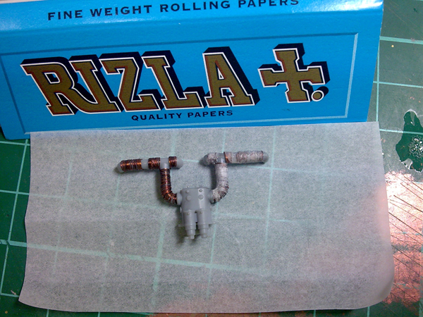

Bobs_Buckles Posted June 2, 2010 Author Posted June 2, 2010 This update is to share info. I got to thinking (it doesn't happen much so take notice ) about the material I was going to use as asbestos wrap for my manifold. For some reason a light bulb flashed in my pea sized brain and out popped cigarette papers - the fine type of cigarette paper for rolling your own. Set your stencil cutter to 1mm and cut loads of ribbons. Make up a nice brew of elmers, PVA, Gator or anything gooey glue and add a wee drop of water to thin. Apply goo to where the ribbon wrap begins. Get wrapping! When you run out of ribbon apply goo... and so on. The effect is subtlety personified. Must dash! Light bulb is flashing!!! Here is one I fiddled around with earlier BB P.S Due to buckle sales going through the roof I will not be able finish my Alb DVa before the GB ends. Sorry all
