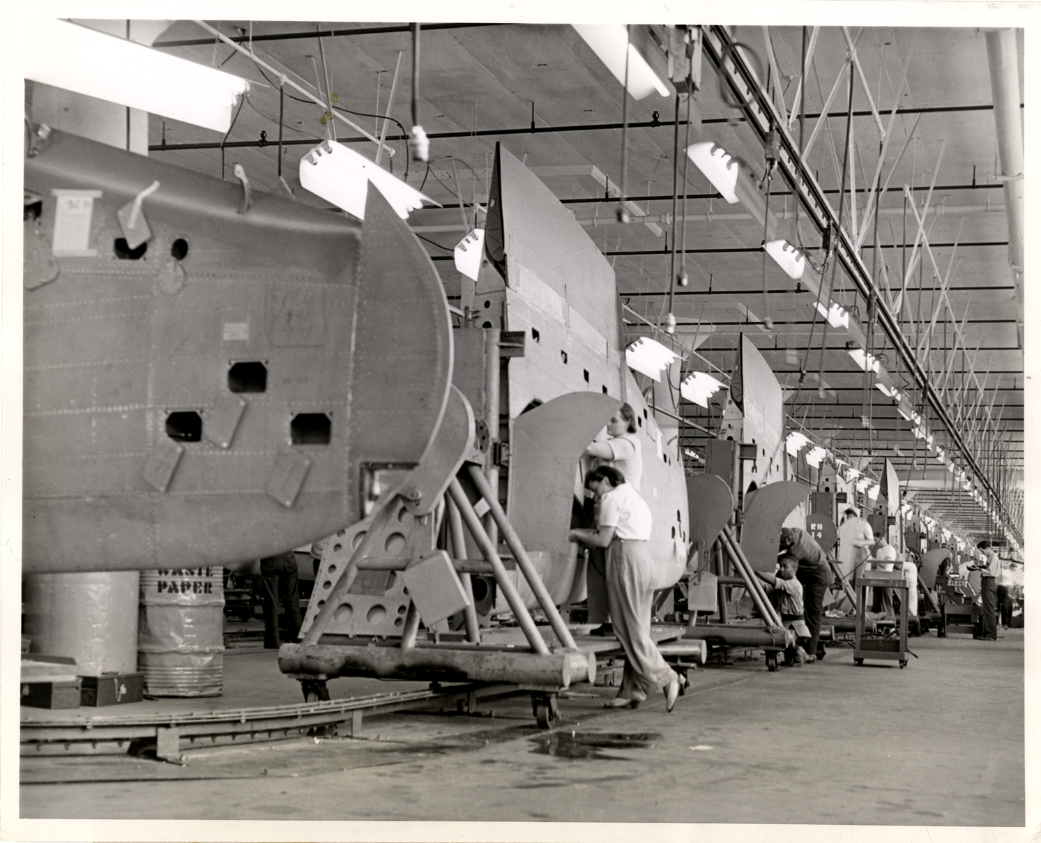

greatgonzo Posted August 31, 2021 Posted August 31, 2021 (edited) When I wrote -there's a lot 'seems' and opinions- I meant my post only and I was trying to sound apologising. 4 hours ago, Tbolt said: Reference the wings being painted without the ailerons and flaps, what info do you have on that? I could rewrite the next paragraph of Your post word for ward answering this question. Just having ideas from pic You've posted and alike. Yet, this picture of Yours alone clearly defines the process. In my opinion :). Of course You are right mentioning the priming being less used later on. Then it came back a little when reports from the front arrived mentioning increasing corrosion problems. I am talking general here, not pointing specific P-47 instructions. As I said, with later, not camouflaged P-47s I would go for elements primed and over sprayed with silver paint or just anodised. For Lend Lease birds I would circle back to the beginning with ZC primer and camouflage colour on top. But these wouldn't even be opinions. More like guesses I'd say. Edited August 31, 2021 by greatgonzo 1
Tbolt Posted August 31, 2021 Posted August 31, 2021 54 minutes ago, greatgonzo said: When I wrote -there's a lot 'seems' and opinions- I meant my post only and I was trying to sound apologising. I could rewrite the next paragraph of Your post word for ward answering this question. Just having ideas from pic You've posted and alike. Yet, this picture of Yours alone clearly defines the process. In my opinion :). Of course You are right mentioning the priming being less used later on. Then it came back a little when reports from the front arrived mentioning increasing corrosion problems. I am talking general here, not pointing specific P-47 instructions. As I said, with later, not camouflaged P-47s I would go for elements primed and over sprayed with silver paint or just anodised. For Lend Lease birds I would circle back to the beginning with ZC primer and camouflage colour on top. But these wouldn't even be opinions. More like guesses I'd say. Okay, sorry I didn’t get that at first. Like I said that picture looks like painted flaps fitted on unpainted wings to me, but without some more pictures we will never know what they actually did.
greatgonzo Posted August 31, 2021 Posted August 31, 2021 Ah, here we are, I didn't get that! You mean we have NMF wings with painted flaps fitted in the picture? I would say the wings are painted. And it doesn't make sense to me fitting painted flaps, then removing them to paint the wings and fitting them again. I don't know for sure, of course, but what could have been gained by such a strange procedure? Now, I made a trick I usually perform when in doubt. I looked at at the picture forgetting my first impression and and trying to see the opposite idea. 9 of 10 times in these occasions I am able to see it, this opposite one. No surprise I did see it this time too... . 1
Tbolt Posted September 1, 2021 Posted September 1, 2021 21 hours ago, greatgonzo said: Ah, here we are, I didn't get that! You mean we have NMF wings with painted flaps fitted in the picture? I would say the wings are painted. And it doesn't make sense to me fitting painted flaps, then removing them to paint the wings and fitting them again. I don't know for sure, of course, but what could have been gained by such a strange procedure? Now, I made a trick I usually perform when in doubt. I looked at at the picture forgetting my first impression and and trying to see the opposite idea. 9 of 10 times in these occasions I am able to see it, this opposite one. No surprise I did see it this time too... . You might want to have another look then 😉 To me the wings are unpainted because you can see the rivets, look just forward of the flap and the gear door, you can see the rivet heads. You can't see any on the flap. So yes I believe the flap is painted, though it could just be ZC primer, though it looks darker than that, but we don't know what film/filters were used. Also with the wing on the left you can see the river head except where the aileron area has been painted. Like I said if the flaps are already painted then I would have thought they would leave them in place when they painted the wings, why remove them? You could argue that the skin were primed before assembly, but I didn't think that was done back then on military aircraft, but even if it was the flap and aileron area being darker would then be NG.
greatgonzo Posted September 2, 2021 Posted September 2, 2021 As said, I can see both versions and I could argue for both. Which clearly shows I know sh... . 2
