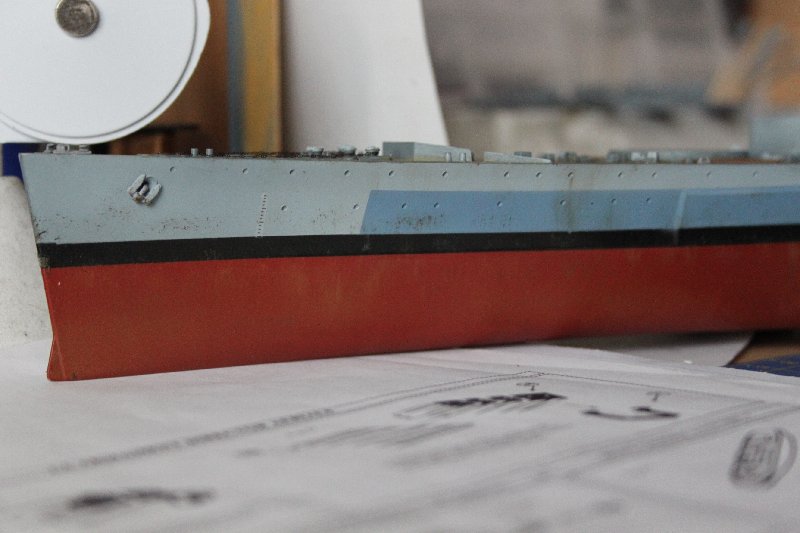

Ruttman Posted August 1, 2020 Posted August 1, 2020 Hi all I’m almost done with my first ship build, the Tamiya 1:350 HMS King George V. It’s been a brilliant build so far, but due to my relative inexperience In the World of ship modelling I’m not really sure how to go on from here in terms of weathering and finishing the model. Could anyone give me any tips as to how to continue from here? Cheers Luke Rutter 3
beefy66 Posted August 1, 2020 Posted August 1, 2020 Hi Luke I see you have started on some weathering of the hull sides are you using oils for this and if so then I would recommend you try and thin it out a bit more with turpentine or white spirit try and use more than one colour to give a contrast to the hull colours i use various ones white yellow and blacks to give a very fine filter to the streaking effect i also use a sponge to apply some of the oils as a form of chipping I did this with my KGV. Your build is looking go BTW beefy 4
Ruttman Posted August 1, 2020 Author Posted August 1, 2020 18 minutes ago, beefy66 said: Hi Luke I see you have started on some weathering of the hull sides are you using oils for this and if so then I would recommend you try and thin it out a bit more with turpentine or white spirit try and use more than one colour to give a contrast to the hull colours i use various ones white yellow and blacks to give a very fine filter to the streaking effect i also use a sponge to apply some of the oils as a form of chipping I did this with my KGV. Your build is looking go BTW beefy Thanks for the idea, I’ll have a go at it later. your KGV looks brilliant too. Thanks Luke Rutter 1
Chewbacca Posted August 2, 2020 Posted August 2, 2020 Luke, I think the key phrase I would use for weathering ships is "less is more", certainly in this scale. It's very easy to overdo it. Look at contemporary photos to see where the rust is likely to be - hawse pipes are classic but bases of vertical structures as well often have a little rust where water has been able to build up and if the paint has cracked this can allow the water through to the steel. 1
Ruttman Posted August 2, 2020 Author Posted August 2, 2020 1 hour ago, Chewbacca said: Luke, I think the key phrase I would use for weathering ships is "less is more", certainly in this scale. It's very easy to overdo it. Look at contemporary photos to see where the rust is likely to be - hawse pipes are classic but bases of vertical structures as well often have a little rust where water has been able to build up and if the paint has cracked this can allow the water through to the steel. Ok thanks, I’ll certainly bear that in mind
magpie1832 Posted August 2, 2020 Posted August 2, 2020 Looks great. The KGV the scheme you have done is painted over light grey, the paint will have worn and chipped on the blue and dark grey so you could create some chipped areas with a fine brush and and light grey. I tried to replicate on mine. My KGV Chris
Ruttman Posted August 2, 2020 Author Posted August 2, 2020 18 minutes ago, magpie1832 said: Looks great. The KGV the scheme you have done is painted over light grey, the paint will have worn and chipped on the blue and dark grey so you could create some chipped areas with a fine brush and and light grey. I tried to replicate on mine. My KGV Chris Thanks Chris I’ll have a go at that at some point soon. thanks for the advise your KGV looks brilliant thanks Luke Rutter
