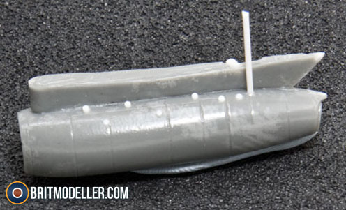

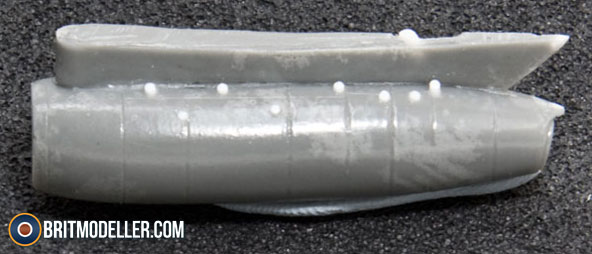

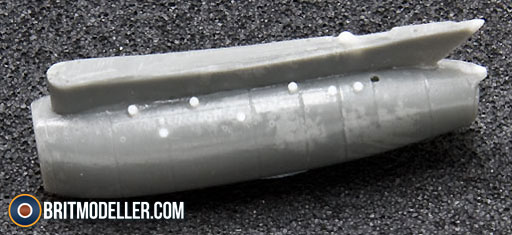

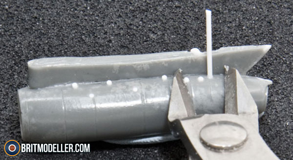

Mike Posted January 11, 2010 Posted January 11, 2010 I've just been removing some resin bubbles in a couple of cast up engines from Bra.z models, and thought I'd share my technique with you. Firstly, just quickly assess the size of the bubbles, and chuck a suitably sized drill bit into your pin vice. In this case, 0.75mm was suitable, so I drilled out the major bubbles. Taking a piece of styrene rod of the same 0.75mm diameter, dip the end in CA (superglue), and insert it into the hole, making sure it bottoms out. Give it a few seconds to cure, then chop it off close with your side-cutters. This leaves you with a lot of little white stumps standing slightly proud from the surrounds. When you're done filling, simply cut off any remaining stumps or CA residue with a sharp #11 blade in your scalpel. A quick buff with a sanding stick, and you're done. Certainly beats trying to choke them with filler
