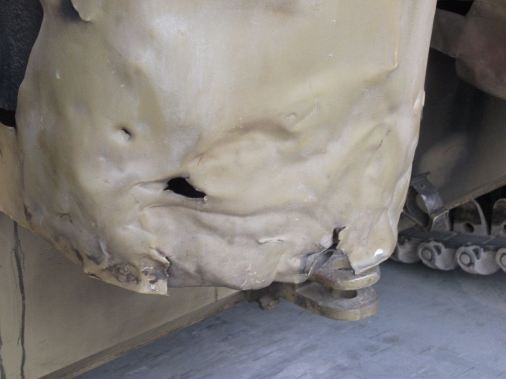

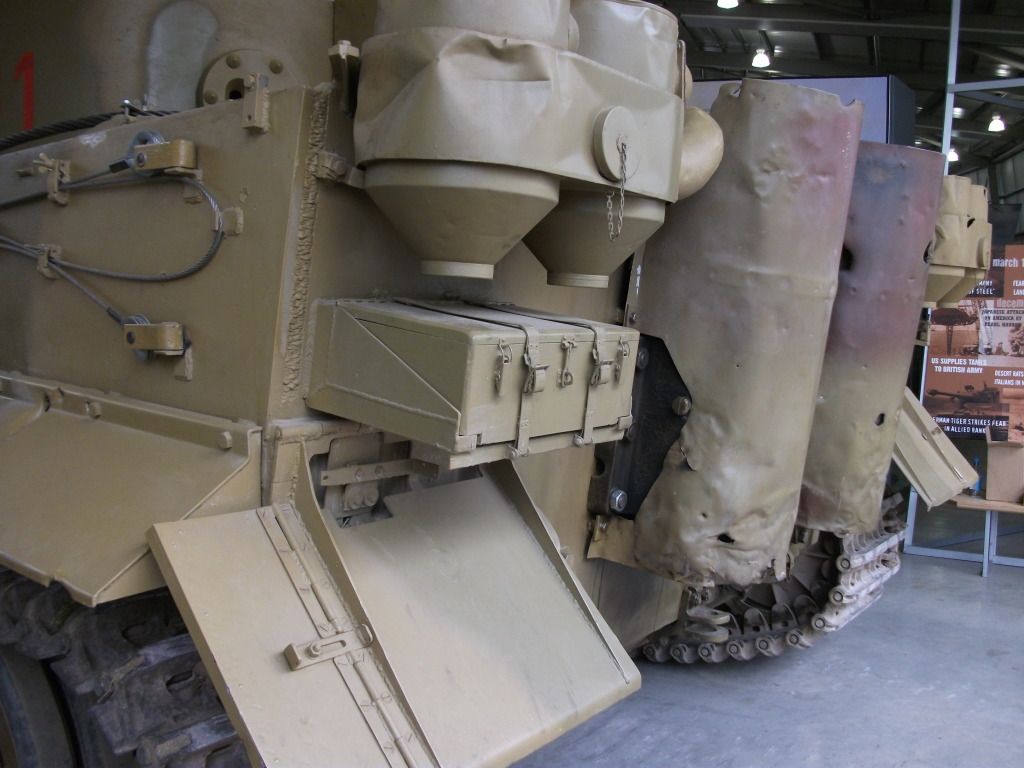

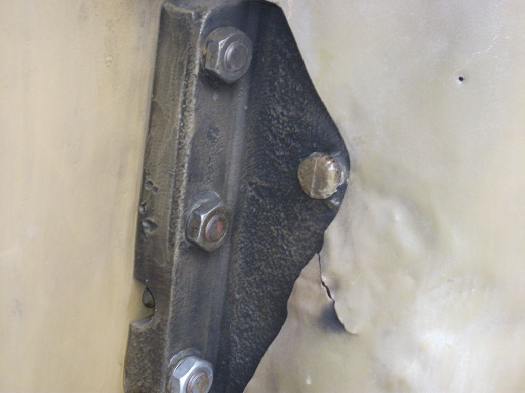

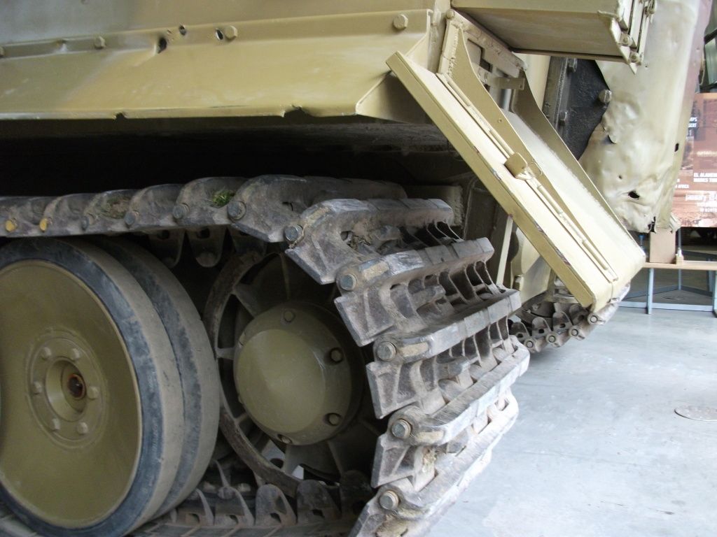

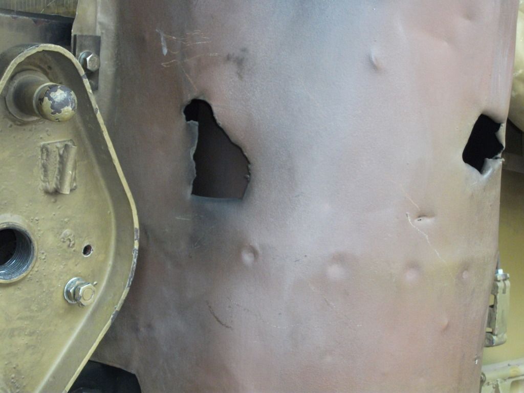

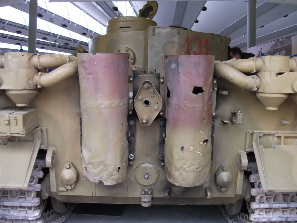

Tiger Ausf.E Posted June 26, 2012 Share Posted June 26, 2012 Hi Fingers, I put these up elsewhere on the site, but you may have missed them. These pictures show the actual exausts of a Tiger that is up and running. You can see how the paint and metal is being affected by the heat. I hope you find these helpful. Link to comment Share on other sites More sharing options...
