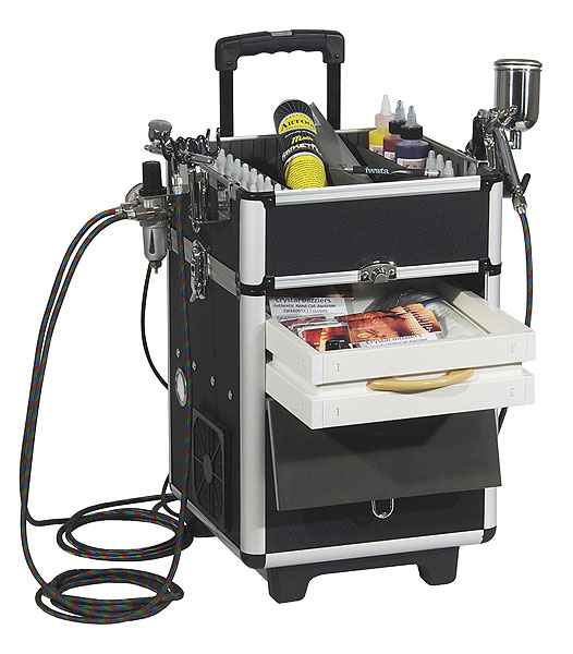

We've been sent details of this beast by our friends at Airbrushes.com and we just had to show you guys this top of the line portable airbrush workstand. if you're a modeller with limited space to work in, or you often spend weeks or months away from your normal workbench, you'll wish you had one of these so you can get on with your models. I won't bore you by drivelling on too long, but if you fancy one of these beasts, you need a healthy wallet, as it'll set you back £600, but if you have deep pockets and a wanderlust, this could be for you!

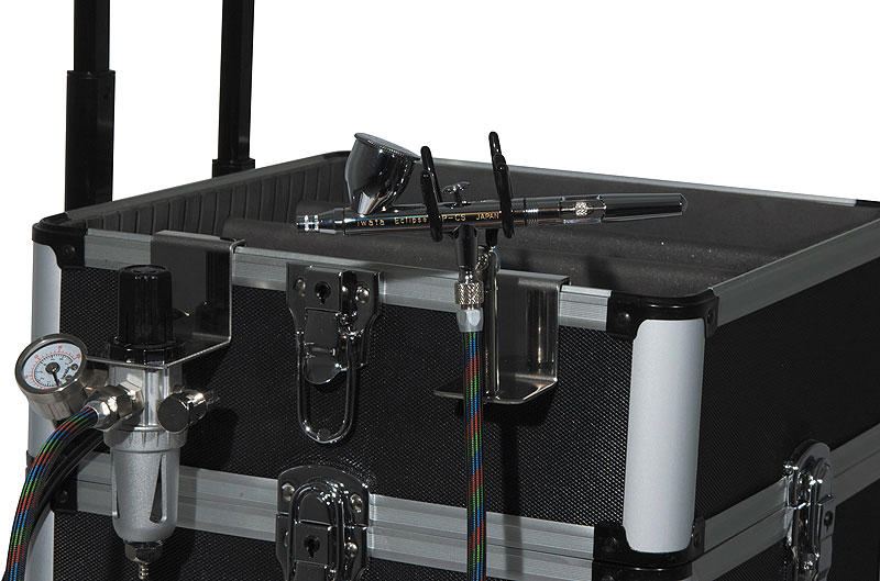

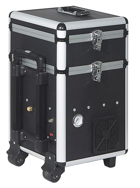

Iwata Studio Series compressors are powerful, compact and quiet. With oil-less piston motors, they are low maintenance and affordably priced. The Iwata Studio Series are the perfect companion to any of the Iwata airbrushes.
The Maxx Jet compressor can run up to four Iwata airbrushes or similar airbrushes at the same time or a low-volume spray gun. Housed in a portable and sturdy case with a 2.5 litre air tank and storage galore for all your airbrushes, paints and accessories, the Maxx Jet really allows you to take your art on the road.
The Maxx Jet compressor features:
  • Low maintenance, oil-less twin piston air compressor
  • Quiet running 1/4 HP induction motor
  • 2.5 litre air tank
  • Air flow at 0 psi: 1.4 CFM (40 lpm)
  • Working pressure from 0 psi to 60 psi.
  • Smart Technology automatic switching reduces running time and motor wear (40 psi on / 60 psi off)
  • Strong protective travel case with retractable handle
  • Back wheels for portability, front legs for stability
  • Detachable top with handle opens a tray for your accessories
  • Removable front draw
  • Latches for top access and motor access
  • Internal cooling fan
  • Moisture filter
  • Regulator Pressure gauge
  • Tank pressure gauge
  • Air regulator for precise air pressure adjustment
  • Comes with two 3 metre (10') braided hoses
  • 2 x 1/4 BSP outlet manifold on regulator
  • Convenient airbrush, spray gun and regulator holders
  • Detachable power cord
  • On/off switch
  • Size: H 32 x W 32 x H 57 cm (approx including handle and fittings)
  • Weight: 14.2 kg
