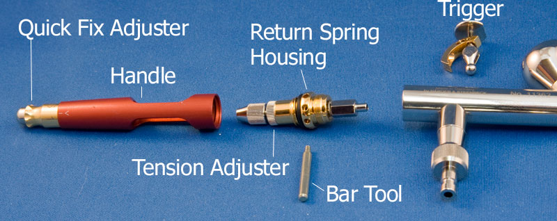

The trigger is of the traditional top mounted variety, actuating the air by downward pressure of your index finger, and drawing the needle back by moving the tip of your finger towards the rear of the brush. The needle is returned to closed by the pressure of a spring inside the body, the tension of which can be altered by turning a knurled set-screw on the inner of the rear of the brush, which is made accessible by two cut-outs on the sides that allow you to adjust return tension and loosen the needle without disassembly.

Between the chrome and terracotta front and rear assemblies is an attractively gold plated perforated ring, which is the visible part of the tension adjustment housing, with the holes acting as receptacle for the provided bar to unscrew this element. A rubber seal prevents over-tightening of the anodised rear of the brush, which unscrews in the usual manner for disassembly.
At the absolute rear of the airbrush is the Quick Fix button, which allows you to set the maximum travel of the needle, enabling you to select the same width and density of spray pattern again and again by turning the gold anodised set-screw and depressing the chrome button. With that dialled in, you cannot over-open the paint nozzle until you un-set it by pulling backwards on the gold set-screw. It's an ingenious device, and incredibly useful if you're doing consistent fine lines like a squiggle pattern, or mottle on the sides of a WWII German aircraft or fighting vehicle.
Disassembly is a breeze, and soon becomes second nature. The whole process involves only the supplied metal bar unless you want to remove the rear needle seal, which will require either a small screw driver, or for extra precision the H&S removal tool, which also holds the Teflon seal in place.

My disassembly and cleaning routine is as follows:
  • Remove the handle of the airbrush
  • Twist and remove the air and paint nozzles and set aside for cleaning
  • Loosen the needle and remove from the front, ensuring no paint is drawn into the rear of the brush
  • Remove the trigger - this just lifts out when the needle is removed
  • Unscrew the trigger tension mechanism using the supplied bar, being careful not to ping the internals and spring off into the distance
