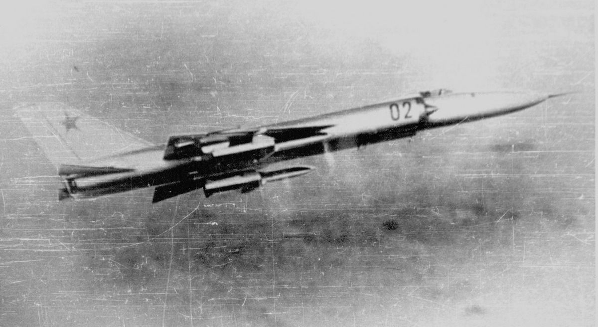

pyro-manic Posted January 16, 2013 Posted January 16, 2013 (edited) Some British contemporary designs carried their heavy missiles on pylons that projected well forward of the wings, so it's plausible at least. There are some photos HERE that show the missiles carried underneath the wings, though they may well be test dummies as they're painted oddly. EDIT: A better picture here: http://www.secretprojects.co.uk/forum/index.php/topic,933.msg7400.html Again, the missiles are dummies, painted in that odd quartered black/white pattern. Edited January 16, 2013 by pyro-manic
John R Posted January 17, 2013 Author Posted January 17, 2013 EDIT: A better picture here: http://www.secretpro...33.msg7400.html This link worked but there were no pictures - only a few comments The first link had some drawings that matched those in 'Soviet Heavy Interceptors' which appear to show the pylons much firther forward on the wing.Maybe they were moved at some stage in the development program. 04 didn't have radar and I believe only caried missiles for test purposes. John
pyro-manic Posted January 17, 2013 Posted January 17, 2013 Ah, you have to be logged in to see pictures. It's worth signing up - it's a goldmine of information. Here's the pic re-uploaded for you:
trimmer Posted January 17, 2013 Posted January 17, 2013 John, K-15 missile ("275" project) has never went beyond ground testing, few pictures with b&w checkered missiles on "Anakonda" shows flight test dummies. So I assume that it's up to you how to paint a "live" rocket, unfortunately it will be "what if" anyway. My personal preference is red band on warhead The mounting set-up you may see from the link below. It's a mock-up, but made by Lavochkin design buro. The missile has 3-point connection to the wing. http://www.missiles.ru/_foto/250A-275A/275a.jpg Dmitry
John R Posted January 17, 2013 Author Posted January 17, 2013 (edited) Thank you both for the quick replies and invaluable information. The problem now is where were the other two mounting points? I'm quite happy with the black and white as my interest is prototypes and experimentals Regards John Edited January 17, 2013 by John R
trimmer Posted January 17, 2013 Posted January 17, 2013 John, if you checked the linked picture, other two points are visible: it's on a small sub-pilons (one is on wing leading edge, second is on the wing) attached to the rocket's wings
John R Posted January 17, 2013 Author Posted January 17, 2013 I wondered if that might be the case but the photo didn't have enough detail to be sure. Thank you John

John R Posted January 17, 2013 Author Posted January 17, 2013 Thanks Pin. I should have started this topic earlier as I have just finished it. However they could be a great help to someone else. Dimitry - Ihave just mounted the missiles where your picture shows them and the missile fins line up nicely with the strange excrecences on the underside of the wings. I wondered what they were for. John
trimmer Posted January 17, 2013 Posted January 17, 2013 "Strange excrecences" - it's exactly what I mentioned as "sub-pilons". Actually, those are small rails for rollers on tips of missile's wings. The most right picture in last row of Pin's wonderfull photo collection shows all three connection points in perspective. If you jump into links, provided by Pin, you find a nice close-up photo of those "rails/pilons" Dmitry

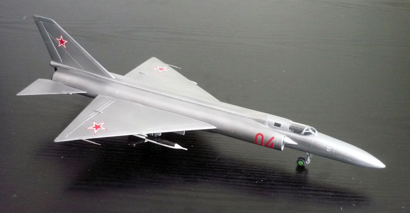

John R Posted January 20, 2013 Author Posted January 20, 2013 (edited) Thanks to all who posted the links and photos. There is something wrong with model regarding the missiles and their mountings. Either the missiles are too small or the mountings are in the wrong place. Here is a picture of the model as it stands. It has problems with the finish and with the attitude (too nose down). After all the problems getting it to this stage I am wondering if I am strong enough to deal with them... John Edited January 20, 2013 by John R
trimmer Posted January 23, 2013 Posted January 23, 2013 Looks really cool, John! In my taste the finish is alright, dont see anything wrong with it. Nose down profile is also specific to this aircraft - it's visible on the pictures. Dmitry
John R Posted January 24, 2013 Author Posted January 24, 2013 (edited) Looks really cool, John! In my taste the finish is alright, dont see anything wrong with it. Thank you but you have not seen it close up! Nose down profile is also specific to this aircraft - it's visible on the pictures. According to the drawing I have in 'Soviet Heavy Interceptors' the fuselage datum is level but the drooping nose makes it look as if the a/c is nose down. If you you at the nosewheel the the angle of the assembly holding the wheel is not right. If that was corrected to match the photos I think the attitude would be OK. Can you help with a question about the missiles. The kit missiles have a nose probe wheres those in the pictures, painted black and white, do not appear to have them. Is this correct? John Edited January 24, 2013 by John R
trimmer Posted January 24, 2013 Posted January 24, 2013 K-15 missile went through several modifications (as well as carrier aircraft "250"), even changing it's propulsion type. One of the variants (K-15U) had some sort of nose probe or seeker head, very similar to the one you've built, but i haven't seen any photo evidence - drawings only.
