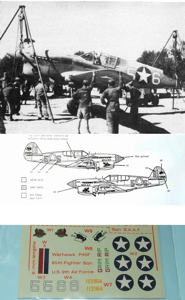

bad edd Posted September 2, 2010 Posted September 2, 2010 I plan to build a short tail P-40F and the markings in the old Almark decal sheet seem interesting. Apart from a poor photo showing a captured bird (which could be this plane or another with the same codes) I found absolutely nothing about this bird. Can you gentlemen help with some info or photo? Thank you Ed

billwinkes Posted September 4, 2010 Posted September 4, 2010 I plan to build a short tail P-40F and the markings in the old Almark decal sheet seem interesting.Apart from a poor photo showing a captured bird (which could be this plane or another with the same codes) I found absolutely nothing about this bird. Can you gentlemen help with some info or photo? Thank you Ed Ed I am currently preparing to build a P-40F, as well. I cannot comment on this particular a/c; however, my research applies as follows. These early a/c were painted USAAF "Sand" on the uppersurface and Neutral Grey lowers. It appears that the earlest were painted sand over OD. Some a/c show masking over of the serial numbers, stencils, and even the canopy frames, so that OD appears as a background (see; P-40 Aces of the MTO, Osprey and the Zotz Mediterranean Warhawks decal set). The sand color faded over time to become a chalky pink hue. Finding clear photos of a particular a/c may prove difficult. Enjoy the search and the build. Bill
