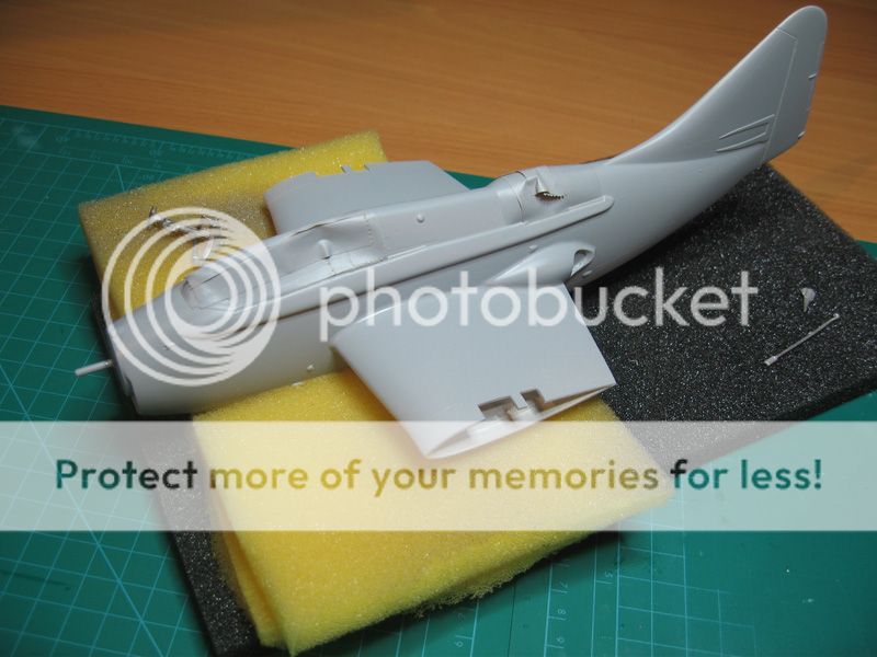

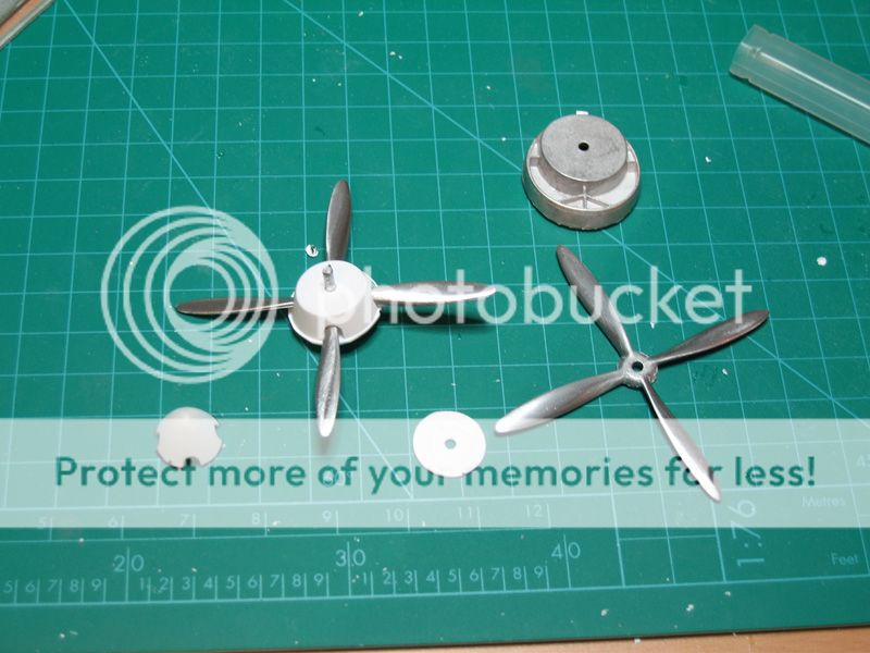

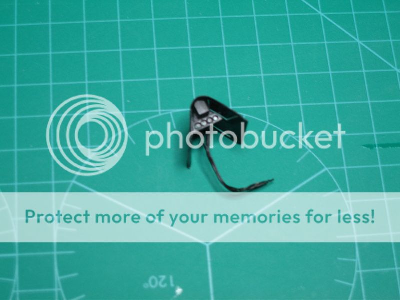

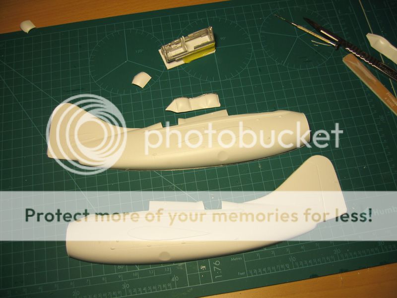

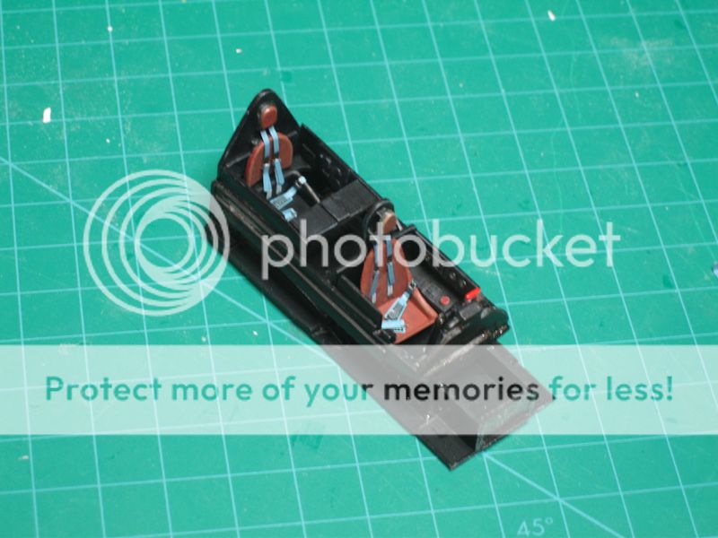

Rizzo Posted February 12, 2012 Share Posted February 12, 2012 So after finishing the Buccaneer and starting a Sea Vixen, I thought a COD Gannet would go well with them. And I've always loved the look of these things- not the most elegant design ever, but you can't say they're not distinctive. I had a look at what was available (expecting there to be nothing to be honest), and saw that both Dynavector and Classic Airframes made a kit for this aircraft. The CA one was going for a LOT on ebay though, and I've read a lot of good things about Dynavector, so I've gone for this version. As a bonus, I will get practice making vacform kits before I start a Scimitar, which has to be one of my favourites (so one I would really like to get right). The first task was cutting things out (although next time my first task will be adding stengthening braces). I've copied a thread here in adding marker pen lines around all the parts, and that really made things nice and easy to sand to shape. Next I put the front cockpit together, mostly with the kit parts, although it does need a bit added (no footwell, solid bulkhead, and too many instruments in the middle cockpit for a COD4) With all the metal parts added, it seems like this model will need plenty of strengthening, so I've added several bulkheads to the insides. I also made a new rear cockpit- the kit parts don't look like they'd work well here, and I want the empty COD version anyway. I've also cut the wings so they're folded, and attached them to each half. This way I can strengthen the join more easily than after the fuselage halves are joined together. I'm already hooked on these vacform kits- and as well as the Scimitar, have added a Swift to the stash Link to comment Share on other sites More sharing options...

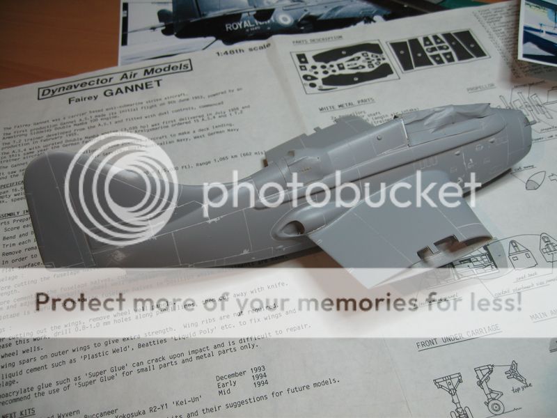

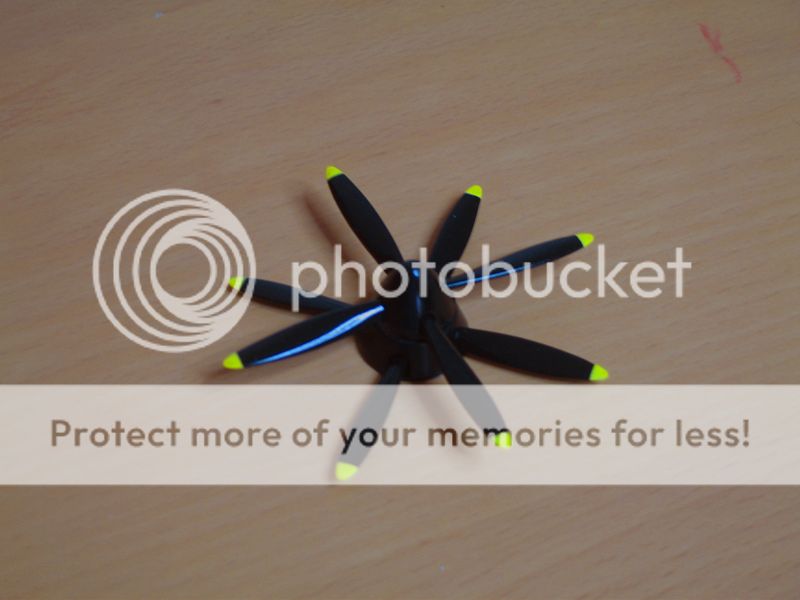

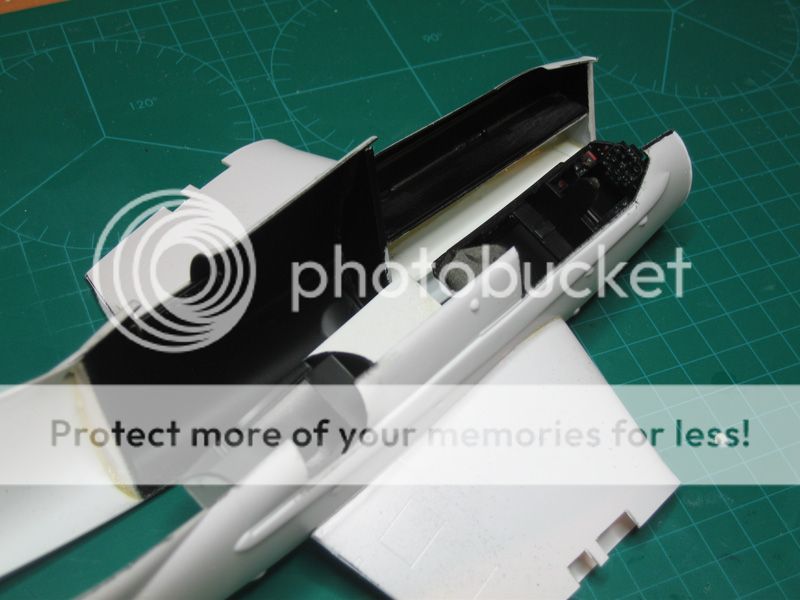

Rizzo Posted February 14, 2012 Author Share Posted February 14, 2012 I've got the fuselage joined together now. I've also added the parts around the jet pipes, and this needed quite a lot of filler to blend it into the area around. The join between the metal and plastic in the nose was tricky to hide too, especially as it's not along any panel line there- 3 attempts and it's hidden though! I made some new bits for the tail to replace the metal kit parts (which didn't fit well, just a bit too small) And the other bits of the nose were put together before I glued the nose into place- just to make sure it'll fit on properly later. Link to comment Share on other sites More sharing options...

Karl Posted February 14, 2012 Share Posted February 14, 2012 Looking very good so far. Love the look of the prop in post #4 - it's almost a shame to paint it.. Karl Link to comment Share on other sites More sharing options...

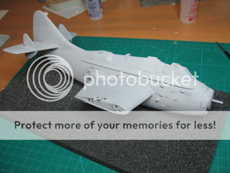

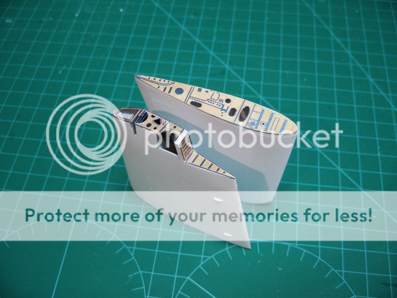

Rizzo Posted February 25, 2012 Author Share Posted February 25, 2012 Thanks for the comments I think this one is going to take me a while, so nice to have the additional motivation from posting it here. Last week I rescribed it. I guess the kit as it was made has panel lines that are more in scale than normal. But they disapear with light sanding, and won't hold any wash properly. So I'm making them more defined, and adding in some missing ones too. I should also have a sharp edge to the wing root at the front while keeping the curved join at the back, but that's something for the 'next time' list. Sorry Karl! And before I rescribe the wings I 'm adding in the wing fold. I love how there's even an aftermarket set for a vacform of an aircraft as relatively unknown as the Gannet is The photoetch is nice, but much too two dimensional. So I've chopped it up and used some plasticard to add the depth. This required a new rear quarter to be made, but I'm quite happy with how it's looking so far. I've also cut off the intakes, and I'm in the process of making new ones out of some sprue. The vacform bumps don't really work so well. Link to comment Share on other sites More sharing options...

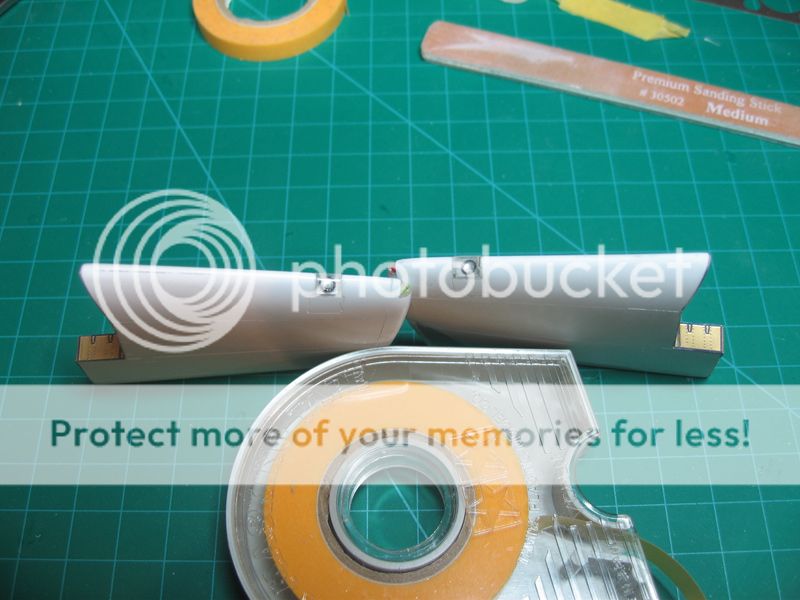

Rizzo Posted March 22, 2012 Author Share Posted March 22, 2012 I had a bit of a disaster with the outer section of wings. I used Revel glue for the first time becuase it was easier to get into the smaller space- but the next day I found the wing had turned into jelly where the glue was It did dry out properly after a week, so after reshaping the very wobbly looking wing, I'm finally back on track with this... I've added in the lights to the wings: And I added on some rivets. I've just picked out the larger and more obvious ones that are on the real thing. The first coat of blue is now on, so hopefully I can get the decals on later this week Link to comment Share on other sites More sharing options...
