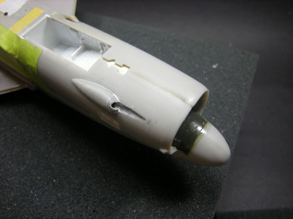

Pappy Posted January 7, 2008 Author Share Posted January 7, 2008 (edited) G'day all, Thanks for the encouragement. I may actually have to finish this one now! I am using the Eduard interior/exterior PE sets. The interior set includes a PE overlay for the rear bulkhead visible through the exhaust apeture. I also meant to post these pics of the preparation required to install the Aires cockpit Basically, scrape down the cockpit sill and remove the front portion of the instrument shroud shelf, remembering the old adage, measure twice cut once! Since my intake was all nice and smooth, and people wold be likely to look down it, they will need to see something at the end. To this end, I used an inlet turbine stolen from an Academy F-111 kit. I cut the turbine inlet out from the bulkhead and after removing the excess plastic, the outline was matched to the intake cross section. It was then painted and attched to the end of the inlet HAF A-7H's did not have th re-fueling probe fitted (unlike their A-7E's which do!) instead a crude fairing is installed over the same position. Using walkaround pictures as a reference, the fairing was knocked up using plastic stock. I also noticed that A-7H have the fuselage waveguides (radar transmission trunking) fitted. Luckily, these parts are included in the Revell A-7E boxing, so they were fitted after opening the appropriate holes in the fuselage. Apparently, in the original Hasegawa release, there was a PE fret that included PE bases to the waveguides. I didn't know this at the time, because if I did I would have traced around the waveguides and used some .005" plastic sheet to simulate it, :shithappens: cheers, Pappy Edited January 7, 2008 by Pappy Link to comment Share on other sites More sharing options...

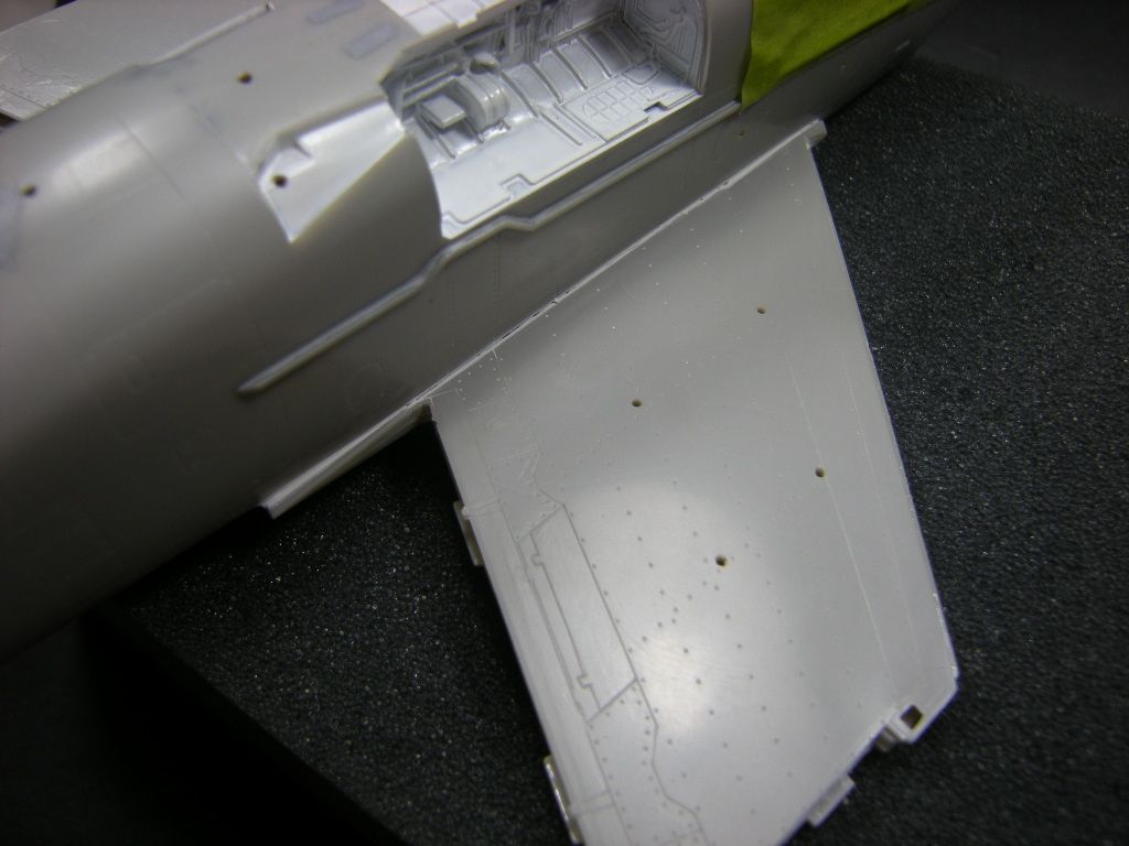

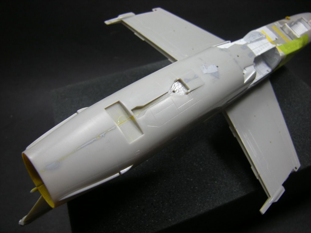

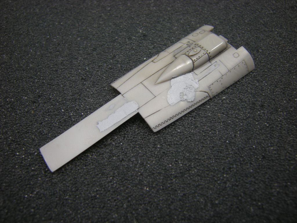

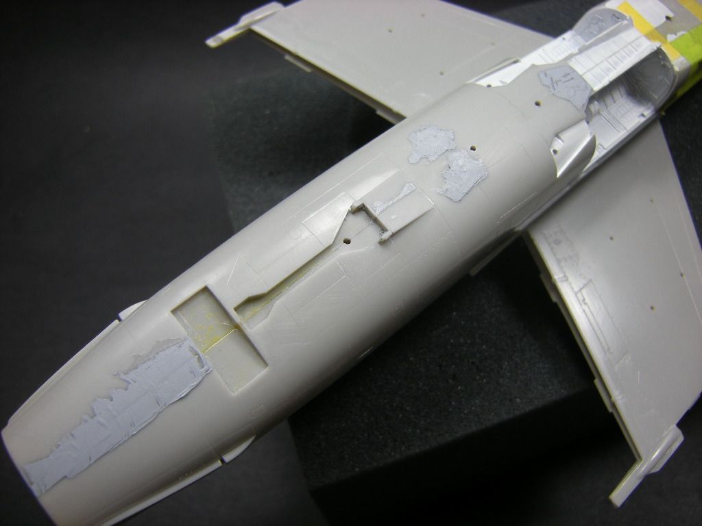

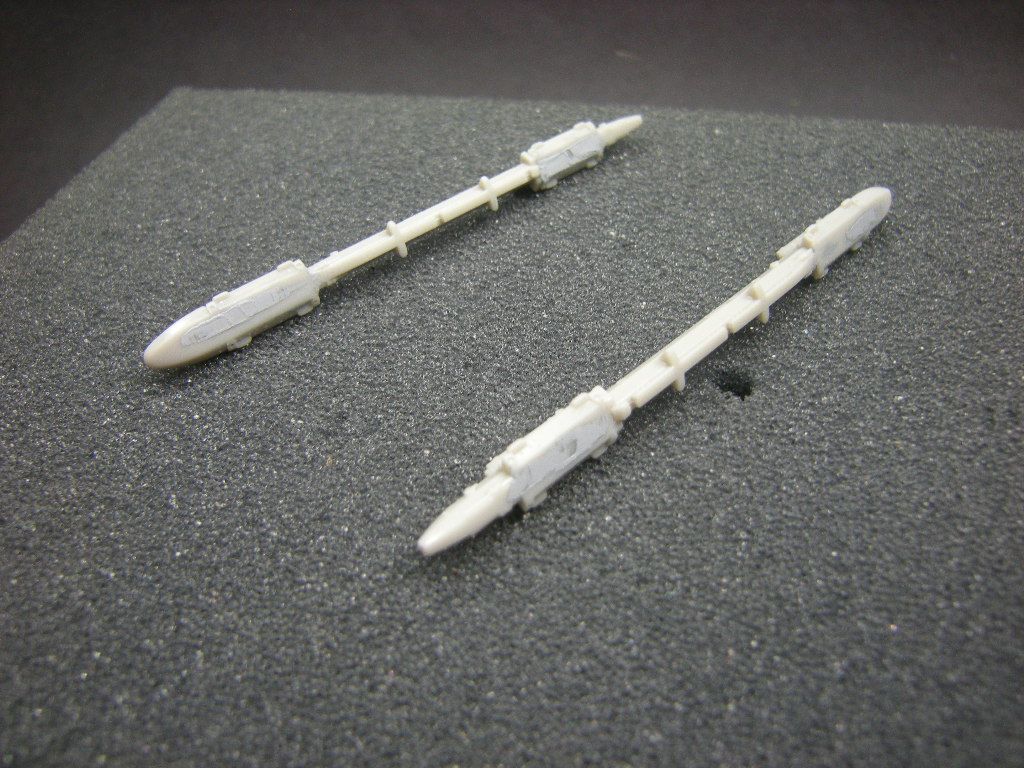

Pappy Posted March 25, 2015 Author Share Posted March 25, 2015 (edited) I pulled this one out recently and have started working on it again. The fit of the fuselage halves was okay, but the seam needed a little filler in spots due to sink marks mainly. Undoubtedly, the worst fitting part is the main wing. The cross sections between the wing centre section and fuselage don't match, The wing underside is very gappy as well - eeeck! The speed brake assembly has some bad sink marks but I think that was my fault due to the liquid glue melting the plastic. The speed brake assembly is built up from several parts and I may have been a little too liberal with the glue. Even the MER's have sink marks! I don't know if this is due to the age of the kit (this is the Revell re-pop of the Has kit) or it is just how the kit is, but it is a lot of extra prep work, cheers, Pappy Edited March 25, 2015 by Pappy 1 Link to comment Share on other sites More sharing options...
