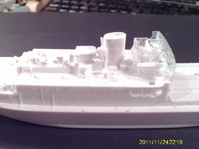

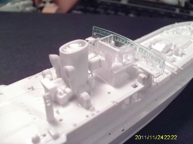

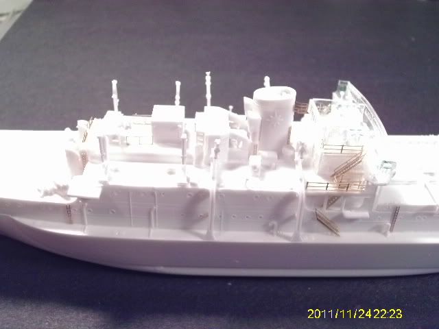

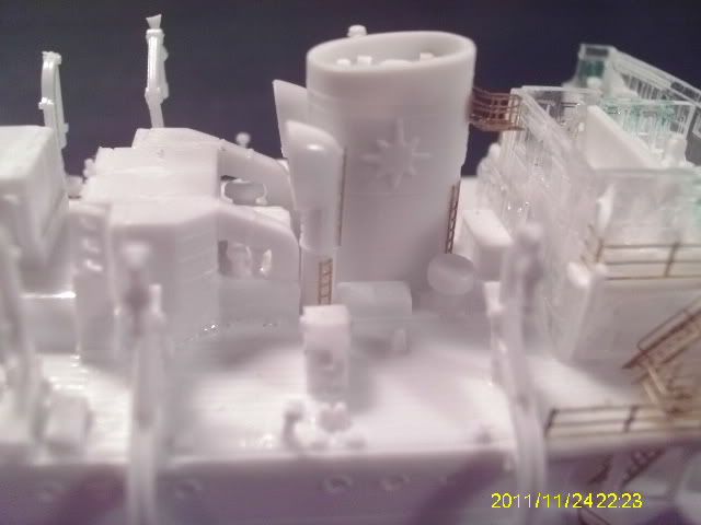

p-26luvr Posted November 26, 2011 Author Share Posted November 26, 2011 In this series of pictures I am going to try to keep them in the sequence of corps numbers. What I am attempting to do is to show that the deckhouse area behind the superstructure is different on each model. So please look closely at each picture to see the differences. I am not a good photographer so please excuse the quality of the pictures. This is the first corps version. This is the 2nd corpsone. These are the 3rd corps version. I hope that these pictures will be of help in understanding why I like these particular models. While there are a lot of very small parts, the model itself is not really overl;y complicated to assemble for the average modeler Taking your time & following the instruction careful;ly & thinking ahead are of course a necessary part of the process. I have assembled all 3 model in just over 5 weeks. AND AGAIN THEY ARE MY FIRST 1/350th scale ship models. Carl T Link to comment Share on other sites More sharing options...

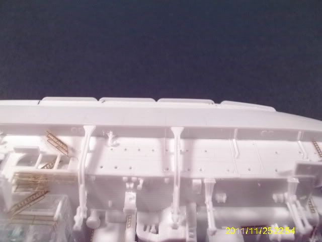

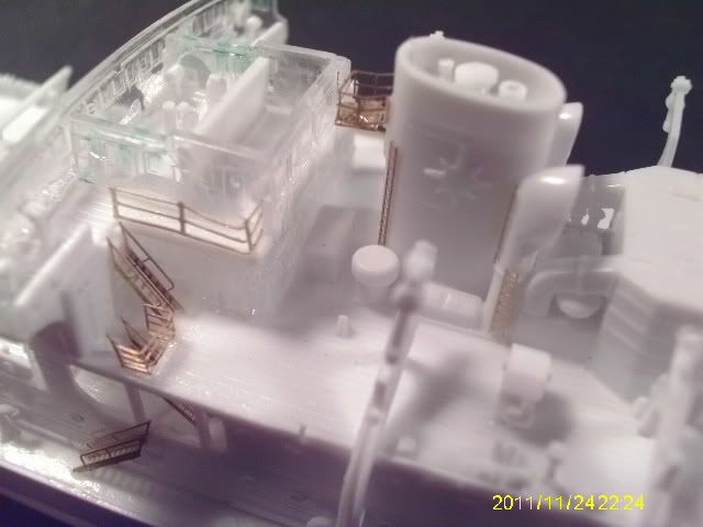

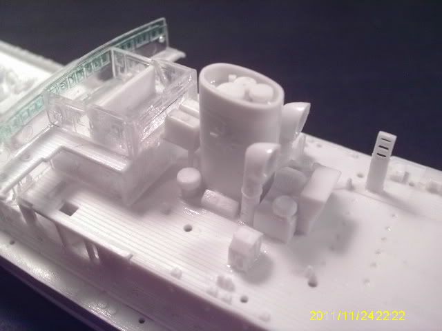

p-26luvr Posted November 27, 2011 Author Share Posted November 27, 2011 I am including this picture to show that I have used the 4 pl;astic parts supplied as kit parts, instead of etch-brass parts. I did this because I think the plastic parts are much less likely to break off from the model than E/B. They are not on the first corps version. There are no placement marks on the hull parts. I used the side views on the rigging diagrams to properly place the 4 parts per side. The 4 parts that I am talking about are the 4 bumps at the curve of the hull bottom. Carl T Link to comment Share on other sites More sharing options...

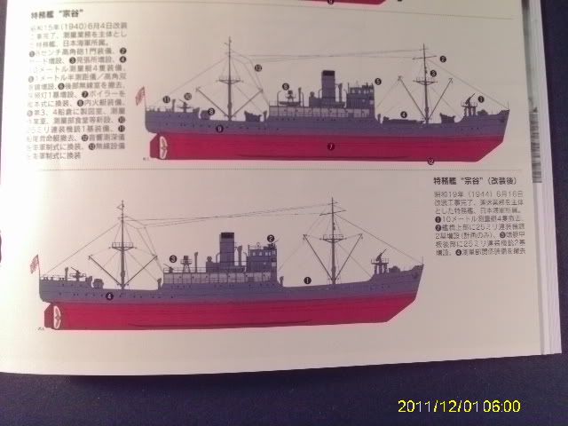

p-26luvr Posted December 3, 2011 Author Share Posted December 3, 2011 This first picture is of the cover for the bokklet that is with the first corps version. See an earlier post for details. This picture & the next one are from this booklet. It is a wartime picture, I think. this view is also from the booklet, & the profiles show the ships wartime coloring. If you look closely at the text you can read the dates 1940 & 1944. When I set the 1st & 3rd corps versions of the models side by side I can see the extreme differences brought about on the ship over the space of just 2 years, between what I am presuming was thje 1st & 3rd voyages to the Antarctic area. Except for the hull you would not know that it is the same ship. Because I enjoy reading a lot of history books I would dearl;y love to know a lot more about this ship. Wartime hazards, Antarctic adventures, Icebreaking dangers, & retirement as a museum. That sounds like one hell of a rip roaring saga to me. Carl T Link to comment Share on other sites More sharing options...
p-26luvr Posted December 3, 2011 Author Share Posted December 3, 2011 Since posting the above pictures I have been speculating on the feasability of converting the first corps version back to a wartime model. while doing so I went back to the booklet to further study some of the relevent pictures & profiles. The profiles have what is surely a year date, & possibly a month & day one as well which dates the picture above at Sept. 25, 1945 ( my guess ). Now we come to this picture; It corresponds closest to the top profile above dated at June 4th 1940 again my guess. A little while later on I am going to present what I will call a "what if semi-scale " version of a wartime SOYA for your consideration, once I have mashalled all of my thoughts into a cohesive point of view. Carl T Link to comment Share on other sites More sharing options...

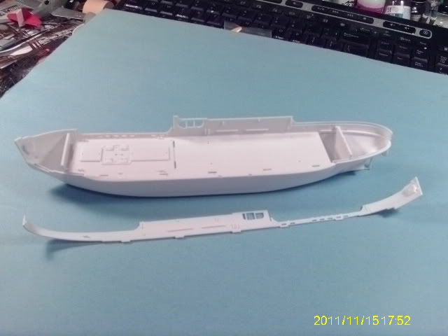

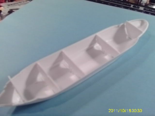

p-26luvr Posted December 6, 2011 Author Share Posted December 6, 2011 With these 2 pictures I am going to start my "What if " conversion of this model back to a wartime configuration. These are my ideas on how to go about the conversion. I alert you two important things, I AM NOT A SHIP MODELER, & THE FINISHED MODEL IS ENTIRELY SPECULATION ON MY PART.The first thing I have done is to have the above 2 wartime pictures enlarged until the ship image is 12 inches long, & have had them lightened so that the detail stands out better. The only model suitable to use for this conversion is the first corps one, Hasegawa kit number 40064. As you read along refer to one or other of the above 2 pictures. This posting will only cover the work on the hull. The rest will come in a later posting. The first thing I would do is to trim the side of the formers that you see in the hull; to the correct width for the replacement hull pieces so that they will support the new side pieces. I would determine this width by measuring the distance between the slots on the deck piece., measuring to the inside edge of the slot. These slots are where the upper hull side pieces will fit later. Next, I would lay, but not glue, the upper hull side pieces in place on the deck piece and draw a line along the outside of the hull pieces. This is where you will have to cut that outer part of the deck off. I would cut partially through the deck piece now. I would now glue the main hull pieces firmly together & set aside to let dry fully. I would now glue the modified formers to the underside of the deck piece in the place where they are supposed to be glued & to the inside bottom of the hull, gluing the deck at the same time to just the bow & stern areas. This should give you a good solid piece to hold while doing the following cutting operation. Hasegawa has done an excellent job of showing just where the side pieces are that have to be removed. They are the bulged area on each side. Removing these areas will require slow, patient, exact, & relaxed cutting. You will probably use several blades while doing this part of the model. I would do the whole of the first side before doing the other. I mean by this to add the replacement side piece & cut off the excess deck piece now, & let it all set until fully dry before doing the other side. Then do the same thing on the other side. Now comes the time when you have to remove the bump on the lower bow in order to make the bow straight from top to bottom. And you have to carve away the double bulges on the stern where there are now 2 propellers in order to make way for a single propeller. If you have gotten this far without heaving the model in the wastebasket, we now come to what I consider to be the most delicate part of the conversion. Adapting the upper hull side pieces. If you look at the pictures above as you read this you should easily understand what I am talking about. The front section is usable just as it is. BUT the back section rerquires a lot of very tricky cutting & trimming. A longish U section has to be cut into the top & a few rectangular holes made in the thinned down part. To locate all of these things I would enlarge one of the color profiles to the size of the model & take my measurements from the enlarghements. If anything will break easily it will be in this operation. This is all for now, I will do the upperworks in another post. Any & all comments will be very welcome. Carl T Link to comment Share on other sites More sharing options...
Alan P Posted December 6, 2011 Share Posted December 6, 2011 Carl, actually I would say you are a ship modeller! It's great to see someone attacking a project like this with so much enthusiasm and clear fondness for the subject. Al Link to comment Share on other sites More sharing options...
Iain Ogilvie Posted December 6, 2011 Share Posted December 6, 2011 Just a thought... If I were cutting the side sections off/modding the hull - I'd put lower hull together with the formers and fill with polyurethane casting resin and carve back. Time consuming on the carving perhaps - but you'll get a very stable/rigid structure. Iain Link to comment Share on other sites More sharing options...
p-26luvr Posted December 6, 2011 Author Share Posted December 6, 2011 Thanks for your comments gentlemen, I appreciate them. I had not thought of doing what you suggested Iain, but it is a good possibility. I will do the rest of this part of my speculations in a day or two. I am hoping that more people that build ship models will join in the discussion on how to do such a conversion so that maybe someone will actually try it. Carl T Link to comment Share on other sites More sharing options...
