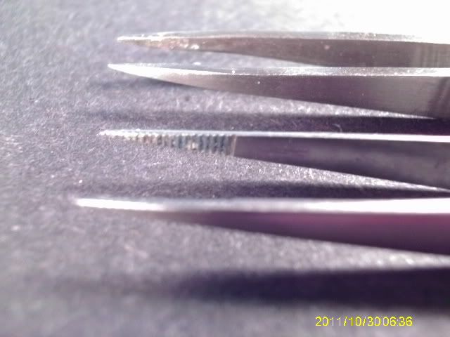

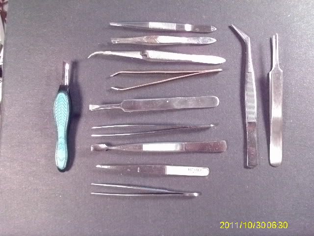

p-26luvr Posted November 1, 2011 Author Share Posted November 1, 2011 This first picture shows part of my collection of tweezers. This picture shows a pair of tweezers that I use for handling the smallest parts. It is the one on the bottom. As you can plainly see, it has the serated facing pieces. I have included the top pair to show the flat faced faces on some tweezers. This is the folding tool that I will be using with the etch-brass parts. It is called the BUG, & is, i believe available from Cammets in the UK. I hope that these pictures give some help. Carl T Link to comment Share on other sites More sharing options...

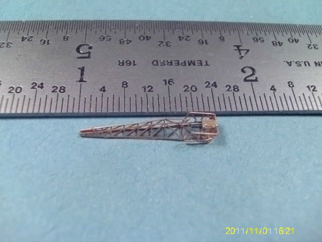

MODeller Posted November 1, 2011 Share Posted November 1, 2011 I have been conversing with Carl over this model and he has given me the KUTA to take mine down from the shelf of doom, respray it in acrylics and start thinking about a dio scene. Today I have sorted out the Bell 47 using the etched parts set and enclose a couple of photos of the completed article. MODeller Link to comment Share on other sites More sharing options...

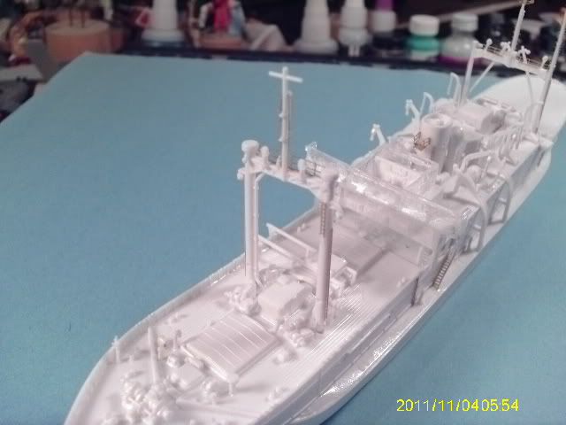

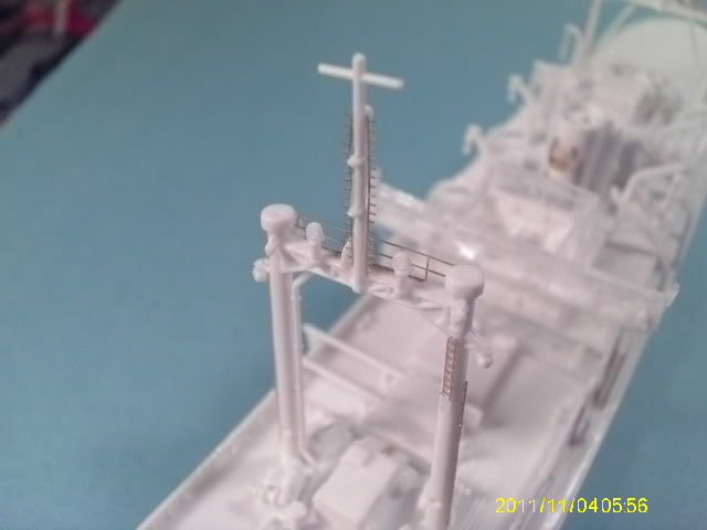

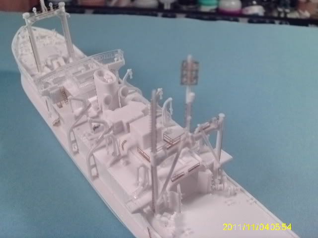

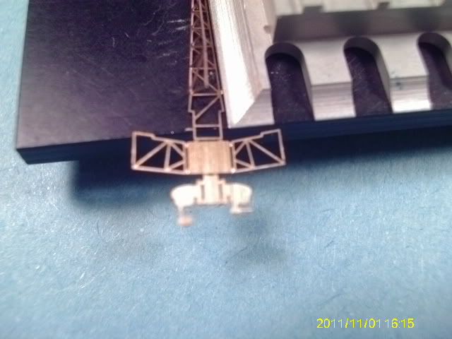

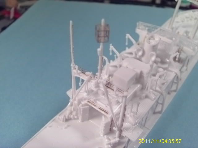

p-26luvr Posted November 3, 2011 Author Share Posted November 3, 2011 I have made a good start on the etch-brass work parts today. I have added several of the ladders. the radar array on the rear posts, & one of the Bell helicopter rear ends. I also bought a piece of pine for the base for this model. It is all a lot easier to do than I had anticpated it would be. I will post more pictures of this part later. Carl T Link to comment Share on other sites More sharing options...

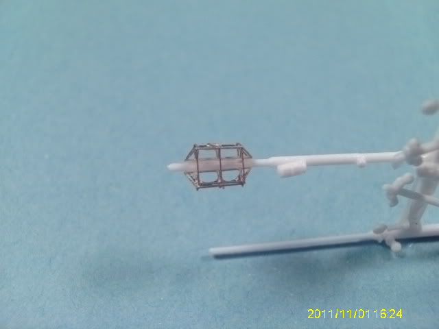

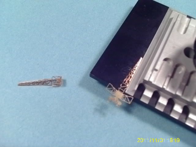

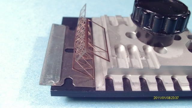

p-26luvr Posted November 3, 2011 Author Share Posted November 3, 2011 The first 3 pictures are of the Bell helicopter brass framework being made up. In this one the framework has been folded on one of the rear ends already which you can see if you look closely. In this picture I have added the first framework to show the before & after assembly. In this picture you can see the length in 1/32nd of an inch. I n this picture is the radar array on the rear mast. There are 4 pieces of E/B folded at 45 degrees glued to the mast & to each other. This is a picture of the superglue that I use with my E/B. I use this almost exclusively. It is slow drying, giving me plenty of time for placing parts. It has a screw top cap. The most important aspect for me is that a bottle lasts for a very long time without hardening in either the bottle or the application point. Carl T Link to comment Share on other sites More sharing options...
p-26luvr Posted November 6, 2011 Author Share Posted November 6, 2011 These next few pictures show the work that I have done with the etch-brass parts so far. This is the superstructure that shows the ladders that are in the same place in both sides. They are from a Gold Medals E/B fret of extra ladders that has several different sizes. I used these E/B ladders because the plastic ones in the kit looked too cluncky to me. You can also see the various additions to the smokestack. This is a closeup of the forward derrick posts with ladders on the side, & railing on the crossbar. The bow again, but not so close up. This is the stern king posts from the port side. And from the starboard side. Both king post are only temporarily in place. Carl T Link to comment Share on other sites More sharing options...

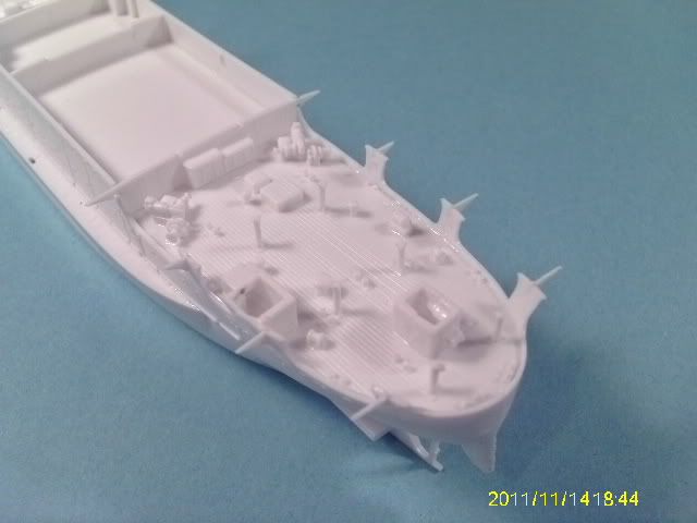

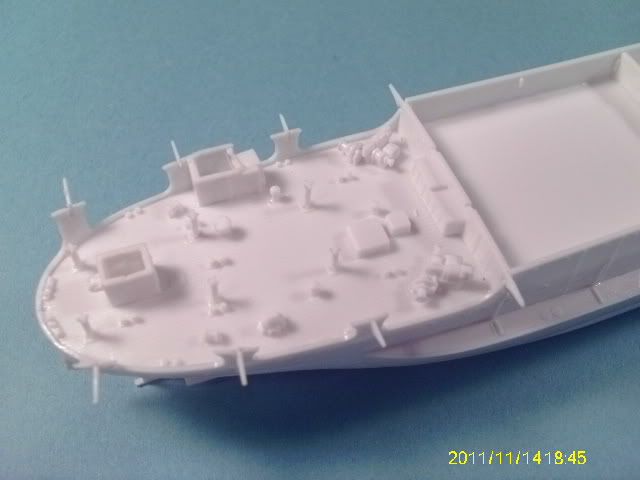

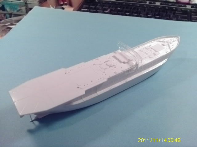

p-26luvr Posted November 14, 2011 Author Share Posted November 14, 2011 Yesterday I went over to Nashua, N H & bought the 3rd version of the SOYA, so I now have all 3 versions that Hasegawa has released of it. I spent several hours today working on this new kit. I have the hull together with the fore deck & lower stern deck in place, & the front facing of the superstructure in place. I have not added any of the small detail pieces as yet. I placed the larger helicopter landing pad in place to find out how it would look once finished, & then placed the 2 models together side by side, & what a very real difference there is between the models. I will post pictures in a few days. Where I just barged ahead with the first model it is readily appearent that with this one I am going to have to plan well ahead what will come next in the construction & painting. Stay tuned for more yet to come. Carl T Link to comment Share on other sites More sharing options...

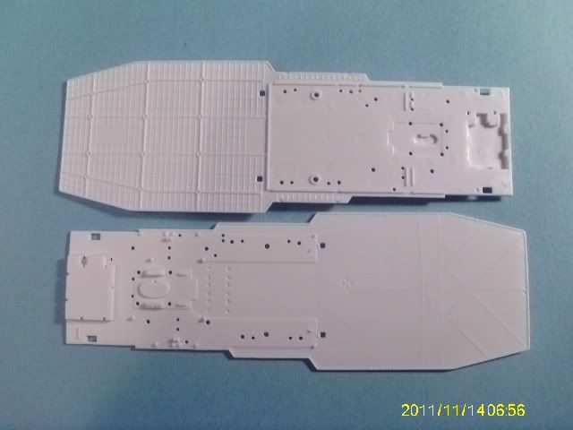

p-26luvr Posted November 16, 2011 Author Share Posted November 16, 2011 In this picture I have wanted to show the detail that is on both the top & bottom of the larger helicopter landing pad/deck. The ribbed part is the underside which will not be readily evident once the deck is mounted in place. If you look real closely at the top you can see the raised detail that is there. On the 2 models that have the helicopter hanger there is structural detail inside of that as well. Carl T Link to comment Share on other sites More sharing options...

p-26luvr Posted November 16, 2011 Author Share Posted November 16, 2011 These 2 pictures show the added plastic parts for the lower rear deck. The larger helicopter deck will go over this. The etch-brass set for this model is on its way to me in the mail, from Sprue Brothers & I expect that there will be etch-brass pieces to add in this section.. If you will look closely you will see several of the very small pieces in which I used the serated faced tweezers to hold those pieces. As with all my models that have a large number of sprues I used a fine pointed black Sharpie pen to mark the sprue letter where I can easily see it somewhere on a flat area on the sprue.Where there are about 19 sprues with over 200 parts in this model doing this makes it much easier to find what is next. Now that I am doing all 3 models I am planning to show the major points of diffrence between the various models so that anyone interested in buying/making one can make a more informed choice as to which one suits him. Carl T Link to comment Share on other sites More sharing options...
p-26luvr Posted November 16, 2011 Author Share Posted November 16, 2011 This picture shows the rear deck of the earlier model for comparison to the above 2 pictures. Carl T Link to comment Share on other sites More sharing options...
