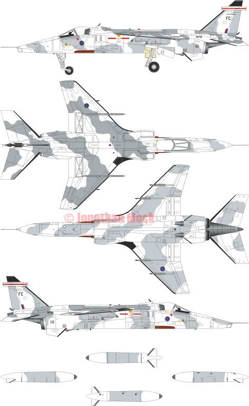

thx6667 Posted September 20, 2011 Share Posted September 20, 2011 (edited) This is the 2003/4 Bardufoss scheme, redrawn from actual scheme drawings provided by Coltishall: The pattern varies from aircraft to aircraft but may be relevant to the scheme you're doing. Edited September 20, 2011 by Jonathan Mock Link to comment Share on other sites More sharing options...
Muzz Posted September 20, 2011 Author Share Posted September 20, 2011 Jonathan, that's just what I'm needing. Your own artwork too, I'm impressed! Thanks very much. Murray Link to comment Share on other sites More sharing options...

AnonymousAA72 Posted September 21, 2011 Share Posted September 21, 2011 Jonathan, that's just what I'm needing. Your own artwork too, I'm impressed! Thanks very much. Murray One thing I've noted from photos' is the very soft demarkation of the white.....nice looking scheme! Link to comment Share on other sites More sharing options...
Muzz Posted September 21, 2011 Author Share Posted September 21, 2011 One thing I've noted from photos' is the very soft demarkation of the white.....nice looking scheme! It is a nice scheme, a bit different too! Interesting point about the demarcation line, in some photo's it looks quite solid and on others it's soft, suppose it depends on how far away the photo's taken but also possibly varies between aircraft. I also noticed on some aircraft care has been taken to avoid spraying the white over the black areas (fin tip and starboard wing root) whilst on others these areas have just covered over! http://www.41retro.co.uk/index.php?name=co...&fullsize=1 http://www.airfighters.com/photo/66806/L/U...uar-GR3A/XX720/ Link to comment Share on other sites More sharing options...
Jabba Posted September 23, 2011 Share Posted September 23, 2011 I know in the olden days they used to give the linies a 4" paint brush to do the white with which is why you got the harder demarcation line and overspill onto the black bits, but I don't know what they used later on. Link to comment Share on other sites More sharing options...

Muzz Posted September 26, 2011 Author Share Posted September 26, 2011 Mine has the dark sea grey and dark camo grey on and I'm quite pleased with it. Just need to pluck up the courage to cover it in white bits now, which I'm not looking forward to, never the best colour to spray. Going to try some GW skull White and see how I get on with it. Some photo's hopefully on in progress soon! Link to comment Share on other sites More sharing options...
thx6667 Posted September 26, 2011 Share Posted September 26, 2011 (edited) Gloss coat youR greys first. Mask out the pattern with blu tac then spray the White, I'd recommend Tamiya as its very opaque. The gloss coat not only helps you tidy up any overspray (because the paint hasn't got the same grip as on a matt surface) but also you can scuff some areas with scotchbrite and the paint will wear away to a nice weathered finish. Then seal it with a gloss coat and it's as tough as boots. Edited September 26, 2011 by Jonathan Mock Link to comment Share on other sites More sharing options...
Muzz Posted September 26, 2011 Author Share Posted September 26, 2011 Thanks for the advice Jonathon, I'll try that, I bought a jar of Tamiya white too! I've put a wash on it at the moment then I'll put a gloss coat on. Link to comment Share on other sites More sharing options...
