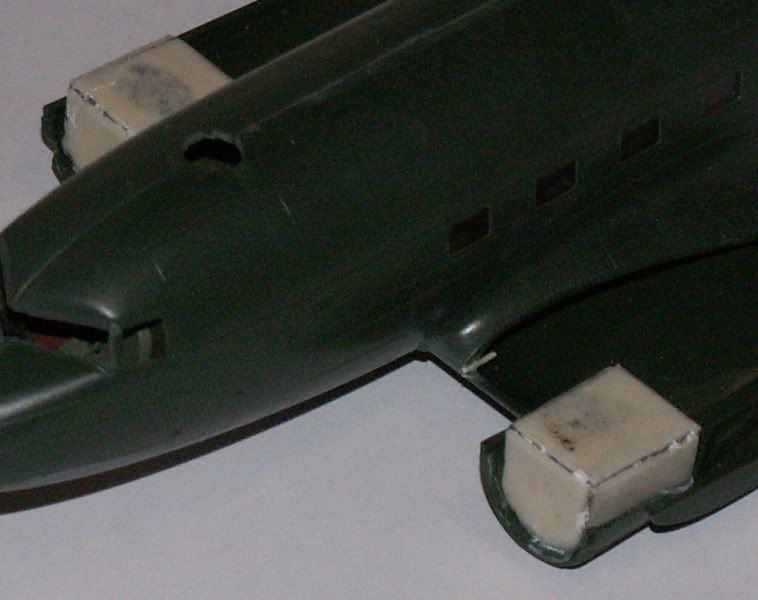

So, I've decided to start with the ... engines :shrug:
On the plus side, there is no need to remove the pour stubs. On the minus - there are fourteen 4mm pushrod tubes to put on each one. Once more the poor kitchen brush donates some bristles for the cause!
More soon

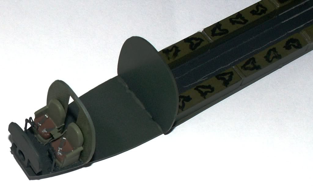

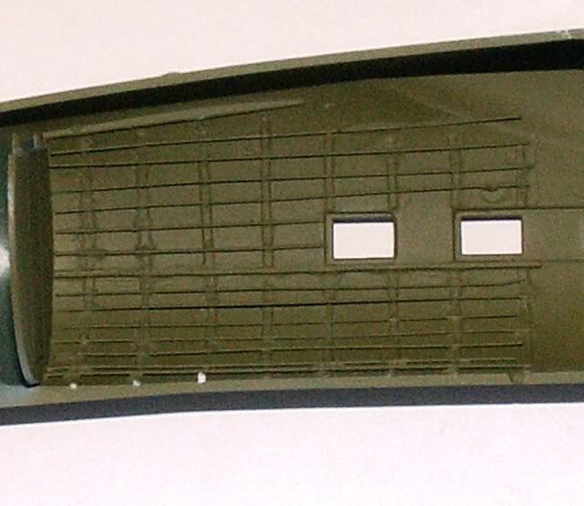

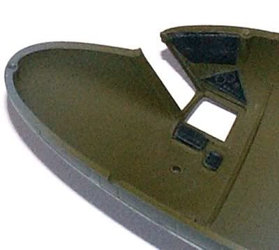

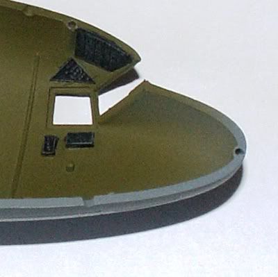

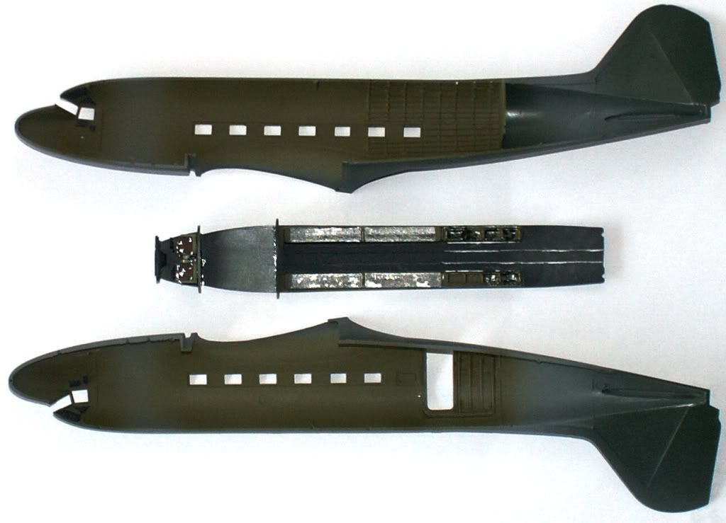

I have been making steady progress and now it's time to post some piccies. As I'm going to be leaving the passenger door open, I've added a little interior detail around that area. I've also used the etch details for the cockpit and I reckon if I leave the cockpit side windows open some of it might actually be visible when it's finished.
General shot:
Wall detail opposite the door:
View of the cockpit and lap belts
That should be good enough considering how difficult it is to see inside.
Andy

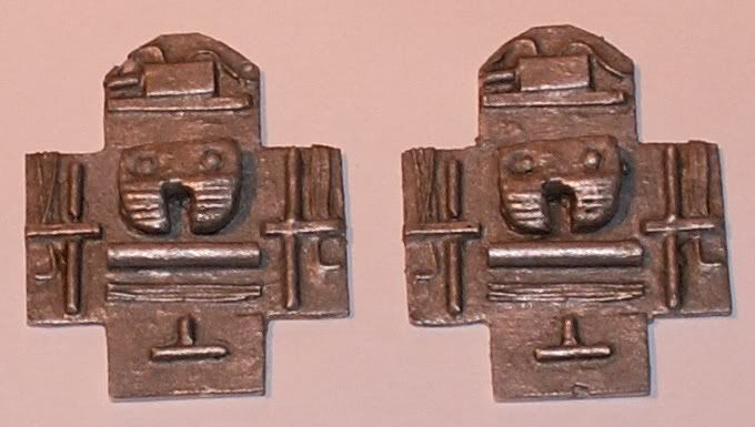

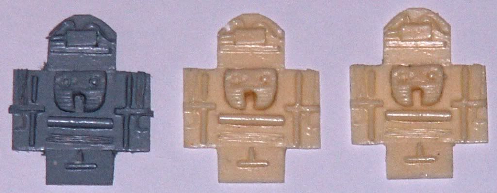

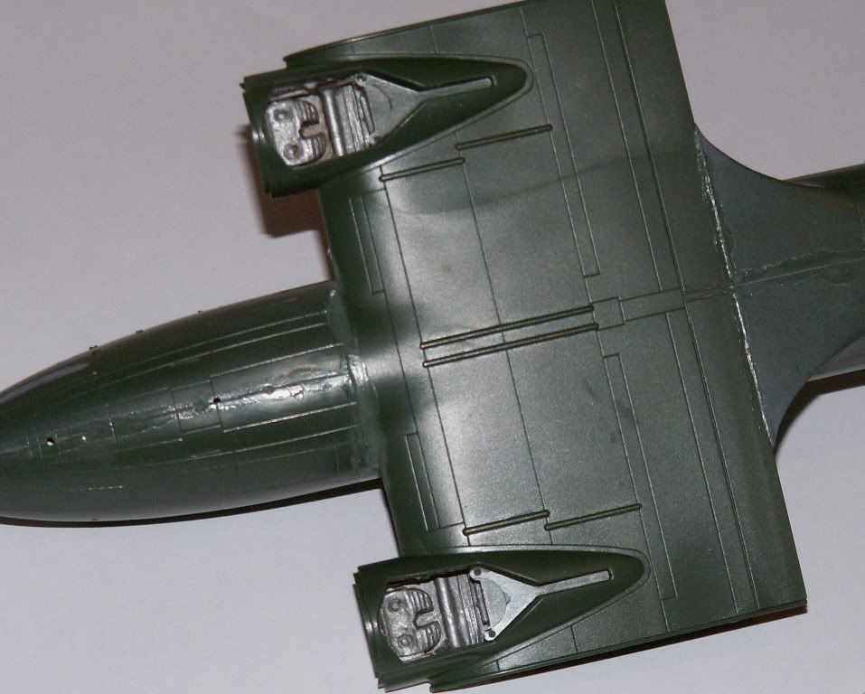

I've had a go at the wheel wells. In my usual lazy way, I thought that I might as well do a pattern for one and then mould as many as I need.
Master and mouldings
Painted first
Then folded up into a box
And finally, in situ
I'm pleased with them. Of course, they're not completely accurate, being a bit shallow and having a flat roof, but they are effective in place and stop you being able to look through to the back of the passenger benches :o .
PM me if you would like a pair.
Andy

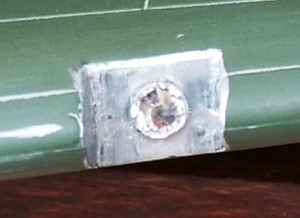

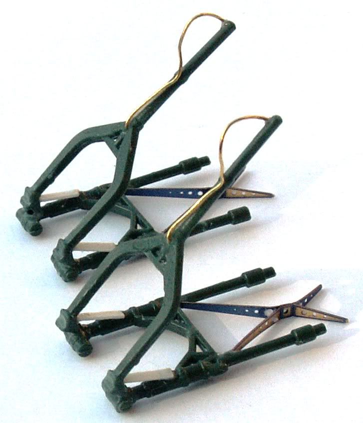

Thanks Andy. As promised, I have a couple of pics to put up. First up is one of the rhinestone landing lights.
At this magnification you can make out the facets which is a bit off-putting, but when the cover is on it's nice and bright and looks just like a round headlamp.
We also have the undercarriage assemblies, which have been detailed with a bit of photo-etch, some wire and some plastic strip
I reckon that pretty much does it for construction, so it's into the booth for some primer.

Those undercarriage mods look good and that's a good idea for the lights.
I hope you don't mind if I copy some of your enhancements on to my build (that's the advantage of being behind everyone else ... I can get to see all those good ideas and use them myself :) ).
