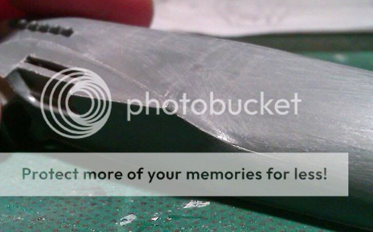

Nobby Posted August 27, 2011 Author Posted August 27, 2011 Here's tonights update! Got a lot of chopping and scraping to do on this model! Made a start with the cockpit to prepare for the internal structure. As the door is going to be open I thinned the edges down to more scale like thickness. Next job that needs doing is the wheel bays. As provided they are too shallow, and the detail in them is wrong. Out with the knife and chop them out! Now all I have to do is fill them gaping voids! That's all for now so be seeing you! Nobby 1

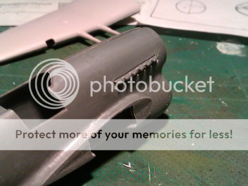

Nobby Posted August 30, 2011 Author Posted August 30, 2011 Great beginnings Nobby.No doubt that this will be as fine a model as the Stringbag, the great thing with the Typhoon is that there are shiploads of photographs around to help. Have fun, I'm going to enjoy this too. Thanks mate! Well last night I did down load a shed load of pics from the Flight magazine site, and all in lovely hi res! They have tons of pics and mostly period pics so they are very useful! Link here... www.flightglobal.com/imagearchive/Gallery.aspx?GalleryName=Photo%20Archive/1939-1945&pagenumber=24 So for all of you who are expecting a cockpit pic, well, I'm sorry but I ain't got that far yet as most of the work so far as been tidying stuff up and cutting and hacking! Takes longer than it looks especially as half of the plastic in the kit has the consitency of mouldy Russian cheese! The dark grey plastic if your wondering! It seems crumbly and the edges get furry when you cut it a certain way. It's a bit like hard polyprop! It glues ok though. When I got it home from the model shop and opened the box I was suprised to find four different colors of plastic but didn't expect different consistencys as well! I still preferre it to the Academy Tiffy though! So here's what I've done so far. I wasn't happy with the way the exhaust manifolds were just moulded on to the side, same ad the Academy kit as well so I went about improving the look of them by scribing down the sides to give the impression that they protrude through the cowling panels.In my veiw its little things like this that add to the look of the thing. I'll be drilling the stubs out as well for a bit extra. Another thing I want to try is getting the landing lights looking decent. So I cut the leading edges ready for so lights. This was where the cheesy plastic started to worry me as I needed to carve the inside out to a more scale like thickness. So there we go! Sorry its not much but hopefully tomorrow I'll either be starting on the wheel bays or the cockpit. Thanks for looking in! Nobby 1

perdu Posted August 30, 2011 Posted August 30, 2011 (edited) Nice work Nobby, wish I'd put in more definition round the exhausts like you have I see you have cut out the wheel well areas properly too (I'm happy to say I did too ) and the huge landing lights, they were a massively obvious thing with the Typhoon Going to be another very entertaining show mate thanks [harry, I think you might be remembering Airfix Magazines of the sixties and early seventies, Alan Hall was a huge fan of balsa and doped talcum powder. Oddly enough they looked quite good when finished] Edited August 30, 2011 by perdu
Nobby Posted August 31, 2011 Author Posted August 31, 2011 And I'm looking forward to it! This is 'old skool' modelmaking like I read about in my Dad's old Scale Aircraft Modelling, just without the balsa wood conversions. Or are you gonna give us one of them next....Mark. Thanks Mark. I like the old school modelling ad well When I was a kid in the 70's I used to want to be able to build models like I saw in the mags, but I never felt I had the skills or the resources to do it. I must have been modeling on and off for about 40 years now possibly a bit longer. I do remember well the conversions using balsa, dope and talc. As I also do aeromodeling I'm quit familiar with the dope and talc method and as I've got a shed load of balsa the possibility of making something from it are pretty high! Who knows, after seeing seeing Fozzys scratch builds I may be tempted! Nice work Nobby, wish I'd put in more definition round the exhausts like you haveI see you have cut out the wheel well areas properly too (I'm happy to say I did too ) and the huge landing lights, they were a massively obvious thing with the Typhoon Going to be another very entertaining show mate thanks [harry, I think you might be remembering Airfix Magazines of the sixties and early seventies, Alan Hall was a huge fan of balsa and doped talcum powder. Oddly enough they looked quite good when finished] Thanks mate. I just thought it may improve the look a little but I'm glad I did it as it looks convincing to my eyes! Here we are then! I was going to post this tomorrow but I'll do it now as I can't sleep! I said I'd post last night but a mate came round just as I was starting to make the wheel bays! Job held up! I have managed to start them though and I made the radiator and plugged the hole inside the rad air outlet. Hole filled with plazi card. I also thinned the edges of the outlet. More tomorrow! Thanks for looking. Nobby 1
warhawk Posted August 31, 2011 Posted August 31, 2011 In my veiw its little things like this that add to the look of the thing. Add to the look? More like add a whole new layer of realism! Sometimes it can be a hassle to redo these minor things, but sure is worth it! BTW, nice job on the exhaust. Aleksandar

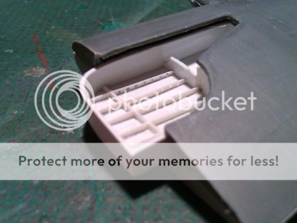

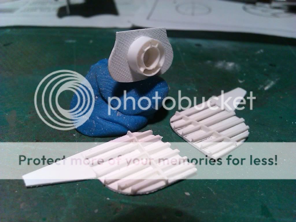

Nobby Posted September 1, 2011 Author Posted September 1, 2011 Got the wheel bays just about finished but still got some finer detail to add. Just a dry fit to see how they look. More to come! 1
keefr22 Posted September 1, 2011 Posted September 1, 2011 Just a dry fit to see how they look. They look good...!! K

Nobby Posted September 1, 2011 Author Posted September 1, 2011 They look good...!! K Thanks mate. Rather pleased with how they are going. Thought I'd better start with these first as I need to see how far they go in the fuz and it'll effect the way the cockpit fits. Hopefully that part of the build will be getting started tonight!
