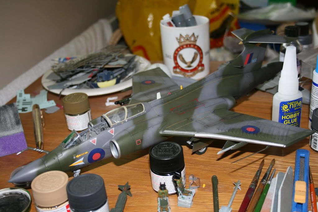

Muzz Posted June 18, 2011 Author Share Posted June 18, 2011 Cheers Houston, you don't have to wait long, I started a few days ago so here's where I'm up to............ Cockpit painted using various shades of black and a coating of Flory Models white wash. I have the Paragon seats too but decided to use the Neomega one as the castings a lot crisper, although it's not a very accurate Mk9, oxygen bottle and other equipment appear to be on the wrong side but won't really be seen. Fitted in along with the gear bay which I forgot to take photos off! And all together not a bad fit at all. Here's a wee preview of my currently stalled Buccaneer build, nearly finished, just waiting on some inspiration for the ejection seat handles and sorting out the underwing stores. Link to comment Share on other sites More sharing options...

Muzz Posted June 18, 2011 Author Share Posted June 18, 2011 Looking good! I will send you those instructions for the pit if you still need them? Are you stuck for something to make the ejection handles from? I have just the thing! Drop me a PM and I'll explain! Be a shame to leave such a nice looking kit unfinished!! Phil Hi Phil Yes, I need to find out where the two parts go that are like some sort of pipe work, next to the control stick in the above photo, maybe on the rear bulkhead or inside the canopy? Pm sent regarding the handles. Col Thanks, photo's of the Bucc will hopefully be up shortly. Muzz Link to comment Share on other sites More sharing options...
