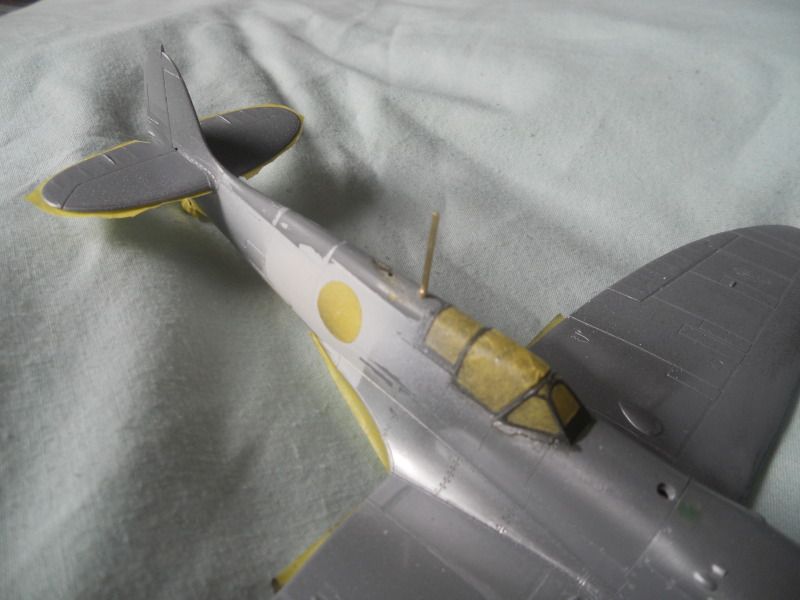

Col. Posted September 27, 2012 Author Share Posted September 27, 2012 Cheers for the comments chaps. Hope it helps you avoid some of the mistakes I'm making! You are correct Dave, massive potential for a very interesting decal sheet covering multiple Spitfires from 602 Sqn. alone, planning another with the earlier ZT codes and thinking of a 21 or 22 as well so that's three or four to start with. Spent last night making an early straight aerial from brass rod and glued into place after masking the undersides, Still to mask the wing roots then time to point some paint at her again. Link to comment Share on other sites More sharing options...

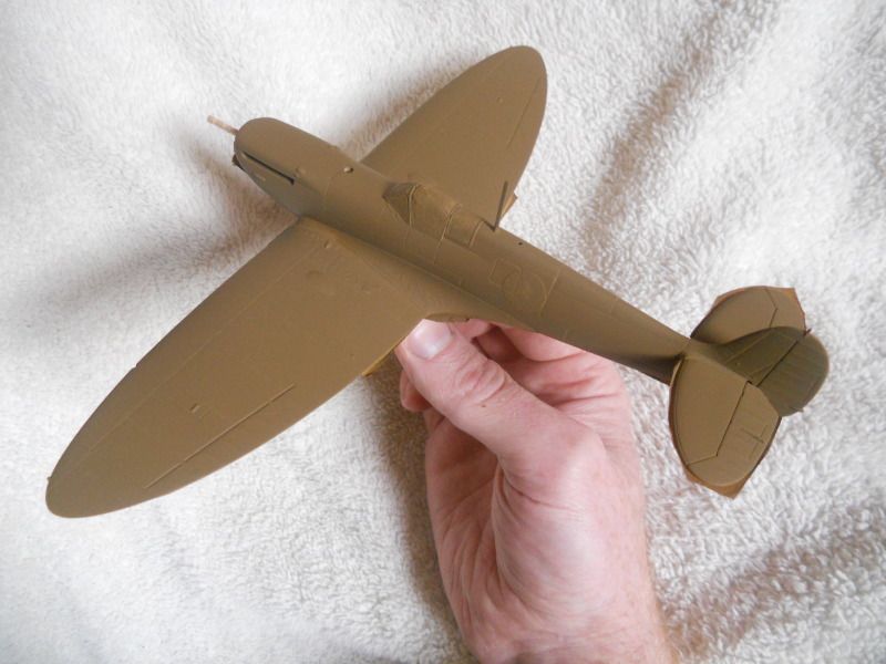

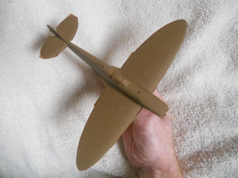

Col. Posted September 27, 2012 Author Share Posted September 27, 2012 (edited) Revell 82 loaded and fired on, Seems to have covered well and gone on smoothly. Drying quick as well so with any luck the green should follow soon. Forgot to say; the wingroots were masked with Winsor & Newton Watercolour Art Masking Fluid. A test on another section showed it didn't react against the Alclad but was a bit hard to control over the smooth silver. Hopefully it'll catch the pattern of scuffs and wear in my reference photos. Edited September 27, 2012 by Col. Link to comment Share on other sites More sharing options...

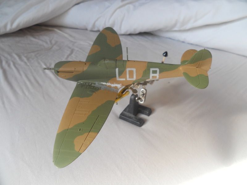

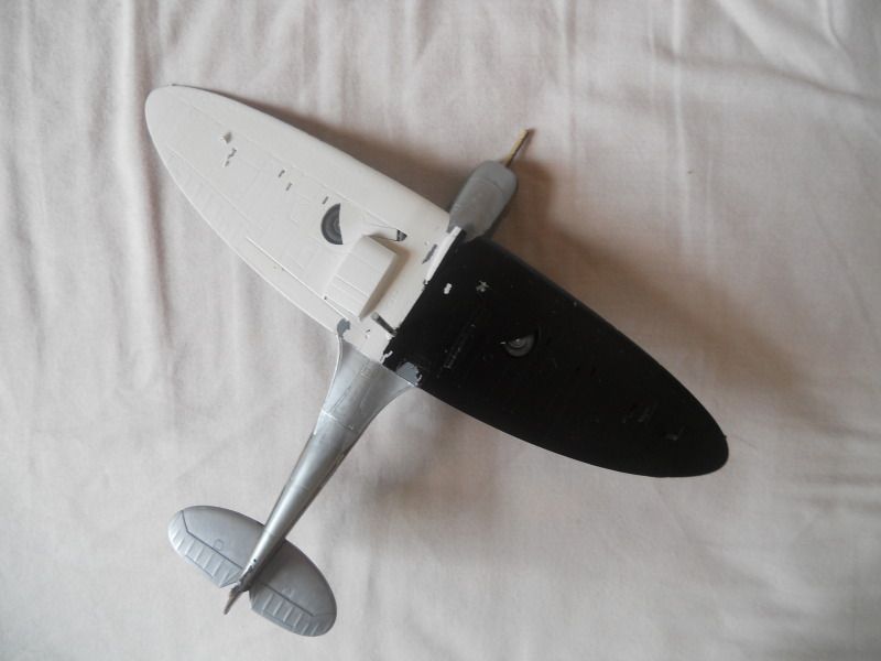

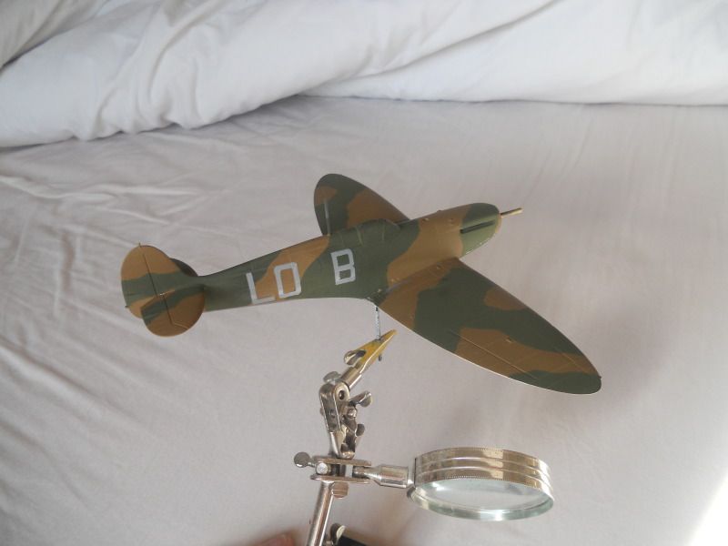

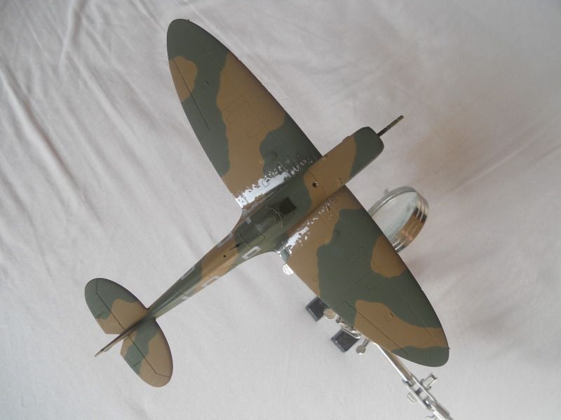

Col. Posted October 3, 2012 Author Share Posted October 3, 2012 Another few colours plastered on, first Revell 65 ( I think, it's been a few days ) then masks cut for the fuselage codes and a blast of Humbrol HX4 from the old Authentics range, happy with the wing root wear, less so when the lower surface masking was removed, Partly tempted to strip and repaint the lover wings but will let it sit for a while and check later. 2 Link to comment Share on other sites More sharing options...
Metallicus Posted October 3, 2012 Share Posted October 3, 2012 Hi Col Looking really good! Pity about the underside, cant you just respray the affected area or would there be a noticeable step? Thanks Brenden. Was looking at your new thread yesterday and look forward to watching your progress. 602 markings for her? Not sure which marking I'm going with yet... I decided to have my first attempt at masking and painting the markings so probably the most simple scheme will be chosen. Cheers Brenden Link to comment Share on other sites More sharing options...

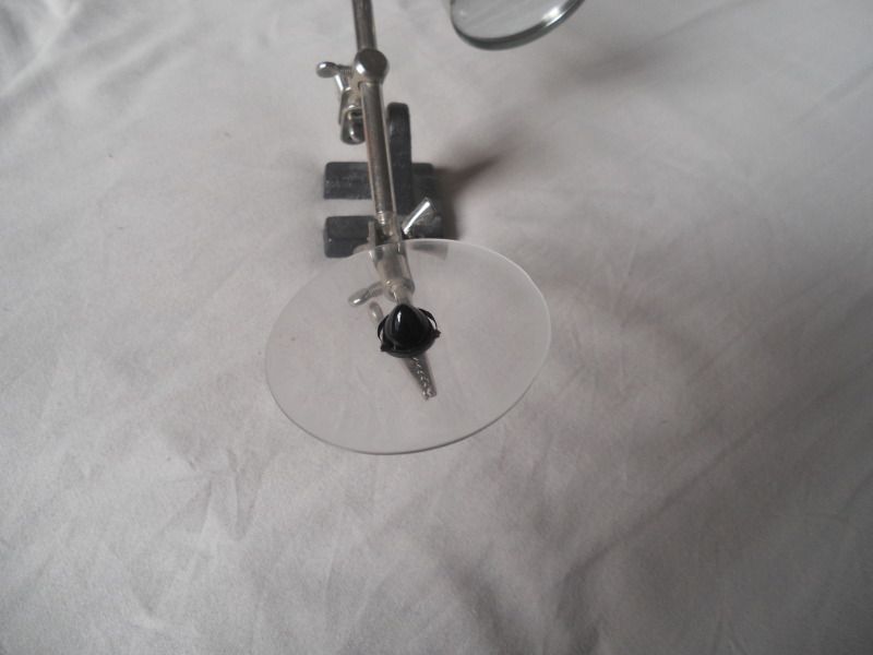

Col. Posted October 10, 2012 Author Share Posted October 10, 2012 Minor update while waiting for more paint to get the roundels done. The undersurfaces are touched in so made the prop from a piece of clear plastic and the spinner painted gloss black to represent the effect of a turning airscrew, Link to comment Share on other sites More sharing options...

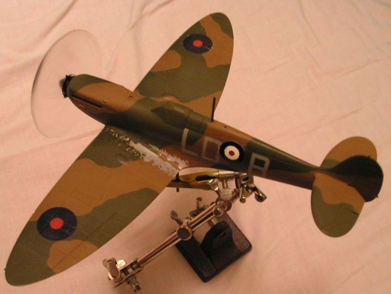

Col. Posted December 4, 2012 Author Share Posted December 4, 2012 Red paint on, masks off; The prop and spinner are only sat on to see how it looks. 2 Link to comment Share on other sites More sharing options...
JMChladek Posted December 4, 2012 Share Posted December 4, 2012 Wow, all these issues you are having with the paint probably would have made me bin my build weeks ago (okay, maybe not, but still it is annoying). I am curious as to if the thinner being used for the Revell 82 might have something to do with it, or perhaps the lack of a primer coat. I am glad to see you are pressing on though in any event. Granted, in my experience if paint is going to peel, a primer coat may not do much anyway as it seems the problem is primarily due with how fast the paint dries. I had the exact SAME problem happen to me when I tried Model Master Gloss Gull Grey acryl thinned with normal Testors acryl thinner on an F-14 Tomcat model. It went down okay, but it pulled up BAD (even over primer) when I masked over it (thankfully I only sprayed the tails with it at the time). I switched to Tamiya acrylic thinner and the stuff went on MUCH better with no compatability issues (I think Tamiya has a mild retarder in their paint to keep it from drying too fast). Perhaps similar thinking might work for the Revell paint as well. It is worth a test anyway. Link to comment Share on other sites More sharing options...
Col. Posted December 4, 2012 Author Share Posted December 4, 2012 So far as I can tell the common factor is the initial coat of white paint; either not sticking to the model or repelling paint from itself. I've no doubt that it's something I've done to contaminate the surfaces but can't for the life of me think what. All I hope for now is the varnish coats go down alright! Link to comment Share on other sites More sharing options...

Col. Posted December 5, 2012 Author Share Posted December 5, 2012 Thanks for showing us this Jennings, great to see at least one of the many escapades of 602 Sqn. pilots and their machines celebrated on a decal sheet, dare say I'll need this when you release it The roundels I measured and extrapolated from a photo of LO-B in David Oliver's Fighter Command 1939-45. The same photo guided my weathering of the wing roots and if there are any wing walkway lines they must be very thin as I can't make them out so have left them off for the moment. Link to comment Share on other sites More sharing options...
Miggers Posted December 5, 2012 Share Posted December 5, 2012 Wasn't that the Heinkel shoot down and subsequent Spit landing where the German pilot, who'd been educated at Oxford,said to Farquar in perfect "posh" English "I say Squadron Leader,that was a bloody awful landing". Col,it sounds like "greasy finger print syndrome" to me mate. A dodge I use is to coat my primer with a thin coat of Kleer before going with my top coats. It barriers against any reaction and gives the top coats something to "grip". Link to comment Share on other sites More sharing options...
Col. Posted December 5, 2012 Author Share Posted December 5, 2012 Pretty certain you're correct on both counts Miggers. In the latter case it's annoying but my own fault due to poor preperation. In reference to the former point I still say a comprehensive decal sheet with a matching booklet covering some of the highlights of 602 Sqn. history would be a wonderful thing. Link to comment Share on other sites More sharing options...
