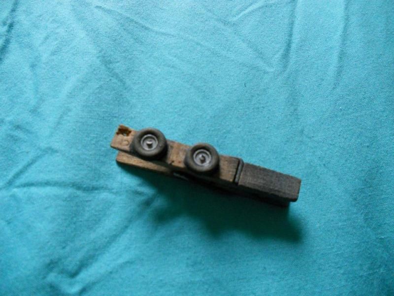

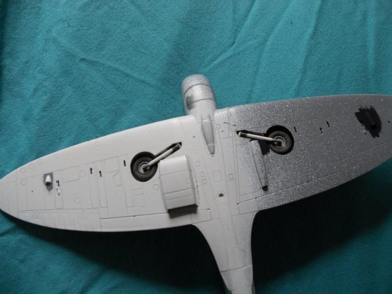

Col. Posted July 15, 2012 Author Share Posted July 15, 2012 Thanks John, I'll get there in the end Almost finished painting and weathering the wheels. Read that both Drem and Abbotsinch were muddy holes so adding a bit of light brown dry-brushing to the lumpy finish left by repainting with Revell matt black: bit of a happy accident that's worked in my favour Once the undercarriage components are on it's almost painting time! Feel I need to sort out a camera and get photos up for greater entertainment value now Link to comment Share on other sites More sharing options...

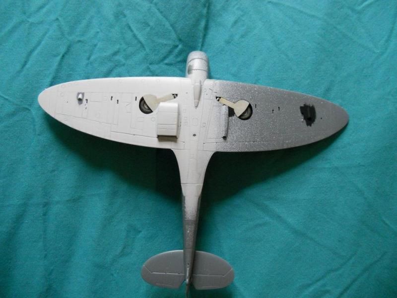

Col. Posted July 15, 2012 Author Share Posted July 15, 2012 Photos! At last. Had some issues getting them uploaded but got there in the end. Muddy wheels... glued in with the false u/c legs on... then new doors added... for a nice flush fit. Link to comment Share on other sites More sharing options...

Col. Posted July 23, 2012 Author Share Posted July 23, 2012 Looking good Col!makes me want to drag my Tamiya kit out of the stash.... I don't have the patience these days to do what you're doing, I'm just happy to get em done! Cheers! John Ah go on John, give it a go, the kit almost falls together and I've plenty spare options from the decal sheet if you want. Good idea replacing that part, something I had not thought of previously! If truth be told it seemed easier to make new parts that modify the kit bits. The added bonus is plenty spares for a future Seafire. Crikey I thought I was slow at moving things forward! I was following this build when I posted my first build on here last year, nice to see it up and running again. If you think this is bad there's a couple projects under the bench that are a lot older! Thankfully it's not a race Nice to see you back at the bench Col! This looks to be a stunner of a build, any chance it'll be along to a club night?Mark. Not sure when I'll next get free for a club night but will take this one and a few others along. What you got on the bench at the moment? Link to comment Share on other sites More sharing options...

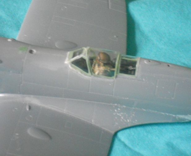

Col. Posted August 13, 2012 Author Share Posted August 13, 2012 Back to this one after finishing the A6M2b. More research has turned up a likely candidate my grandad would have spannered and this gave me a burst of enthusiasim late last night. The result was the final part to finish the cockpit and get the canopy closed, The 'ears' of the canopy release mechanism. Link to comment Share on other sites More sharing options...

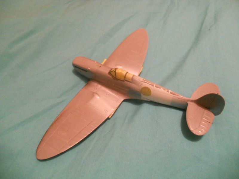

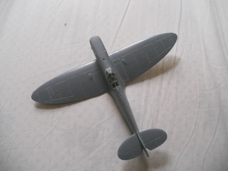

Col. Posted August 16, 2012 Author Share Posted August 16, 2012 Got a little free to myself this evening after Iona went to bed so fitted the canopy. Needed a tiny amount of plastic sanded off around the lower leading edge but that was likely do to my ham-fisted attempt at fitting the windscreen. Have to go through the paint stash and look for a suitable brown and green soon I suppose... Link to comment Share on other sites More sharing options...

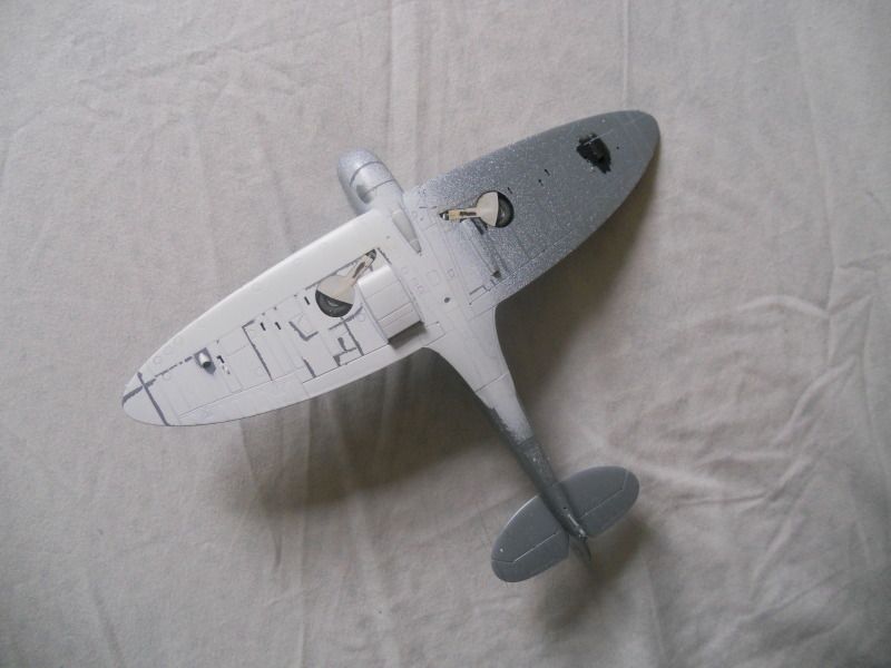

Col. Posted August 19, 2012 Author Share Posted August 19, 2012 Was looking at your work as well dadgaddad and you are making impressive progress. Spent the last few days doing a little more research so that came to fruition this evening when I gave the wing panels the same treatment I'd used on the fuselage. Scraped a little plastic away from behind and inside each engraved panel line in the hope it better represents the overlapping construction. Don't have enough light to take a photo and am ready for bed so hopefully post something tomorrow. Link to comment Share on other sites More sharing options...

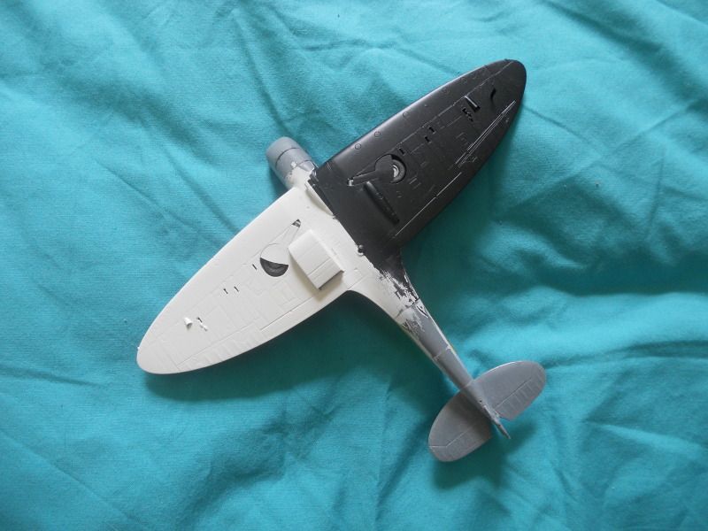

Col. Posted August 22, 2012 Author Share Posted August 22, 2012 (edited) Aye, aye Col. Hiv ye nae got this finished yet min? Its aboot time ye got a lick o piant on it. Steve Aye aye Steve, fit like? Nah nae done yet but jist aboot ready to yoke the piant. Spent oor lang looking at fit piant to lick on and far. Here's a couple photos of the wing detailling I was going on about in the last update. Not sure how clear it is but hopefully the old white on the underside will show it better, Edited August 22, 2012 by Col. Link to comment Share on other sites More sharing options...

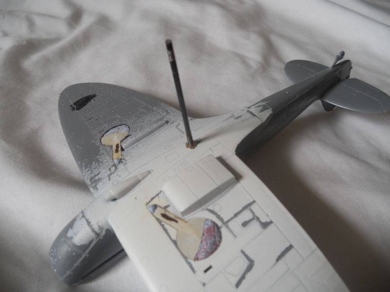

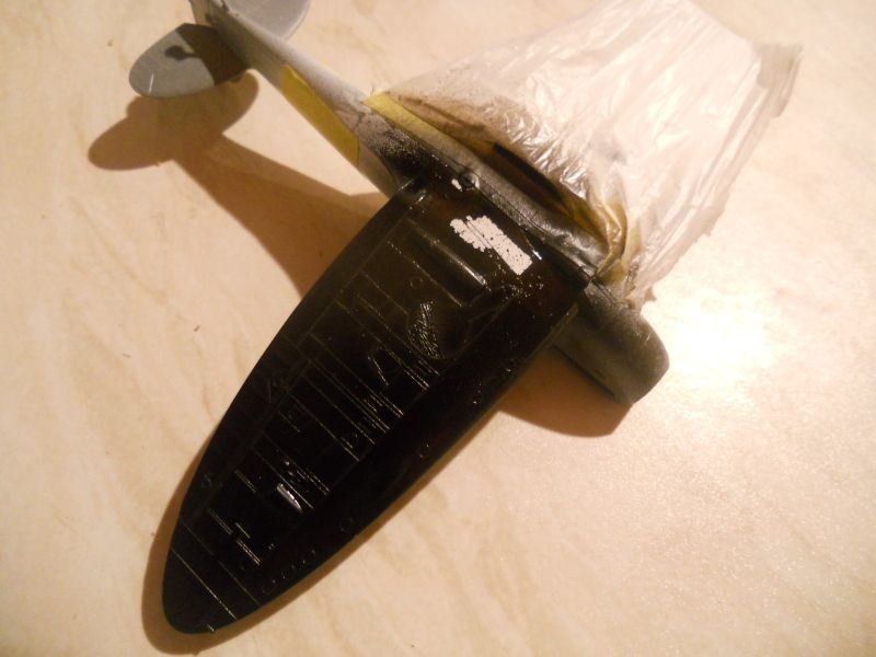

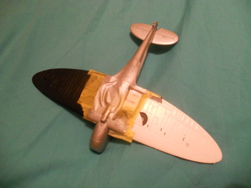

Col. Posted September 26, 2012 Author Share Posted September 26, 2012 (edited) Slllloooowwwww work in progress at this one but at least it's progress I guess. Made the modifications for a display stand using an old bicycle spoke and nipple. The brass nipple was cut down and epoxy glued into a hole drilled where the light was moulded and this then allows the spoke to thread in. Makes a good place to hold her while painting as well... On the subject of painting we have minor disaster No.1, after a little light swearing and a rub down it got better, then some Alclad Aluminium was put in the airbrush and waved in the general direction of a Tamiya Spitfire. Now just prior to that moment I was think how, during a previous life working in the automotive industry, I'd seen paints of different types react with each other and result in a strange wrinkling effect - yet Alclad cellulose paint was recommended to be layered over an enamel base coat. Well, guess what happened next, minor disaster No.2 The whole lot had to be striped off and a second attempt was made. To much the same effect. A little more light swearing and the third attempt produced acceptable results, Not perfect but lets call it weathering. Did the wing roots as well since the photos I'm working from show even a relatively new machine with plenty boot scuffs wearing the paint away in that area, As you can see I've also masked off a white area on the fuselage for the roundel. Think I will have a go at painting the markings on this one due to a lack of some suitable decals to cover the unusual roundel dimensions as well as the main codes for the machine I want to represent. Dare say more light swearing will occur... Edited September 26, 2012 by Col. 1 Link to comment Share on other sites More sharing options...
NickR Posted September 26, 2012 Share Posted September 26, 2012 Good stuff Col - I think it is one of the more frustrating parts of this hobby when paint doesn't do what you want it to! Link to comment Share on other sites More sharing options...
