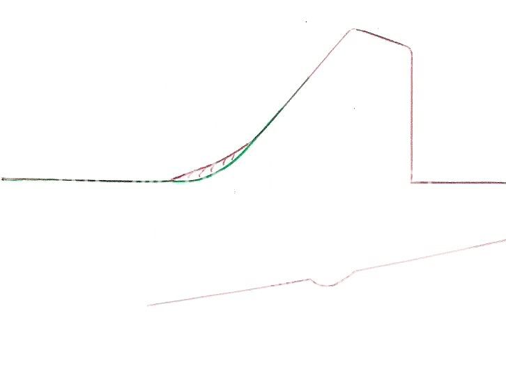

canberra kid Posted May 25, 2011 Share Posted May 25, 2011 (edited) Nice Hawk! not a Canberra though One big thing with all the Airfix 1/48 Canberra's is the leading edge on the fin, it extends to far so needs chopping back and re-profiling, not a big job. The other things are the tail planes they should be strait all the way up to the fuselage but they aren't you can get replacement resin parts to address boath these issues. The opening for the cockpit should be round not the shape of the canopy! You will need to add the landing light on the underside of the port wing, another easy job, still under the wing Airfix missed the air brakes, not so easy to re scribe (don't tell any one but I've never bothered) The Ailerons need trim tabs. If you are replacing the seats use Aeroclub seats AJ420 for me the best representation of the Canberra seat around, they should be Mk.1cs but 2cs is fine there's not a huge difference check out the Canberra seats on my site. There may be more but that's all I can think of for now! John Edited May 26, 2011 by canberra kid Link to comment Share on other sites More sharing options...
