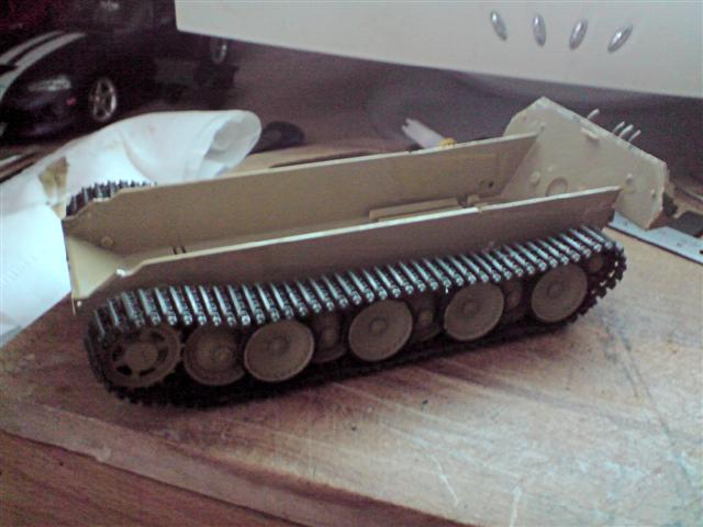

bruce3371 Posted May 10, 2011 Author Posted May 10, 2011 Here's the 1st set of pictures of my 'Tank Refurbishments'! The 1st thing I needed to do was to gently pry apart the two halves of the hull, this gives me access to the lower hull. While I'm doing this, I've taken the opportunity to recreate the familiar 'track sag' found on German WW2 Heavy Tanks. My method for doing this is really simple, I tie the top section of track to the road wheels using black cotton thread! Next is the hard part; the sponson plates. I'm going to use some of the advice given in this thread, and first make some cardboard templates which I'll use to measure pieces of styrene sheet. More pictures to follow
FalkeEins Posted May 10, 2011 Posted May 10, 2011 My method for doing this is really simple, I tie the top section of track to the road wheels using black cotton thread! ..before glueing the hull on presumably...although I can't see how you do that with your fingers ..or do you use tweezers? anyway sounds like a neat tip ..thanks!
bruce3371 Posted May 10, 2011 Author Posted May 10, 2011 ..before glueing the hull on presumably...although I can't see how you do that with your fingers ..or do you use tweezers? anyway sounds like a neat tip ..thanks! Yes, before the hull top is glued back on! As I mentioned in my 1st post, I'm doing this retrospectivley on some old tank models that were built ages ago, when my skills weren't what they are now, which is why I had to pry the top off! I still have to do the sponsons plates before the top goes back on! And yes, I tied the cotton thread with my fingers! Admittedly it was quite fiddley threading it through the gaps in the track, and this method seems to work better on German heavy tanks, because the overlapping wheels help to hide the thread.

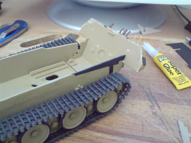

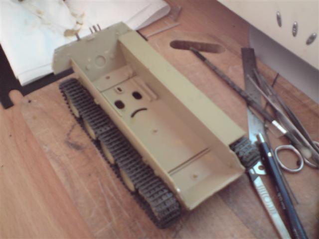

bruce3371 Posted May 24, 2011 Author Posted May 24, 2011 (edited) I've made a bit more progress on my 1st 'refurb' project. I've filled in the odd gaps in the rear of the lower hull side, and added the 1st of the spnoson plates. I used old DVD cases, cut up, to provide the styrene sheet for the modifications. Now I'm a bit stuck. Can anyone tell me if the sponson plates follow the contour of the sides of the hull top at the rear, or are they flat, with the sides of the rear top overhanging? [edit]Once I've finished the sponson plates, I need to fill in those horrible holes in the lower hull, which were left over from when these were more toys than scale models, and could have motors fitted :-S[/edit] Edited May 24, 2011 by bruce3371
alanmac Posted May 24, 2011 Posted May 24, 2011 Hi Yes stowage boxes I believe, so you have to follow the shape as it goes down and then towards the back. Alan
bruce3371 Posted May 24, 2011 Author Posted May 24, 2011 HiYes stowage boxes I believe, so you have to follow the shape as it goes down and then towards the back. Alan Ok, thanks for that, that's what I thought, but wanted to make sure
