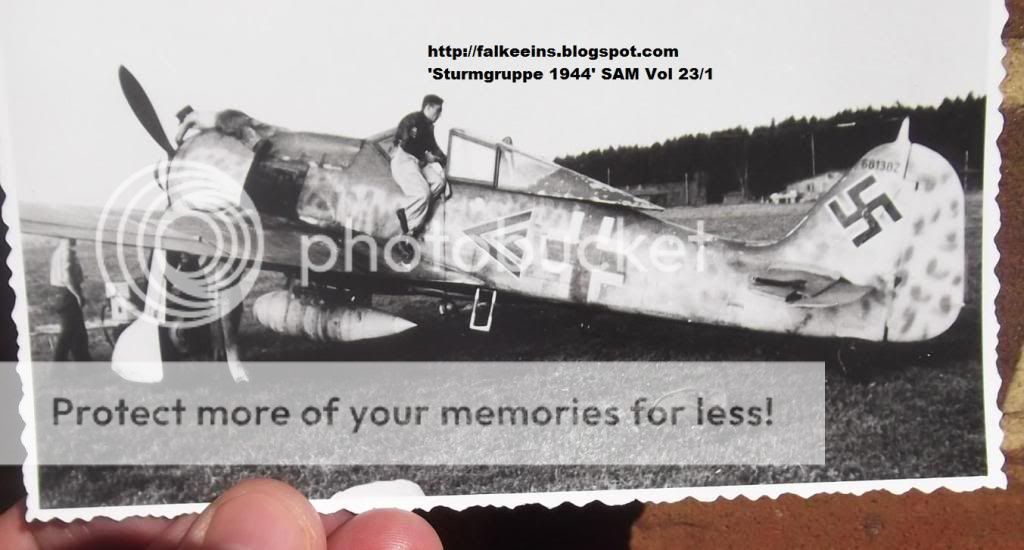

rowmk9 Posted May 7, 2011 Author Posted May 7, 2011 Ooh thanks very much indeed! the bottom one in particular is the aircraft in the exact scheme I'll be doing.

FalkeEins Posted May 10, 2011 Posted May 10, 2011 here's a better view of the pic in post #7. With the kit decals you could also do Moritz's earlier Sturmjäger (July 44) with the black cowl and rear fuselage band..
