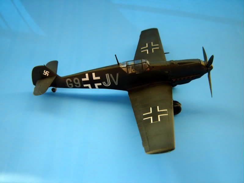

SoftScience Posted April 20, 2011 Share Posted April 20, 2011 I built the Academy and ICM kits, and must suggest the ICM kit. It is as detailed as the Tamiya offerings, but at a fraction of the price (at least in the US). The fit is good, but the decals are only so so. I suggest going with aftermarket. Here is mine, straight out of the box Link to comment Share on other sites More sharing options...
