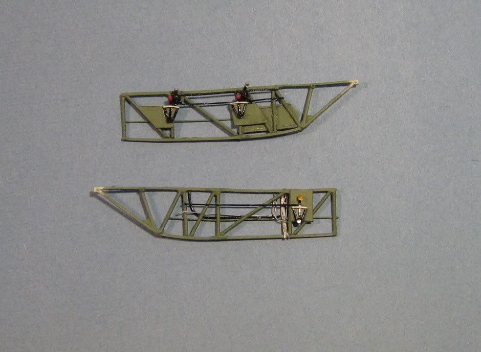

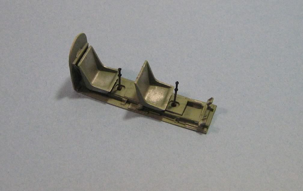

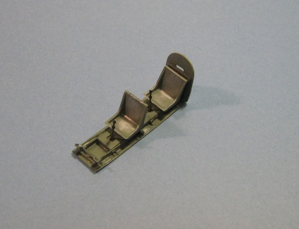

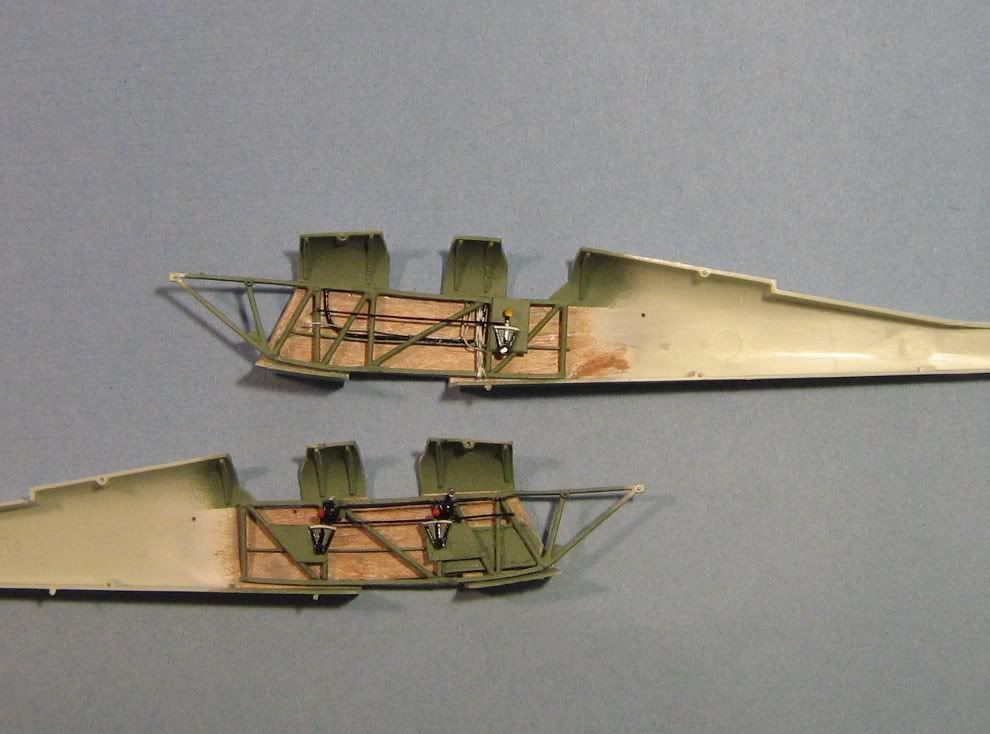

hacker Posted April 27, 2011 Author Share Posted April 27, 2011 here is the cockpit floor and seats dry brushed and weathered. l got a set of RB Productions Sutton A belts coming so the seats can not be attached until l get those installed also detailed the sides last night too while it was quiet here had to put then in the fuselage halves to see how they looked Last night l start to attach the right side to the floor and realized that l am short in the front and the firewall won't fit so some modifications are in order. seeing that it is somewhat hidden l am going to cut off the engine bearers then attach the firewall then attach the engine bearers to it and that should solve my problem. l can not but it all together as l had said above l have to wait until my Sutton harnesses arrive in the mail that is all for a bit until then later 2 Link to comment Share on other sites More sharing options...

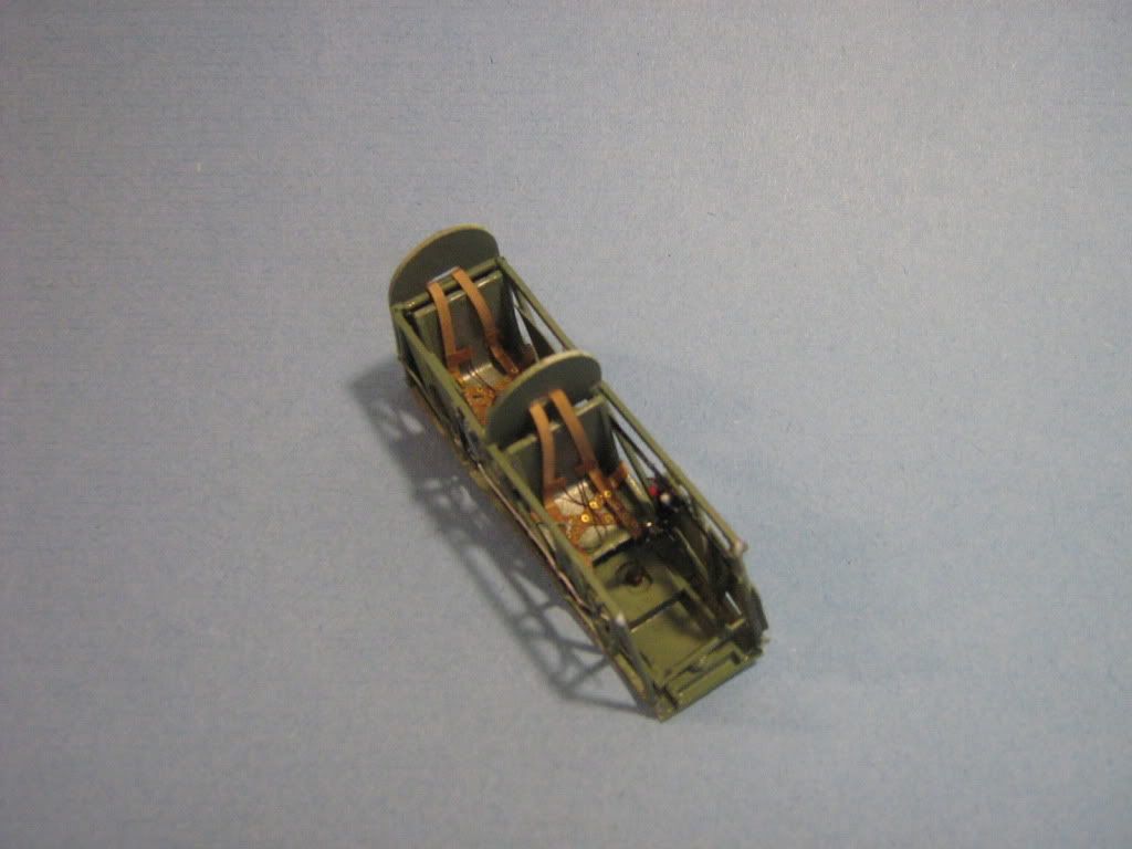

hacker Posted June 6, 2011 Author Share Posted June 6, 2011 Well this weekend l assembled the Sutton A harness for my Tigermoth using the magnifying glass in my desk lamp to see all these very tiny parts. I am now officially blind !! But the results are well worth it!! I now have to move on to the instrument panels as they are accurate but needs some added detail. That is all for now later 2 Link to comment Share on other sites More sharing options...

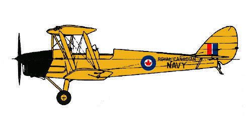

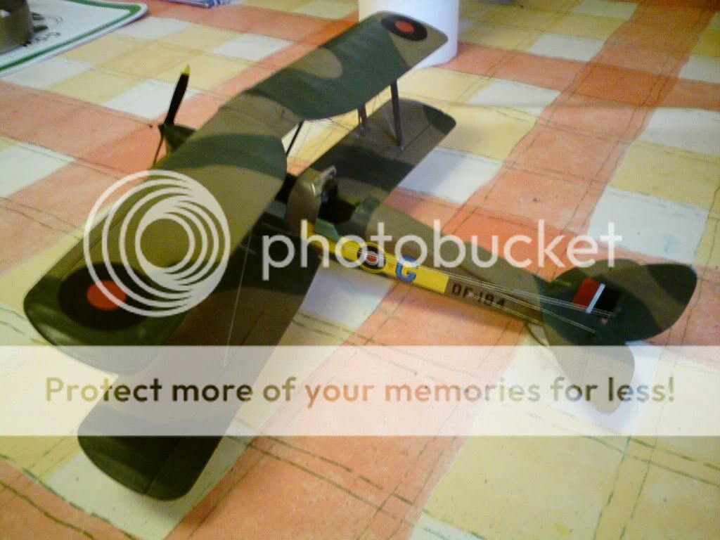

hacker Posted June 9, 2011 Author Share Posted June 9, 2011 Got some more work done on this but it is not ready for posting just yet (needs paint) but l have been debating about paint schemes for this plane still, either a aluminum dope RN aircraft or dark earth/dark green over trainer yellow like on the box but slightly different or this one but l am still not sure. What do you guys think? I want to go with a military scheme 1 Link to comment Share on other sites More sharing options...

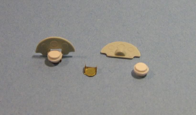

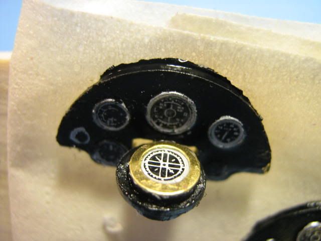

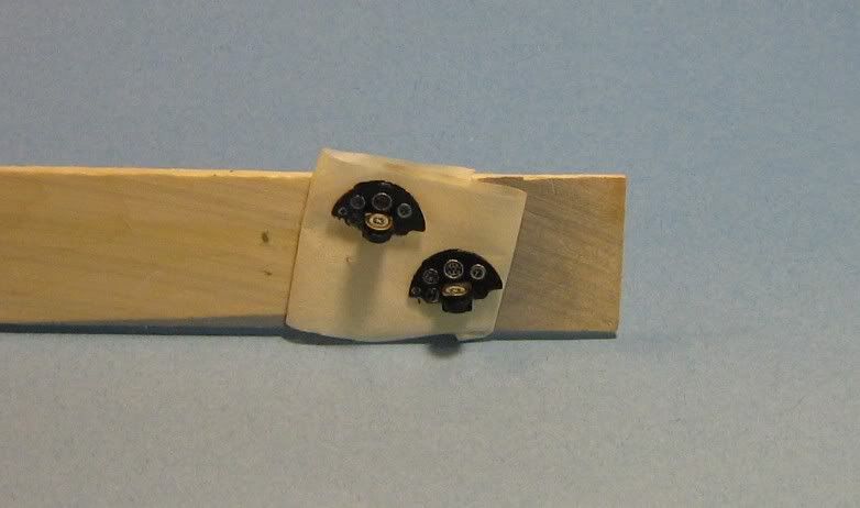

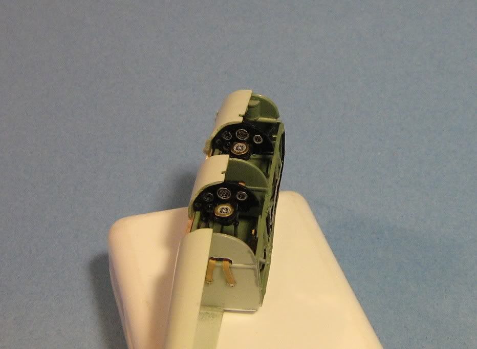

hacker Posted June 10, 2011 Author Share Posted June 10, 2011 Well l got my Airscale Generic WW2 Dial decal sheet and proceeded to do the instrument panel after all that work on the cockpit putting in the kit version of the would be shameful at least to me. Here is the modifications I did to one compared to the other and the parts After assembly l painted them satin black. After l painted the bezels silver I punched out some white decal film to put in the instruments just in case. Once that was done l used the appropriate instruments. The using some thin brass shim material l punched out some bezels for the compass I dare say came out not too bad. Now to there all of this into the fuselage halves. Wish me luck later 1 Link to comment Share on other sites More sharing options...

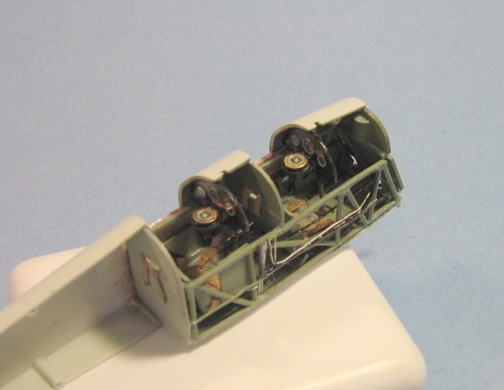

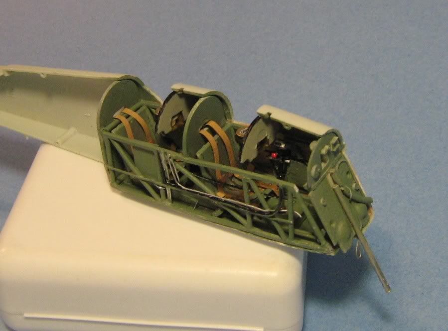

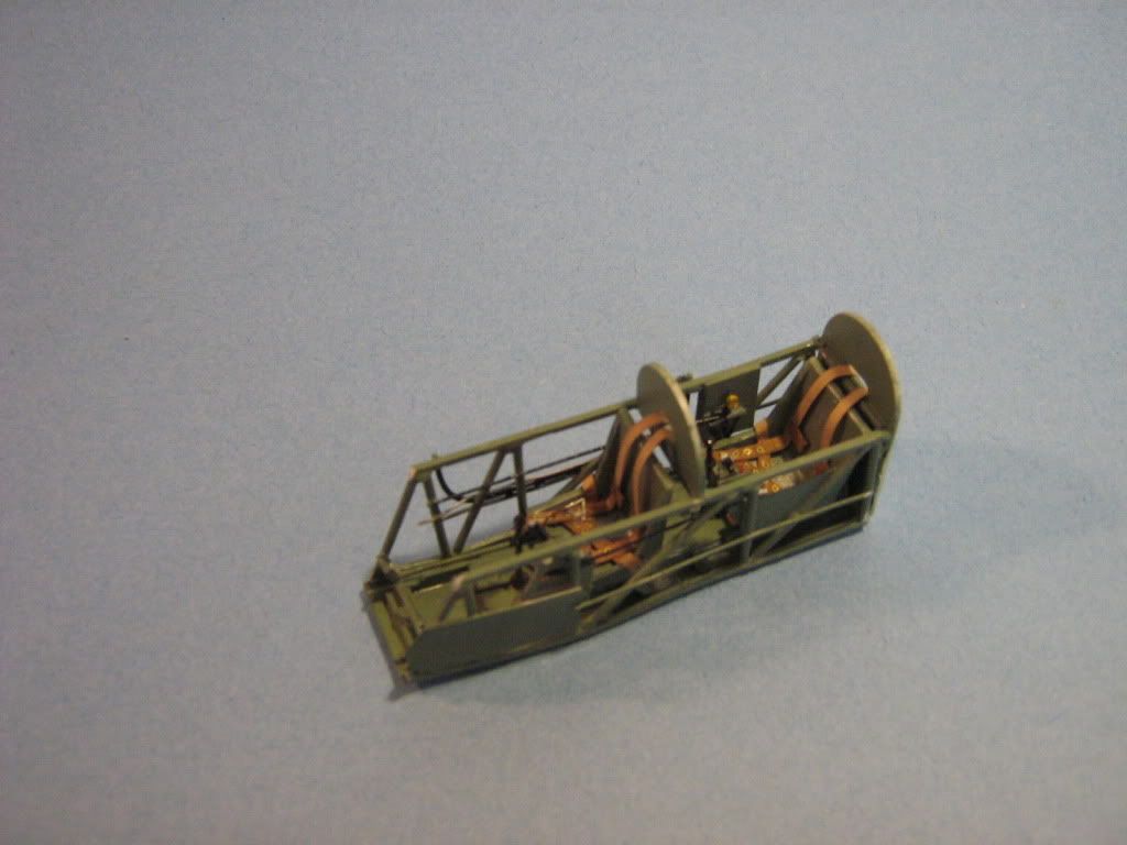

hacker Posted June 11, 2011 Author Share Posted June 11, 2011 Well some more progress on the Tigermoth. l got the cockpit glued in and about to close it all in but l thought l would take a picture of it before l did. I also got the wings glued together so the decision about what to paint is coming to a head quickly. I better make up my mind ok that is all for now later 2 Link to comment Share on other sites More sharing options...

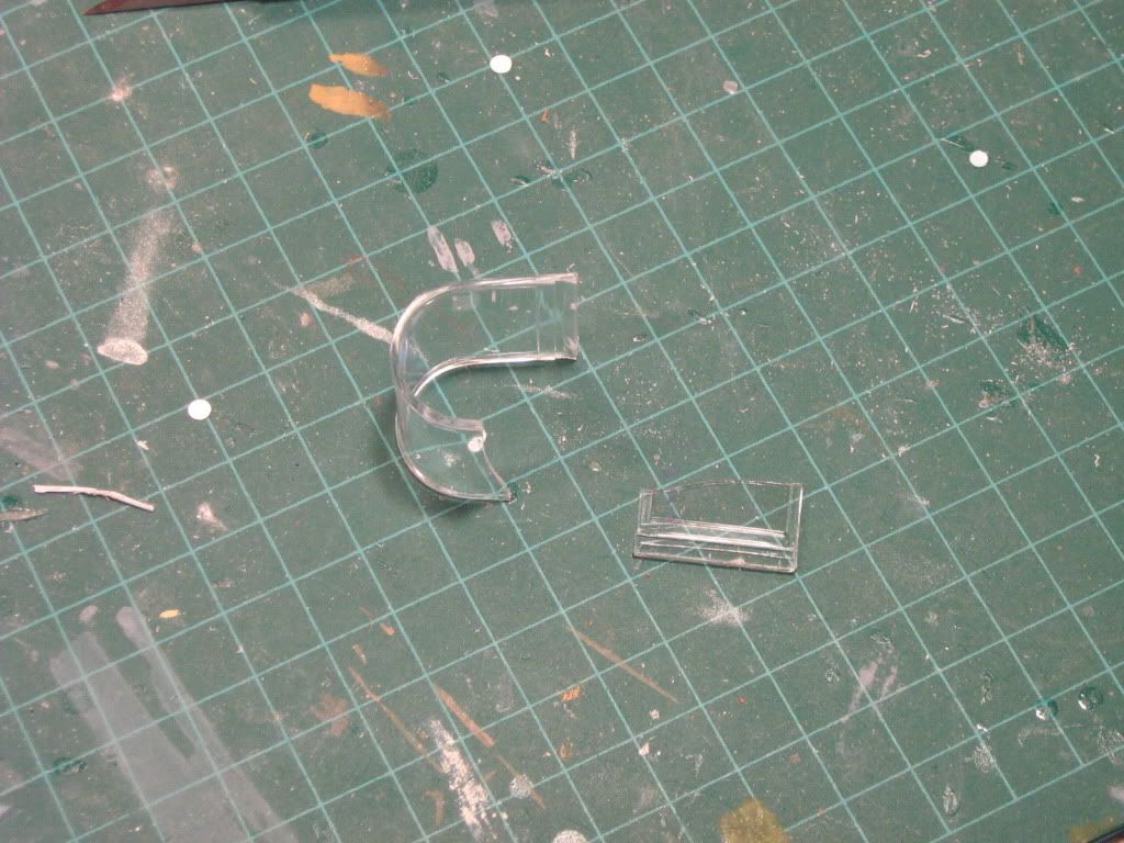

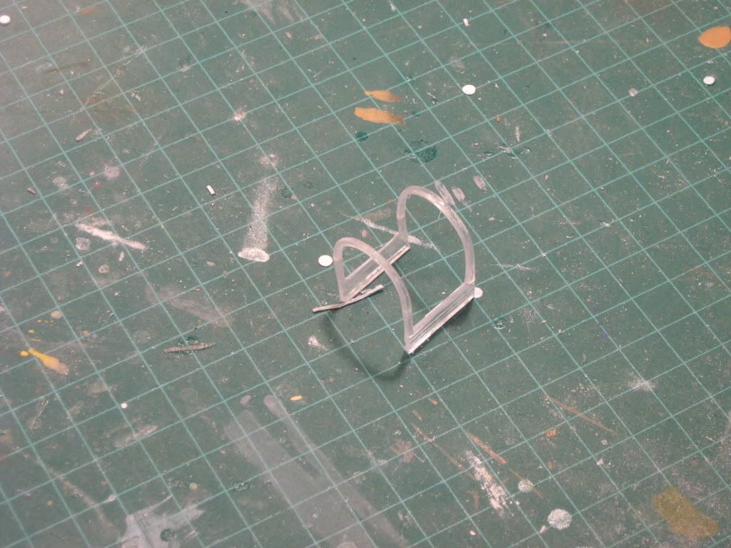

hacker Posted June 21, 2011 Author Share Posted June 21, 2011 (edited) Well what scheme l am going to do this in became academic as the clear parts for the winterized canopy is broke and l do not have a replacement. So the question l am putting here to you guys is to do a BCTP aircraft in Canada did they used the canopy all year round but only in the winter? Edited June 21, 2011 by hacker 1 Link to comment Share on other sites More sharing options...
Col. Posted June 22, 2011 Share Posted June 22, 2011 Nice work Hacker. Personally I'd go with the aluminium dope RN machine as the single overall colour will show the nice lines of this machine and that scheme is not often seen. Link to comment Share on other sites More sharing options...

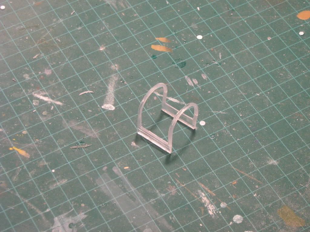

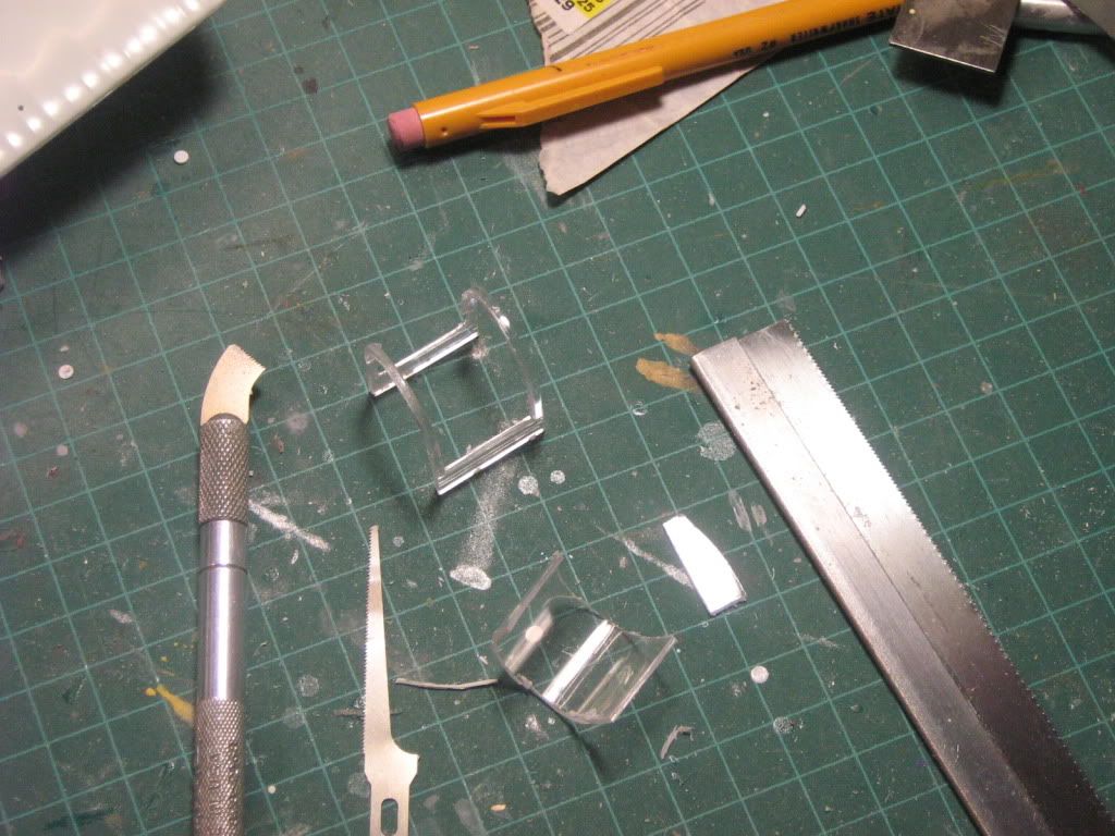

hacker Posted June 22, 2011 Author Share Posted June 22, 2011 (edited) Nice work Hacker. Personally I'd go with the aluminium dope RN machine as the single overall colour will show the nice lines of this machine and that scheme is not often seen. Thanks I had thought about that but going with a Canadian bird. Speaking of which while stewing over my dilemma with the broken canopy a thought came to mind. Seeing that it is pretty much square what if l just cut out the broken glass and glue the frame work back together and put a new window in? Seeing the wife works nights l got up to see what could be done here is the broken canopy as l found it in the separate bag. using my razor saw and my PE saw set from RB Productions (by the way very highly recommended for this and cutting out panels and such) l cut the glass out once l cut that out l super glued the frame work together and let cure over night. This morning l filed and sanded it until l got this. Now the question is how do l attach the clear plastic to it without it fogging or being distorted?? Got any suggestions? I have gator glue wondering if that would work? in the meantime l have the fuselage halves glued together now l am in the process of adding some bits to it so l can prime it and see what my mistakes are Anyways that is all for now later Edited June 22, 2011 by hacker 1 Link to comment Share on other sites More sharing options...

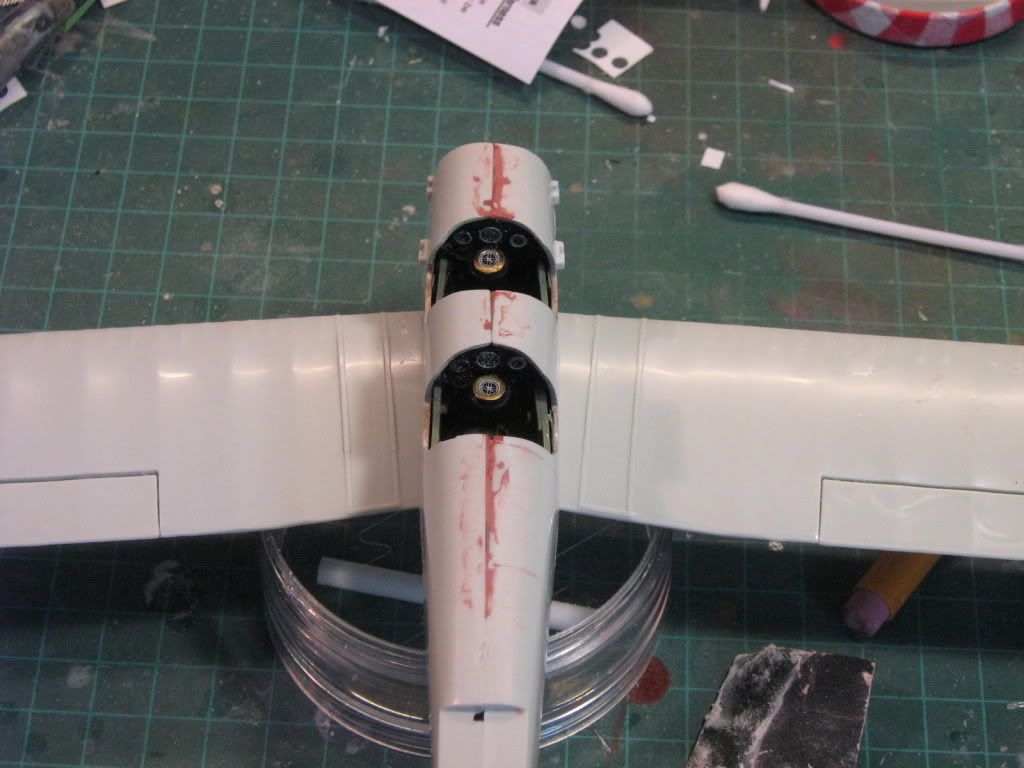

hacker Posted June 26, 2011 Author Share Posted June 26, 2011 hacker,It is extremely lovely to follow your thread.. The smaller parts are gelling together and it is coming together quite beautifully. Neat work and good updates. interesting and informative and not boring at all. Coming along nicely...looks great. Thanks for the vote guys. been doing some sanding and l am about to prime the fuselage to check for errors but the wife wants to spend time together (would not you if you had my wife lol) Link to comment Share on other sites More sharing options...

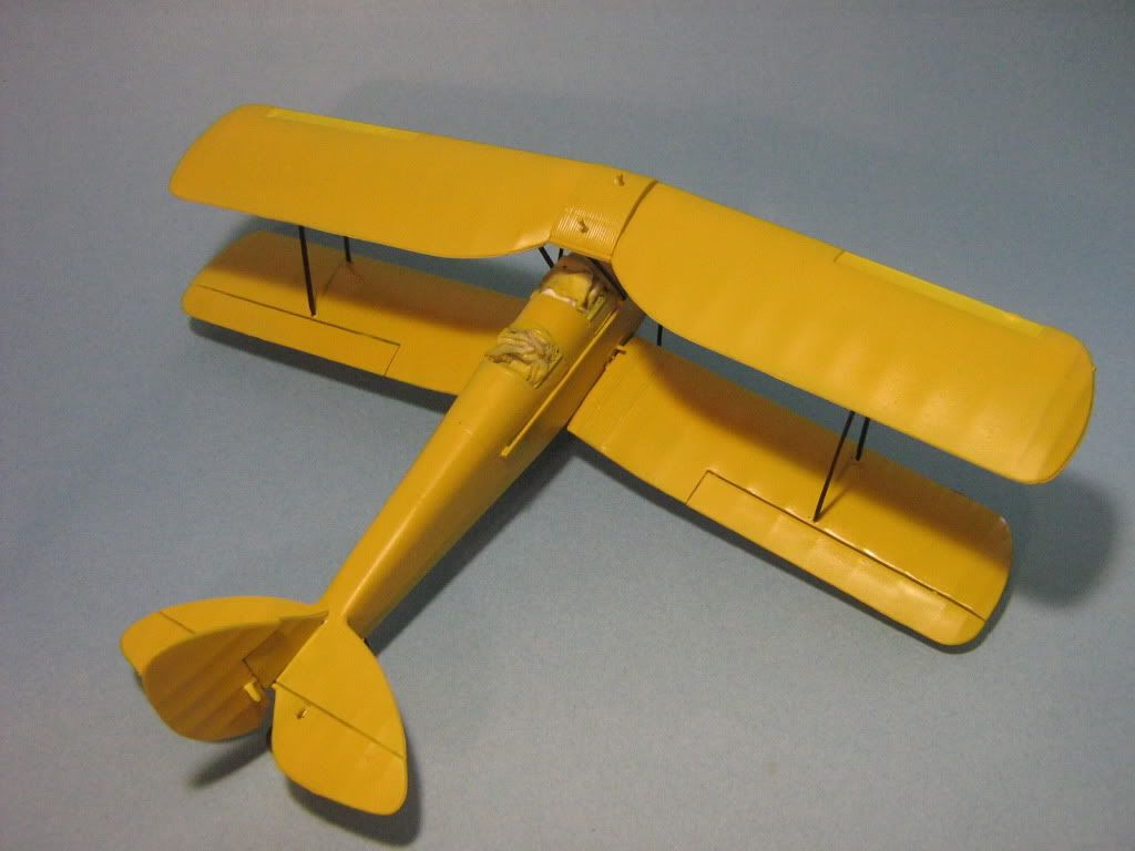

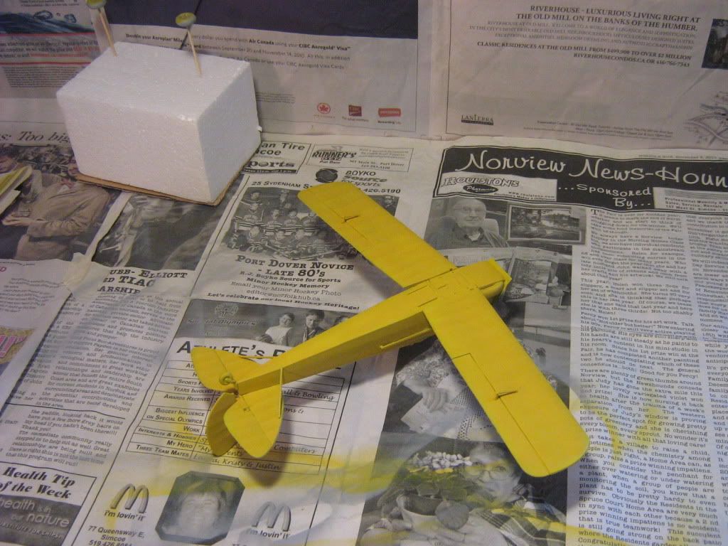

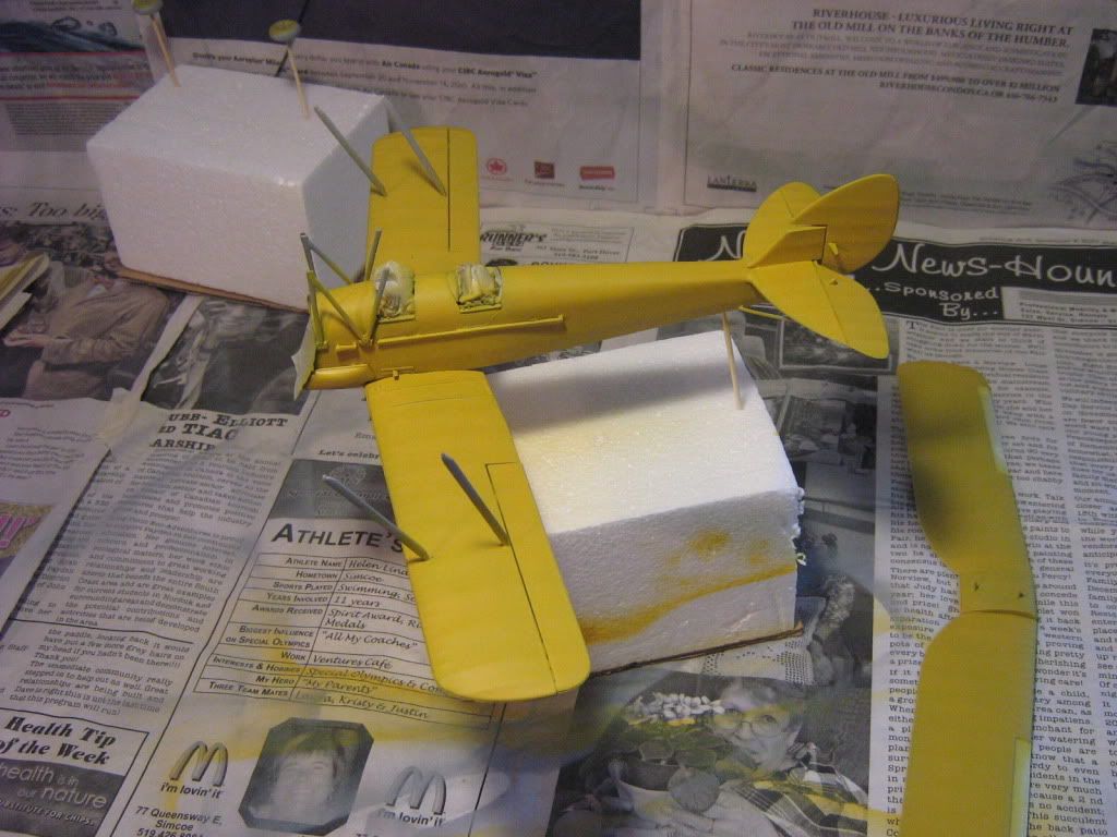

hacker Posted August 18, 2011 Author Share Posted August 18, 2011 (edited) short update while trying to put the thinner wing struts on l found one of them broken. Dam!!!. l was going to put on two of the wider ones but then while searching my spare parts draws l found two yellow struts that l believe came from a Lindburg 1/48 kit. Low and behold they were the same size shape and thickness. once l glued those on and the rudder it was time to paint. Here is the Tiger Moth with one coat of Floquil grey primer and two coats of Humbrol 24 trainer yellow. It is still the closest colour to the RAF/RCAF yellow used on all the BCTP aircraft There will be more as l am currently painting the upper wing later Edited August 18, 2011 by hacker 1 Link to comment Share on other sites More sharing options...
FZ6 Posted August 18, 2011 Share Posted August 18, 2011 Looking good, The cockpit looks much better than it does straight from the box. The Yellow looks flawless too. Every time I see the work done on yours it makes me want to get out the one I've started and progress it further. Link to comment Share on other sites More sharing options...

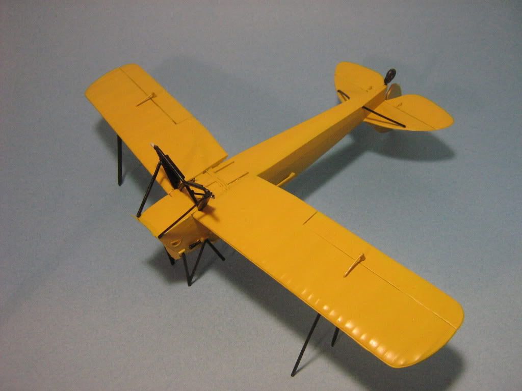

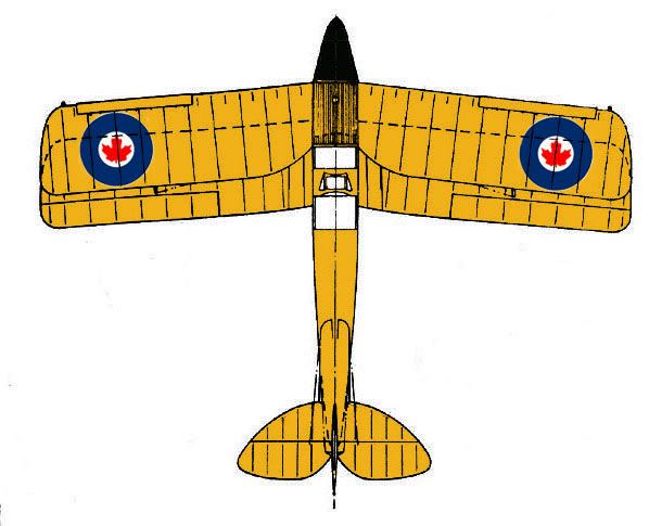

hacker Posted August 20, 2011 Author Share Posted August 20, 2011 short update: I put one more coat of Trainer Yellow on the Tiger Moth and then l painted all the landing gear and struts black. Then l attached the landing struts to the plane. here is what it looks like now. Thinking needs another coat of future before l decal. Still debating to do either a BCTP Moth from Hamilton Ontario or do the RCN version both having the same paint scheme. I have to come up with the RCN roundels yet. Just for fun l put the top wing on just to see how it looks. That's all for now later 1 Link to comment Share on other sites More sharing options...
geedubelyer Posted August 20, 2011 Share Posted August 20, 2011 Looking great Hacker To me, that's exactly the right colour scheme for a Tiger Moth. Link to comment Share on other sites More sharing options...
Iain Ogilvie Posted August 20, 2011 Share Posted August 20, 2011 Looking ace so far! Iain Link to comment Share on other sites More sharing options...
AnonymousAA74 Posted August 20, 2011 Share Posted August 20, 2011 Yellow is a bitch to spray properly, so great job there Hacker. I build this as a kid and hand-brushed the lot in yellow!! Link to comment Share on other sites More sharing options...

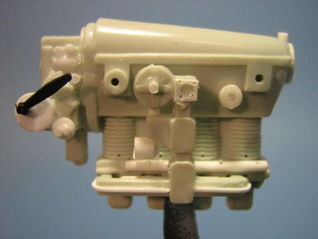

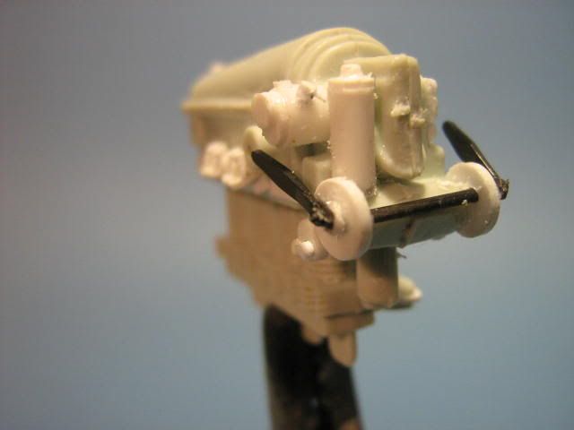

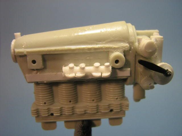

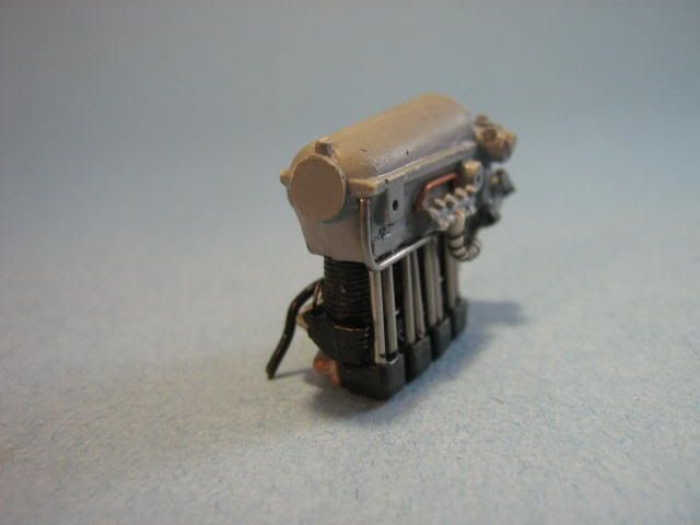

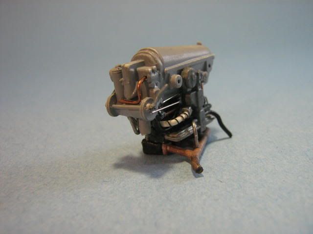

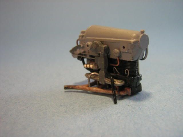

hacker Posted August 25, 2011 Author Share Posted August 25, 2011 l moved on to the engine for this build. All in all the engine is pretty good as a basic shape but lacked detail so seeing l am going to have the cowl side panels opened l needed to add some details First l added some bits and bobs of plastic to it in an effort to bring it to life. Mostly spruced up air intake manifold and the rear I then painted the cylinders flat black and the rocker arm covers gloss black. The engine block was painted a gloss grey. I replaced the molded on push rods on the rocker arm covers with stainless steel as it would make it look the part better. The rest l detailed it with bits of soldier,copper wire and black wiring. The exhaust l painted first with Testors steel then dried brushed it with rust and flat black. This took me all week just to build It may not be perfect rendition of the real thing but l think it is better then what l had to start with. ok that is all for now Later 3 Link to comment Share on other sites More sharing options...
bigbadbadge Posted August 25, 2011 Share Posted August 25, 2011 Wow, stunning work so far looks great. Thanks for sharing All the best Chris Link to comment Share on other sites More sharing options...
shark 64 Posted August 27, 2011 Share Posted August 27, 2011 Very nice I love yellow. Cool work on engine. Oliver Link to comment Share on other sites More sharing options...
hacker Posted August 27, 2011 Author Share Posted August 27, 2011 Wow, stunning work so far looks great. Thanks for sharingAll the best Chris Very nice I love yellow. Cool work on engine.Oliver Thanks guy still have a bit to go on this but l am getting her done Link to comment Share on other sites More sharing options...
Lynx7 Posted August 27, 2011 Share Posted August 27, 2011 Looking lovely, mate. I know what youre going through with the Gypsy cos I became intimate with mine when building my 48th Chippie! Link to comment Share on other sites More sharing options...
