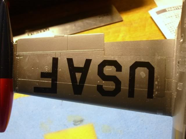

AdriaN (MLT) Posted April 12, 2011 Author Share Posted April 12, 2011 (edited) Ok experiment done. Im not too happy! Tell me if i did it right: I applied setter onto surface. placed decal. let it dry for a minute then pressed down using a cotton bud. decal didnt crinkle or anything. it did stick down, but not totally! i then applied softner... NO crinkling or anything as you guys stated! I then pressed down on it using a cotton bud. stuck down nicely over bumpy areas & panel lines. I applied it again and left it. Am i supposed to apply the solution and leave it alone? or do i apply and "work it" in? (for both solutions) I am disappointed to find the solution left behind a white mark. is it some reaction with Klear? i touched the marks with my nail and it felt very soft. its either the Klear melting or the glue in the setter? or solvent in softner? will it dissappear? Edited April 12, 2011 by AdriaN (MLT) Link to comment Share on other sites More sharing options...
Peter Marshall Posted April 12, 2011 Share Posted April 12, 2011 Sounds as if you have used it correctly - a couple of points. First - one you put the softner on DON'T TOUCH THEM - it doesn't act instantly and on thick decals it can take a while (overnight is good), but once it starts working the decals get very soft and tend to tear. The setter 'pull's decals down as it dries, you don't see the effect of that immediately either, but in combination with the softner has a habit of pulling them over the decals. The white mark is generally caused by a pool of the Setter / Softner on the klear, you only need a little. Once it's all dried fully spraying a bit of klear over it should fix it. HTH Link to comment Share on other sites More sharing options...

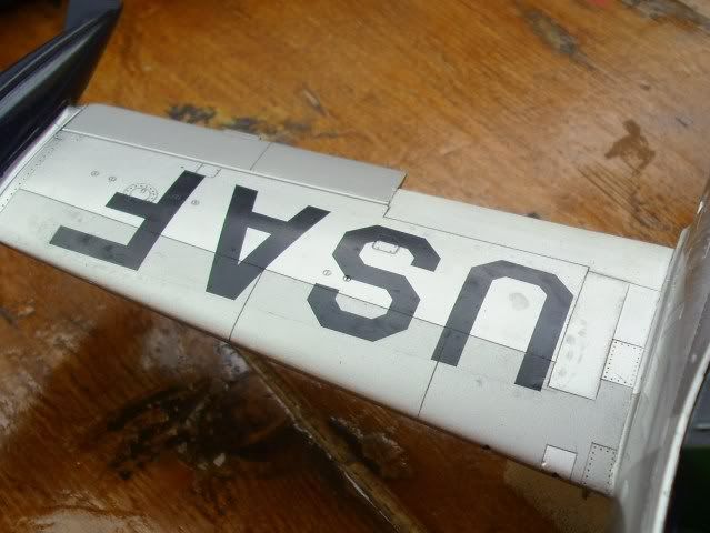

AdriaN (MLT) Posted April 12, 2011 Author Share Posted April 12, 2011 Ok first real decal down. im happy with it. it settled really well. i put softner on around 3 times. when it almost dried I started pressing down on it with a brush to get it in the panel lines. it didnt tear or melt. but on the second application it did wrinkle.. but that went after an hr or so.. Ooh yes and the white marks/stains left when it dried maybe next decal i should apply and leave it alone?? I wonder if it got down nicely because i pressed down on it? Link to comment Share on other sites More sharing options...
xlpainter Posted April 12, 2011 Share Posted April 12, 2011 Ok first real decal down. im happy with it. it settled really well. i put softner on around 3 times. when it almost dried I started pressing down on it with a brush to get it in the panel lines. it didnt tear or melt. but on the second application it did wrinkle.. but that went after an hr or so..Ooh yes and the white marks/stains left when it dried maybe next decal i should apply and leave it alone?? I wonder if it got down nicely because i pressed down on it? Do not touch the decal once the softener has been applied just walk away from until dry Link to comment Share on other sites More sharing options...
AdriaN (MLT) Posted April 13, 2011 Author Share Posted April 13, 2011 (edited) Ooh yes and the white marks/stains left when it dried Following what i said yesterday. Well basically my *ss marks left! I stuck on a big USAF decal. When i came back later i found it left behind white marks. i tried cleaning it with water, didnt leave Also when i apply softer it beads up as it begins to dry and it leaves behind patches over the black parts, almost like i dropped acid on it. funnily enough it only happened to this big decal. others are ok. White marks are visible in both photos. On both the transperant parts of the decal AND the wing. On the black lettering you can also see the marks. Edited April 13, 2011 by AdriaN (MLT) Link to comment Share on other sites More sharing options...
AdriaN (MLT) Posted April 13, 2011 Author Share Posted April 13, 2011 *ALSO, i applied 2 more roundels, i applied setter... and softer, left them alone, didnt touch them, came back an hr later to find they didnt totally stick down over the panel lines. it looks like it needs some 'touching down'. i applied softner 3 times over them. maybe an hour isnt enough?? maybe after 5 hrs they will look more 'painted on'? Link to comment Share on other sites More sharing options...
