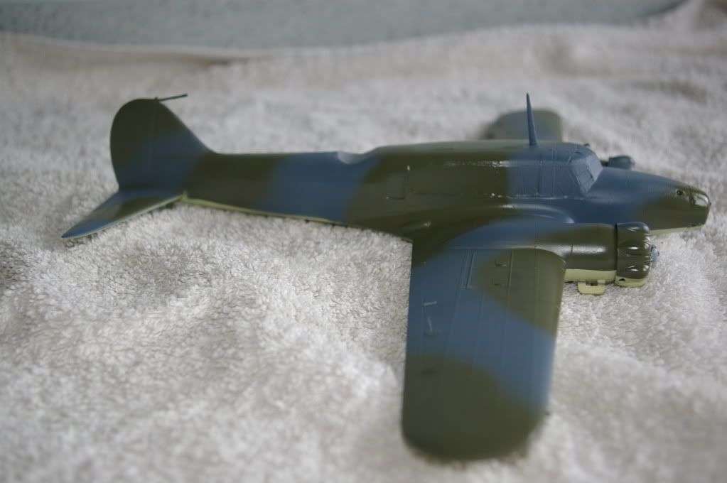

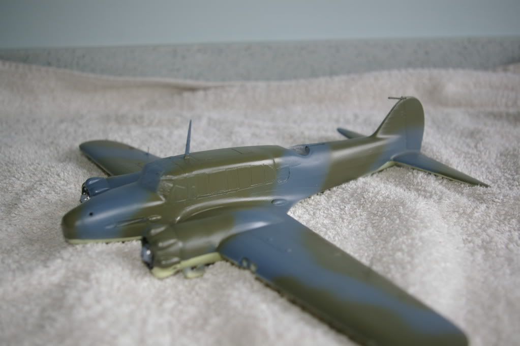

Silver Fox Posted April 14, 2011 Author Share Posted April 14, 2011 The good weather means that I got both top side colours on in a single day. First the NZ Ocean Blue which was a colour produced for the RNZAF by a paint company called BALM. It was used to replace the Dark Earth on RAF Camouflaged types such as the Hudson, Hind and some P-40s. NZ418 was completely re-painted so the pattern varied from the A or B schemes normally seen. I used Gunze Sanyo paints exclusively, they work for me and they are decal ready. Ok the next step is to paint the wheel bays and attach the pre-painted undercarriage. Once I'm happy with that decalling will commence. Then it is just the wheels, exhausts, D/F loop and turret. Link to comment Share on other sites More sharing options...
jimbuna Posted April 14, 2011 Share Posted April 14, 2011 Lovely paint job. Link to comment Share on other sites More sharing options...
Howard Moon Posted April 14, 2011 Share Posted April 14, 2011 Andy, Good to see it nearing completion, you have done a good job Steve Link to comment Share on other sites More sharing options...
Moofles Posted April 14, 2011 Share Posted April 14, 2011 ah wow, that looks great, really good to see it coming along. Link to comment Share on other sites More sharing options...

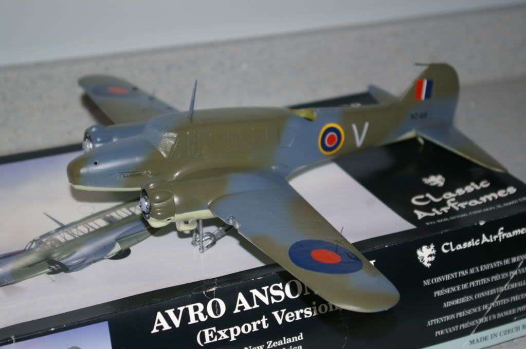

Silver Fox Posted April 16, 2011 Author Share Posted April 16, 2011 Like the title says, lots of progress this weekend.The undercarriage is in place and solid and the decals are done. Lots of details to paint and a bit of fettling with the turret, but I might actually get this one done! Link to comment Share on other sites More sharing options...
Wolfpack Posted April 16, 2011 Share Posted April 16, 2011 Never refer to yourself as an expert (ex as in has been and spurt as in drip under pressure). Nice to see all's going well until you drop on the garage floor after varnishing it......................................It's cursed I tell 'ee! W Link to comment Share on other sites More sharing options...
Pete M. Posted April 16, 2011 Share Posted April 16, 2011 Looking pretty good now Andy. Amazing how a build starts to come alive after paint and decals! You've got the (NZ) Blue Sea Grey spot on - what Gunze colour did you use for it - PRU Blue? Cheers, Pete M. Link to comment Share on other sites More sharing options...
Silver Fox Posted April 16, 2011 Author Share Posted April 16, 2011 Looking pretty good now Andy. Amazing how a build starts to come alive after paint and decals!You've got the (NZ) Blue Sea Grey spot on - what Gunze colour did you use for it - PRU Blue? Cheers, Pete M. Pete. . A mix of USN Intermediate blue and PRU blue, very much an approximation. As Wolfpack says i'll probably drop the thing on a concrete floor just as I finished it. Still I've actually enjoyed this restarted project and I have Kiwi Resin Airtrainer to finish so who knows that might get done as well. Thanks for the photos, I wasn't sure what the serial of the Anson was, can you remember? Anyway off to bed now, enjoy your Sunday. Andy Link to comment Share on other sites More sharing options...
Moofles Posted April 16, 2011 Share Posted April 16, 2011 you know i really like the colour scheme you have chosen, very effective. Link to comment Share on other sites More sharing options...
jimbuna Posted April 16, 2011 Share Posted April 16, 2011 Keeps getting better and better. Link to comment Share on other sites More sharing options...

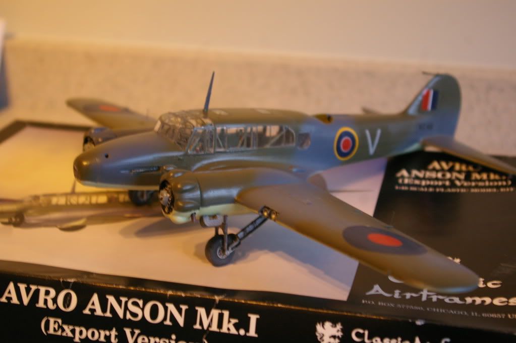

Silver Fox Posted April 18, 2011 Author Share Posted April 18, 2011 A bit more work on her today. The resin exhausts proved difficult to remove from the casting blocks I got the stub exhausts and one of the long pipe exhausts off with no damage but the other long one shattered. Some Contrail tubing and a little brute force and ignorance saved the day. The wheels are painted as are the oil coolers. NZ418 carried no Vickers K gun in the photos I have but I can't tell what remained of the mechanism in the turret. So I've approximated some of the parts on the basis that a navigation trainer would use the spae to carry an extra trainee navigator. Next up is the matt coat and then the masking of the turret. Link to comment Share on other sites More sharing options...
Silver Fox Posted April 19, 2011 Author Share Posted April 19, 2011 I managed to varnish her last night and removed the masking. The Eduard stuff has been on for four years but came off pretty cleanly. One window had paint seepage so was replaced with clear sheet. So just the propellors and turret then I can more her to RFI, in a strange way I'll be sorry when this project is over but I'm in no hurry to start the other from my stash Link to comment Share on other sites More sharing options...
