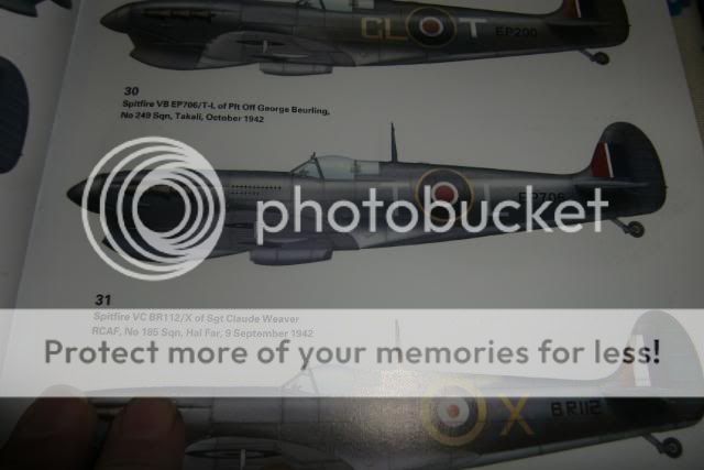

maltadefender Posted February 28, 2011 Share Posted February 28, 2011 Hi all, Just getting my ducks in a row to build 12 x Spits in 12 weeks for the Spitmodel GB. One of them will be 'Screwball' Beurling's 249 Sqn T-L EP706, which is often portrayed in desert scheme with a red spinner, but in the Malta Spitfire Aces book and the only photo I've found looks blue-grey. Apparently 249 over-painted its aircraft from later deliveries (EP706 arrived in July '42), but it does fly in the face of a lot of models. It's pretty clear that there was something of an 'anything goes' attitude by the autumn of 1942, but if there are any thoughts from dab ands Id be grateful. Here are the pics: Beurling in EP706 - looks like desrt scheme showing through in the scuffs on the wing root but overall single colour. Contemporary in desert scheme: Keith Park with a hotch-potch Spit in the background: Profile of EP706 in blue-grey: Link to comment Share on other sites More sharing options...
Greenshirt Posted February 28, 2011 Share Posted February 28, 2011 Similar thread here: Topic Linky I have decals for EP706/T-L but no ref that indicated it was Beurling's, not even the instructions. Just "249 Squadron, Malta" I also have the IPMS Canada set that has a Vb for Beurling, BR301/UF-S. The link above indicated BR301 was a Vc; I'm getting confused... I'm planning the build, and will use Extra Dark Sea Grey over Sky Blue for EP706/T-L, just to see how it comes out. Regards, Tim Link to comment Share on other sites More sharing options...
maltadefender Posted March 1, 2011 Author Share Posted March 1, 2011 Similar thread here: Topic LinkyI have decals for EP706/T-L but no ref that indicated it was Beurling's, not even the instructions. Just "249 Squadron, Malta" I also have the IPMS Canada set that has a Vb for Beurling, BR301/UF-S. The link above indicated BR301 was a Vc; I'm getting confused... I'm planning the build, and will use Extra Dark Sea Grey over Sky Blue for EP706/T-L, just to see how it comes out. Regards, Tim Many thanks Tim... looks like I'll be doing some thinned-out Extra Dark Sea Grey washes over desert scheme then! Link to comment Share on other sites More sharing options...

Test Graham Posted March 2, 2011 Share Posted March 2, 2011 Every delivery except Calendar was in desert scheme. The aircraft from the first delivery was repainted in a dark blue-grey within days of arrival - see photo and description in Malta: The Spitfire Year. The complete giveaway on this batch (only) is the white serials. If I could remember who told me about T.B I'd be able to find the email with the details! I've just replaced my computer and have (briefly) delved into the old files to sort them out but not found this. It might have been Steve Nichols. Link to comment Share on other sites More sharing options...
