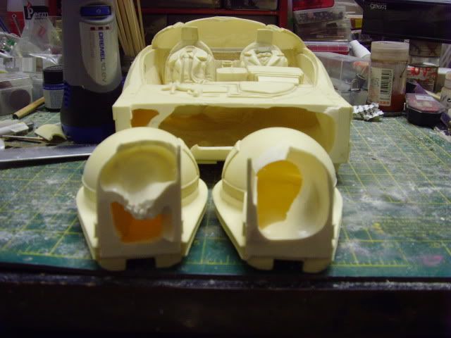

Neo uk Posted February 25, 2011 Share Posted February 25, 2011 I've had this model for well over ten years now and it was one of my "get out and look for a bit" kits that most of us have. Anyway the other day I decided to build it along with the two other Spinners I've aquired over the years. When I looked at it sat next to the others I noticed there was something wrong with the shape of the front something that would take a lot of work to put right. I nearly put it back in the box but after much debate with myself I decided I would get stuck in, so I'm going to saw off the wheel pods of this rare kit....stay tuned :? Here's a before picture. Link to comment Share on other sites More sharing options...

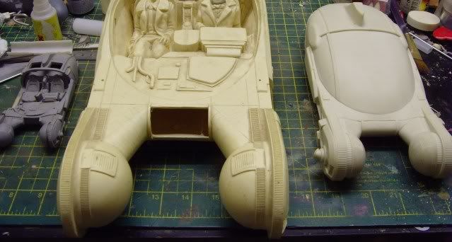

Paul RH Posted February 25, 2011 Share Posted February 25, 2011 (edited) You have three of them!! What scale are they ?? Edited February 25, 2011 by Paul RH Link to comment Share on other sites More sharing options...
GreenDragon Posted February 25, 2011 Share Posted February 25, 2011 They look to me like (left to right) 1/48th, 1/24th and 1/32nd. Very nice kits! All I have is a 25/28mm scale resin look-a-little-like kit from Grendel/Scotia. Paul Harrison Link to comment Share on other sites More sharing options...

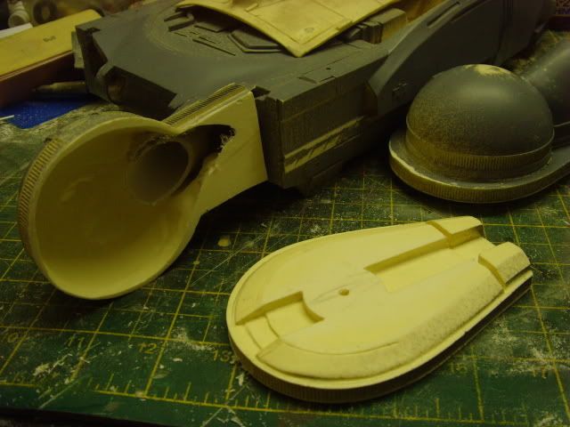

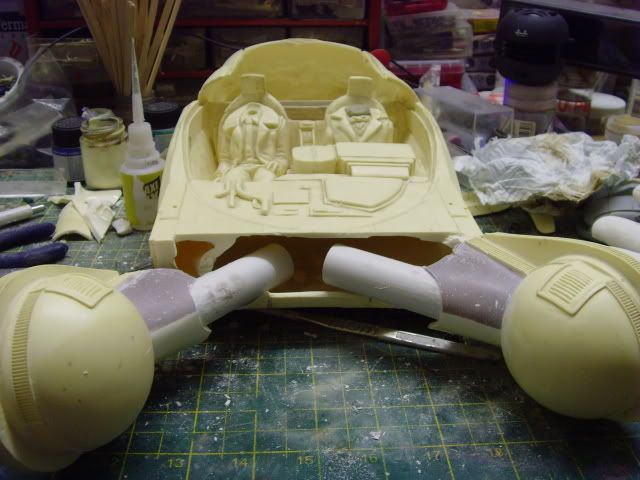

Neo uk Posted February 27, 2011 Author Share Posted February 27, 2011 Update..I finally did it Link to comment Share on other sites More sharing options...

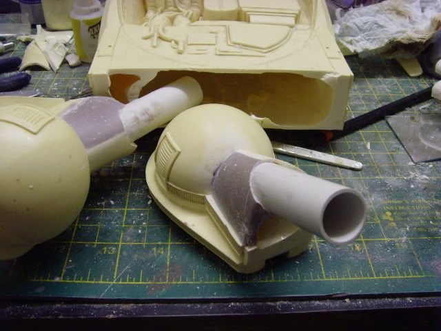

Neo uk Posted February 28, 2011 Author Share Posted February 28, 2011 Here's the new wheel pods with a better curve to the top of them. Link to comment Share on other sites More sharing options...

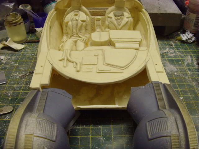

Neo uk Posted March 2, 2011 Author Share Posted March 2, 2011 Now the wheel pods are better here's the next bit of restructuring to be done. Link to comment Share on other sites More sharing options...

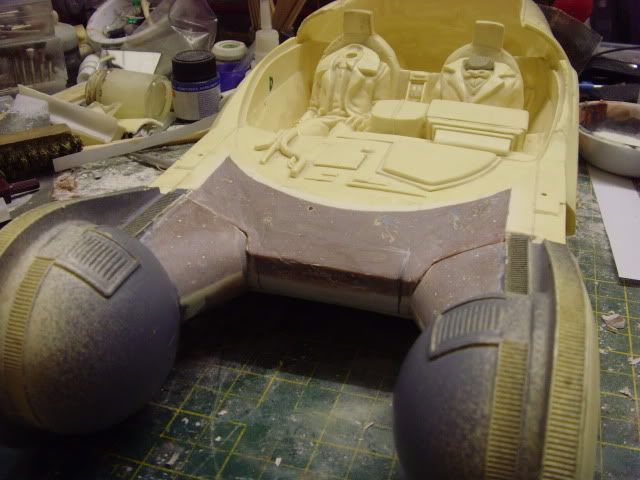

Neo uk Posted March 5, 2011 Author Share Posted March 5, 2011 After a fair ammount of body filler, sanding and filing ... Link to comment Share on other sites More sharing options...

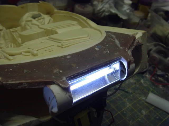

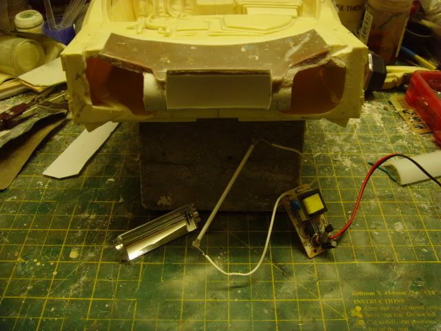

Neo uk Posted March 7, 2011 Author Share Posted March 7, 2011 Here a the components I've gathered for the front light. A modified torch reflector and a mini Fluorescent tube, how cool is that Link to comment Share on other sites More sharing options...

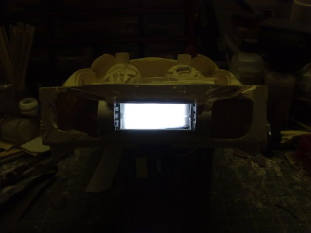

Neo uk Posted March 10, 2011 Author Share Posted March 10, 2011 Here's the tube in and working Link to comment Share on other sites More sharing options...

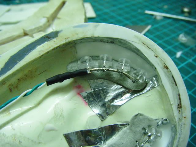

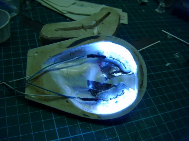

Neo uk Posted May 1, 2011 Author Share Posted May 1, 2011 Going a bit slow on this at the mo. I'm trying to work out the best way to light these (see above) Took me ages last night just to line the inner wall with foil tape stuff to stop light leaks. Link to comment Share on other sites More sharing options...

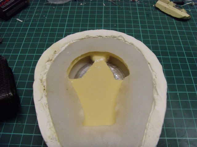

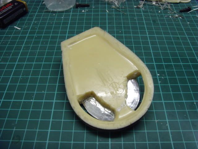

Neo uk Posted May 16, 2011 Author Share Posted May 16, 2011 A bit more progress on this. I made a silicon mold of the re shaped wheel cover before i cut out where I want the lit area to be so after cutting them out it was just a case of putting them back in the mold and pouring in some nice white resin. Easier said than done that was as I kept gitting the resin too thin or too thick .It took me five tries to get the resin just right ie, thick enough to be an even white colour and thin enough to let light pass through. Anyway stay tuned.. Link to comment Share on other sites More sharing options...

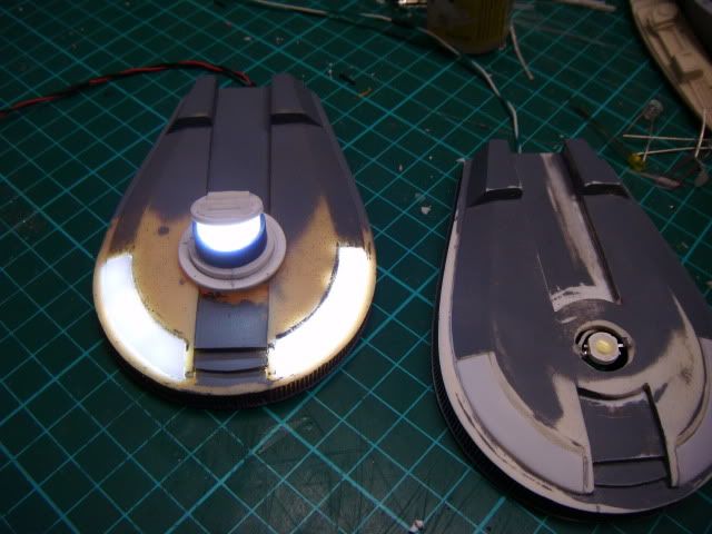

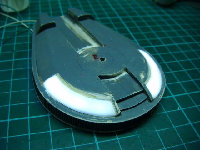

Neo uk Posted June 5, 2011 Author Share Posted June 5, 2011 I've got the LEDs soldered up and installed behind the resin inserts, It took me absolutley ages sifting through LEDs to find sixteen that were all the same shade of white. Anyway here they are lit. This picture doesnt show them off very well but they do light up evenly and quite bright. Link to comment Share on other sites More sharing options...

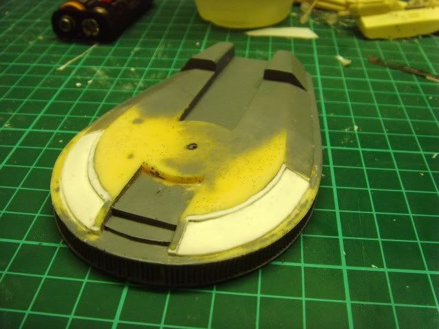

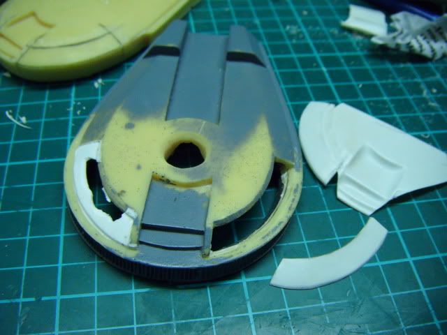

Neo uk Posted July 6, 2011 Author Share Posted July 6, 2011 (edited) These wheel covers are killing me, god knows how many hours I've put into them already. Now I've had to crack out all the white resin inserts that I put in because I noticed some tiny black dots that turned out to be air bubbles in the resin. I knew they would haunt me in the future so they had to go So plan B, vac formed covers over the same area. I should have done it this way first intead of trying to be clever . These have took up way too much time to finish but I'm finally happy enough with these to proceed with a different part of the model now. Time to tackle the interior I think Edited July 6, 2011 by Neo uk Link to comment Share on other sites More sharing options...
