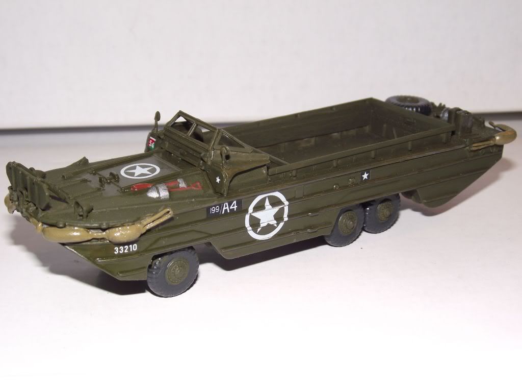

mrcooljules Posted February 21, 2011 Share Posted February 21, 2011 This is a WIP shot, on the italeri DUKW. look at the white start on the side, and see how its so tight and pulled right over the ribs on the side...i had to use a fair bit of sol n set to get this effect. without any it wouldnt have sat night and tight and looked poor. get some, lasts for ages...mine has been going years for the same bottles. Link to comment Share on other sites More sharing options...

Pearson.J Posted February 21, 2011 Author Share Posted February 21, 2011 Spent Friday night decalling a H/B 1/72nd Corsair in Tigermeet decals.The decals were quite thick gut incredibly fragile,the stripes under the wing's I gave up on so am having to paint them on.I was worried the surface details would be hidden by the thick decals but after the Micro Sol/Set,they went down OK. Thank you Jonners, my brain wasn’t working earlier, it being the holidays and all. Thanks spike, that’s one of my worries, about "messing" it up and ruining the detail. That is one mighty fine DUKW Jamie Link to comment Share on other sites More sharing options...
