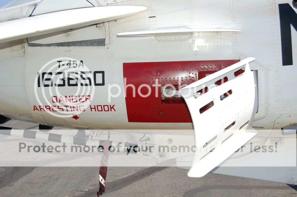

Scarlet Posted February 28, 2011 Share Posted February 28, 2011 I’ve also made one of the plates missing from the tail plane. The location of this is represented with a curved line and a dot, which I marked out in pencil to make it more visible. I used the radius from the dot to the line to cut a circle out of 10 thou plasticard. I then trimmed it until I got something that looks like the right shape. Once I had the shape in it I cut the slot for the tailplane. This went easier than I thought and I’m pleased with the result. The 'plates' should have a straight bottom edge and be symetrical. On the real aircraft they are made up of four parts, top, bottom and the two different size side guides and are knicknamed 'bacon slicers'. If you've used the photos the that Mark Marples uploaded as a reference, they show the tailplane in a stick forward attitude and not the neutral position (port side photo shows this well, the two white marks should be in line for tailplane neutral), exposing a wedge shape bit of different colour paint which looks like the shape you have there. I do like the extra detailing your doing, especially the flap area as Hawks have a tendency to droop at rest. Im surprised Revell didnt give the kit the option. Hawk flaps don't droop (airbrake does), they are selected fully down on shutdown. IMO Revell have missed a trick here and should have had seperate flaps as an option, but they have included a seperate rudder for some obscure reason? The Hawk rudder is not hydraulically powered and has a sprung centering unit meaning it is always in it's neutral position unless the rudder pedals are moved which does'nt happen when parked. Link to comment Share on other sites More sharing options...

FZ6 Posted March 1, 2011 Author Share Posted March 1, 2011 Thanks for all the comments guys. I hope to get some work done on the seat straps this evening. The 'plates' should have a straight bottom edge and be symetrical. On the real aircraft they are made up of four parts, top, bottom and the two different size side guides and are knicknamed 'bacon slicers'. If you've used the photos the that Mark Marples uploaded as a reference, they show the tailplane in a stick forward attitude and not the neutral position (port side photo shows this well, the two white marks should be in line for tailplane neutral), exposing a wedge shape bit of different colour paint which looks like the shape you have there.Hawk flaps don't droop (airbrake does), they are selected fully down on shutdown. IMO Revell have missed a trick here and should have had seperate flaps as an option, but they have included a seperate rudder for some obscure reason? The Hawk rudder is not hydraulically powered and has a sprung centering unit meaning it is always in it's neutral position unless the rudder pedals are moved which does'nt happen when parked. Scarlet thanks for the info it's really useful. I'm only a casual admirer of the Hawk so don't know a great deal about the aircraft and I'm learning new things about this wonderful aircraft all the time, so any feedback that can help me build a better model is greatly appreciated. I could have sworn the plates looked like how I modelled from my photographic references I used. I didn't use Mark Marples photos as I was looking in the wrong section of Britmodeller for them but I've found them. Mark Marples pics show it much clearer and I can see the bacon slicer guides you're referring to and was thinking how I could represent that on the model but it looks a bit tricky to try and replicate so I'll just make some more with symmetrical top and bottom surfaces. Mark Marples Hawk pics are here for anyone who's not seen them. http://www.britmodeller.com/forums/index.php?showtopic=51911 Link to comment Share on other sites More sharing options...

geedubelyer Posted March 1, 2011 Share Posted March 1, 2011 Thanks for reposting the link to Marks' walkaround Mark. There are some very useful images in that thread. I hope you don't mind me asking this question here they show the tailplane in a stick forward attitude and not the neutral position (port side photo shows this well, the two white marks should be in line for tailplane neutral), exposing a wedge shape bit of different colour paint which looks like the shape you have there.Scarlet, how common is this stick forward attitude for the horizontal tails? The reason I ask is that many images on reference sites (like Airliners etc) show the tailplanes of parked Hawks to sit parallel to the rearmost upper fuselage area rather than the ground. Just wondered which is more common, cheers.Now, back to your regularly schedueled programming Link to comment Share on other sites More sharing options...

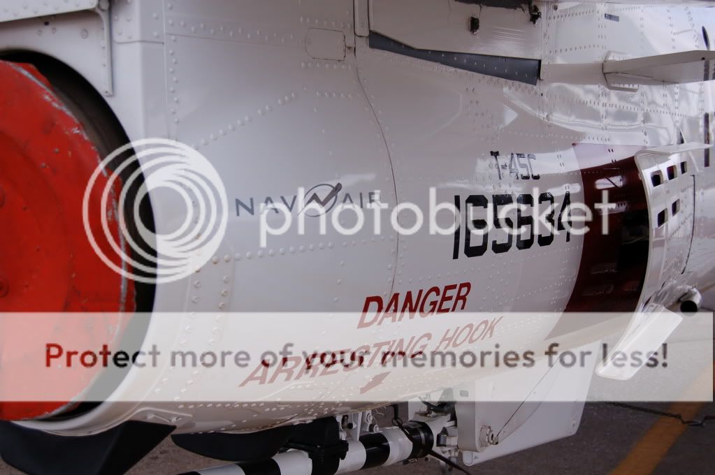

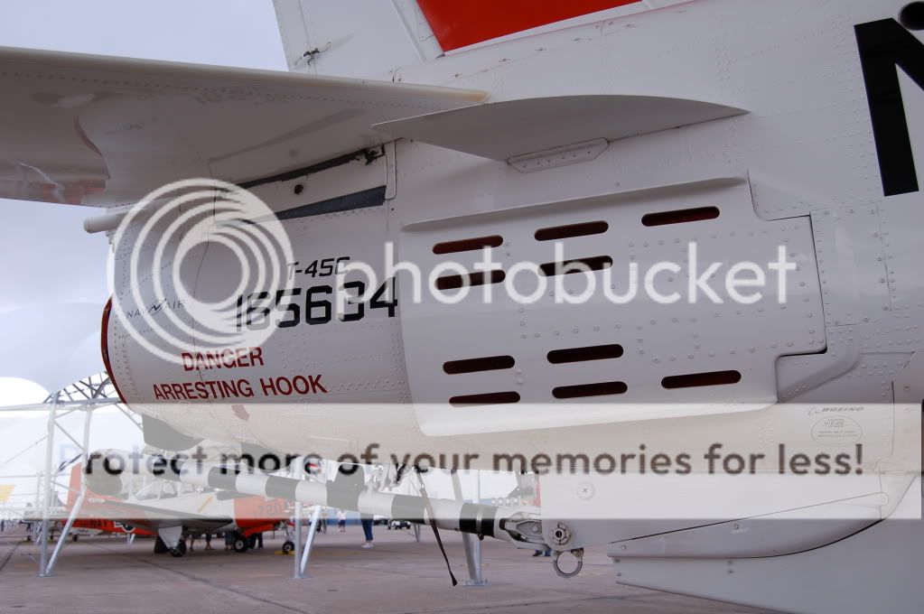

Gabe Pincelli Posted March 2, 2011 Share Posted March 2, 2011 Here are some pics of the "plates" on a T-45. Might be a bit easier to see on a white jet. They are close to symetrical but not quite. Note the aft bottom corner. Also , the top plate is slightly more narrow at the forward end than the aft end. (With the stabilator leading-edge-up the top edge is nearly horizontal) HTH, Gabe Link to comment Share on other sites More sharing options...
