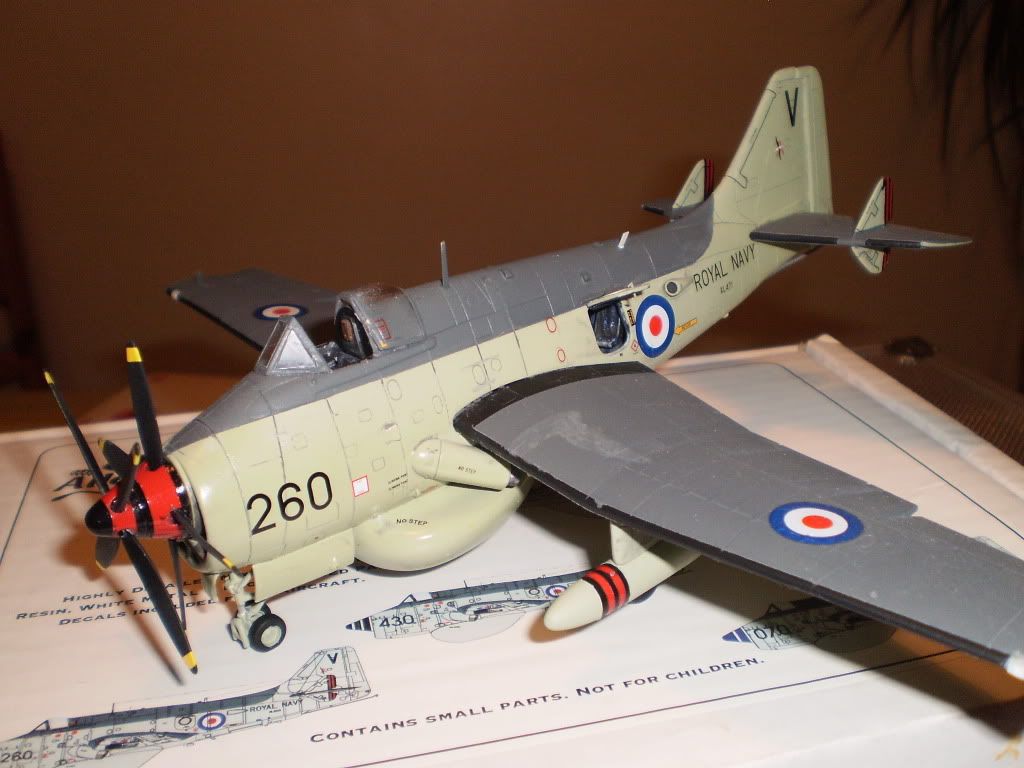

moaning dolphin Posted February 10, 2011 Share Posted February 10, 2011 Hello I sprayed mine with red pain first (D flight cab) and then carefully masked with very thin masking tape, Tamiya tape sliced quite finely. It was then a case of a steady hand and a straight eye to lay the tape straight. I didnt get it perfect but it seems to work for me. Also I painted the spinner before assembly which made things alot easier. I found the kit was a gem to build and looks mighty fine! Cheers now Bob Link to comment Share on other sites More sharing options...

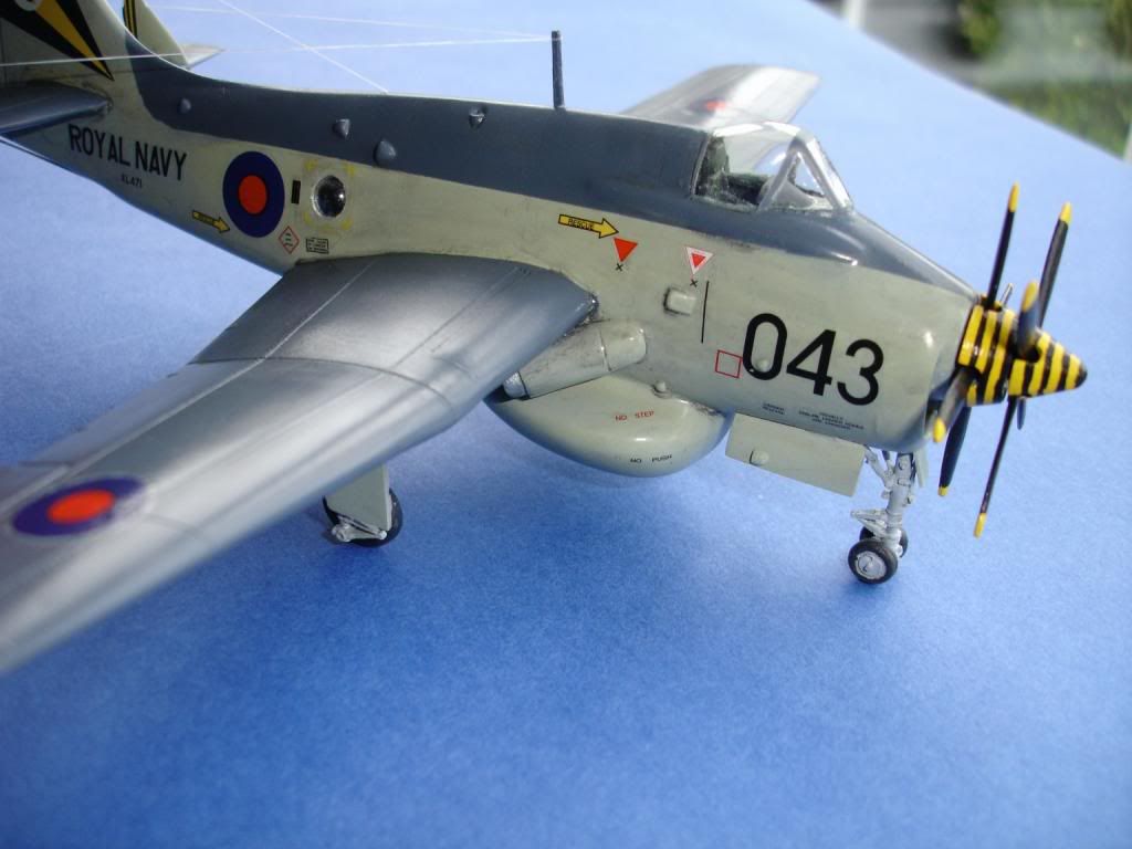

gishuk Posted February 10, 2011 Share Posted February 10, 2011 i did the same thing, tamiya tape cut into very fine strips can be forced around the spinner as long as you take care to really burnish it down. my aew is the aeroclub conversion of the frog kit, but you can see the spinner here Link to comment Share on other sites More sharing options...
