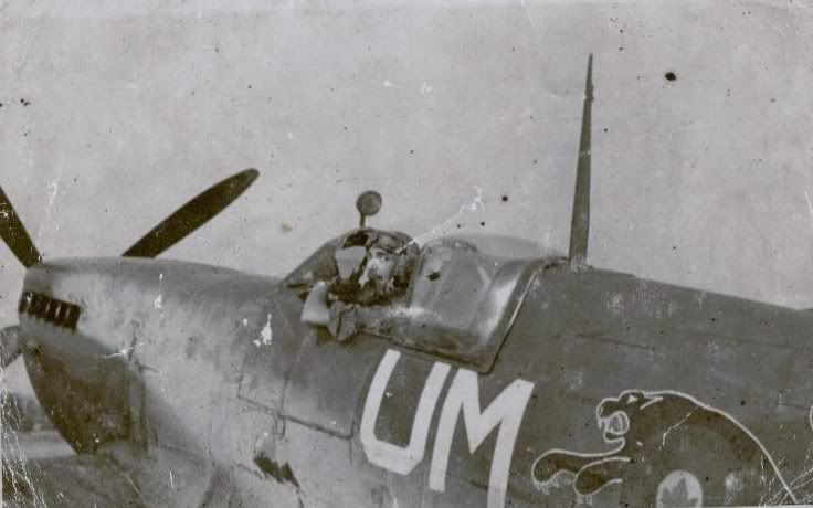

Black-Panther Posted February 10, 2011 Share Posted February 10, 2011 Hi can give me any help please ? I would like to know what size letters I would need for a 1/48 Spit MK V111 as pictured below. I'm very green to all this lol... Many Thanks Rob Link to comment Share on other sites More sharing options...
Jon Kunac-Tabinor Posted February 10, 2011 Share Posted February 10, 2011 Hi Ron - those would be 20" high white code letters - so you need to look for either 20" in 1/48th or 30" in 1/72 ( either will do) or this http://www.hannants.co.uk/product/BC48008 or this http://www.hannants.co.uk/product/RD48009 cheers - hope this helps Jonners Link to comment Share on other sites More sharing options...
Black-Panther Posted February 10, 2011 Author Share Posted February 10, 2011 (edited) Hi Ron - those would be 20" high white code letters - so you need to look for either 20" in 1/48th or 30" in 1/72 ( either will do)or this http://www.hannants.co.uk/product/BC48008 or this http://www.hannants.co.uk/product/RD48009 cheers - hope this helps Jonners Thanks Jonners Do you know if you get these letters on a single sheet ? I've got the Barracudacals one already, I want to do different letters. Cheers Rob... Edited February 10, 2011 by Black-Panther Link to comment Share on other sites More sharing options...
Seahawk Posted February 10, 2011 Share Posted February 10, 2011 (edited) Thanks JonnersDo you know if you get these letters on a single sheet ? I've got the Barracudacals one already, I want to do different letters. Cheers Rob... Have a look at what Fantasy Printshop offer: http://www.fantasyprintshop.co.uk/_A7ABZ.aspx?1 FP885 (21" codes in 1/48) would be pretty well ideal but they don't do them in white. But you do have the choice of either 18" (FP884) or 24" (FP886) in white. Doubt if anyone will be able to tell 18" from 20". Just drive off anyone approaching your model with a ruler! Edit: in retrospect maybe not such a bright idea. The codes on your subject are non-standard (45 degree angled corners), the style of the "M" on the sheet is different and the stroke width may be too thin. Apart from that, they're perfect! HTH Edited February 10, 2011 by Seahawk Link to comment Share on other sites More sharing options...
