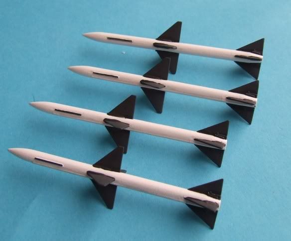

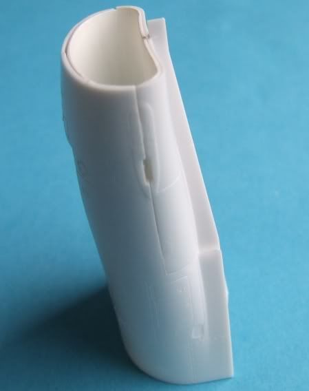

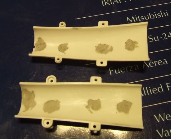

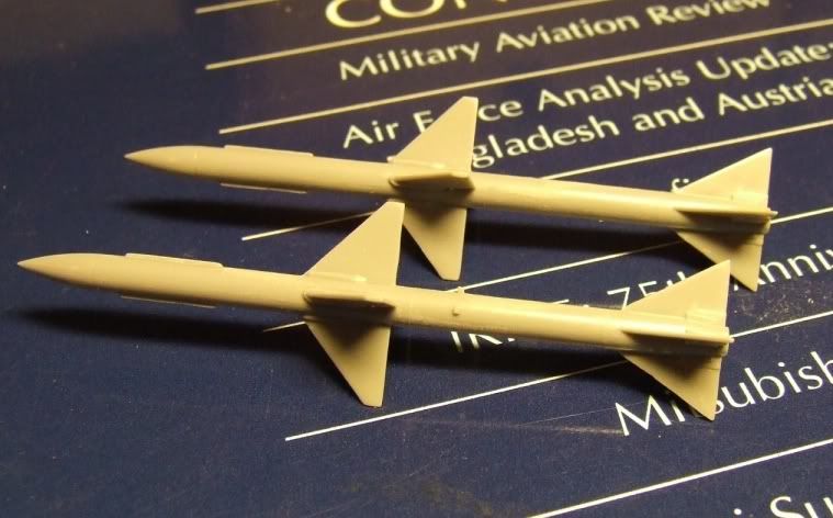

Nev Posted January 4, 2008 Author Share Posted January 4, 2008 Newborn baby or no newborn baby I actually got my first modelling in months done last night! :dum: Got to work on the Sparrows. I used ones out of the Hasegawa weapons set and they required a lot of clean up - heavy flash, ejector pin marks etc. They also had some weird little nodules on the missile which I have no idea what they are meant to represent so I cut them off. Here is a before and after. Also got to work cleaning up the giant sink marks in the intake trunking... Link to comment Share on other sites More sharing options...

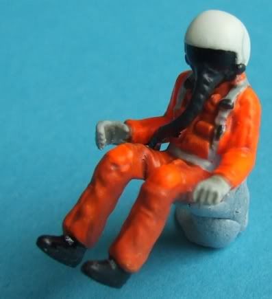

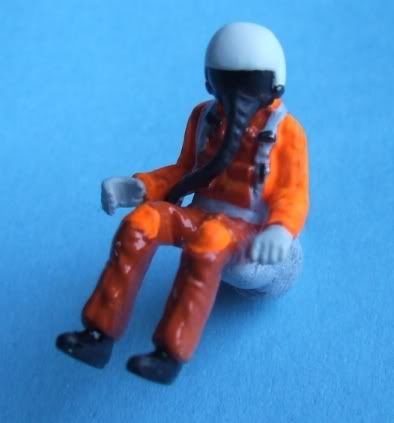

Nev Posted January 12, 2008 Author Share Posted January 12, 2008 I've been getting a lot of progress done on this the last week, but a lot of it is prepatory work and not worth showing - but the next week I expect to make real fast progress *crosses fingers* Also its been raining pretty much non-stop the last few days so the light has been no good for taking pictures worth a damn (see above). I've finished the basic colours on the pilot - just a couple of touch ups to do, eg round the knee pads - the 2 oranges I used for the flight suit and g-suit are MUCH more obvious in daylight than artificial light :dum: Then a wash and a flat-coat and he's done Link to comment Share on other sites More sharing options...

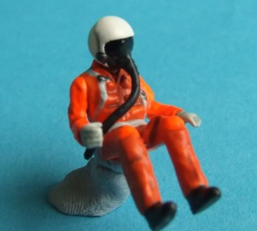

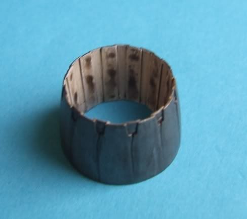

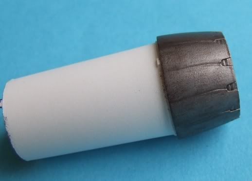

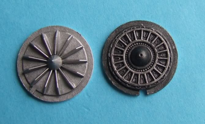

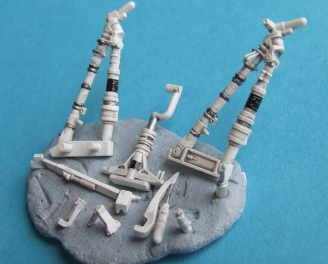

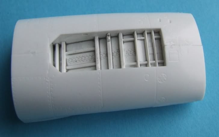

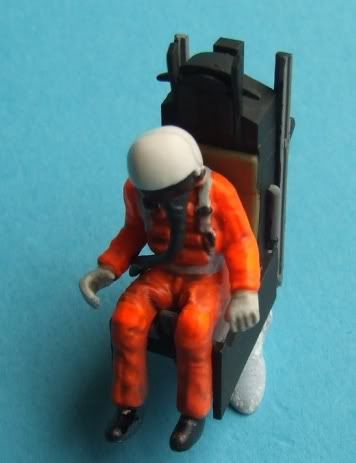

Nev Posted January 17, 2008 Author Share Posted January 17, 2008 OK, lots to update. Pilot figure is finished, but the dayglo orange is proving real hard to photograph. It looks a lot better in real life (honest!) The bang seat is only just started engine in and out bits Wheels - I added a couple of tiny strips of red decal. Don't know what they're supposed to be on the real thing, but I can see them in photos Exhaust - a bit of experimentation both inside and out to try and replicate the real thing. I think I've done a better job of the metallic out than the ceramic in. I think I'll give that a couple more washes. Gear doors. To replicate the placard on the nose gear door I used some drop-tank stencils for the Airfix 1/48, and used the same for the MLG placards The AIM-7s were a nightmare to paint - 8 fins per missile, 4 missiles....32 fins , both sides makes 64.....I was going blind by the end. They still need a few fine details adding. Gear bays The whole kit is very finely engineered, to the point where even a coat of primer on the mating surfaces will cause 2 parts to not fit. I'm sure the intake is meant to fit better than this... Link to comment Share on other sites More sharing options...
Gundylunch Posted January 17, 2008 Share Posted January 17, 2008 Nice going so far !! The red strips should go over onto the tyre as well, they are there to show up/detect any movement of the tyre on the wheel hub !! Link to comment Share on other sites More sharing options...

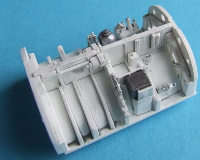

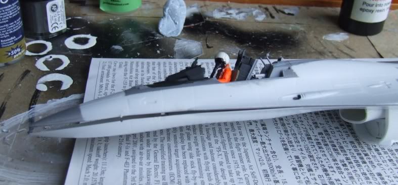

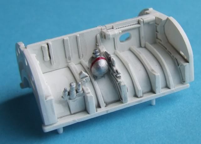

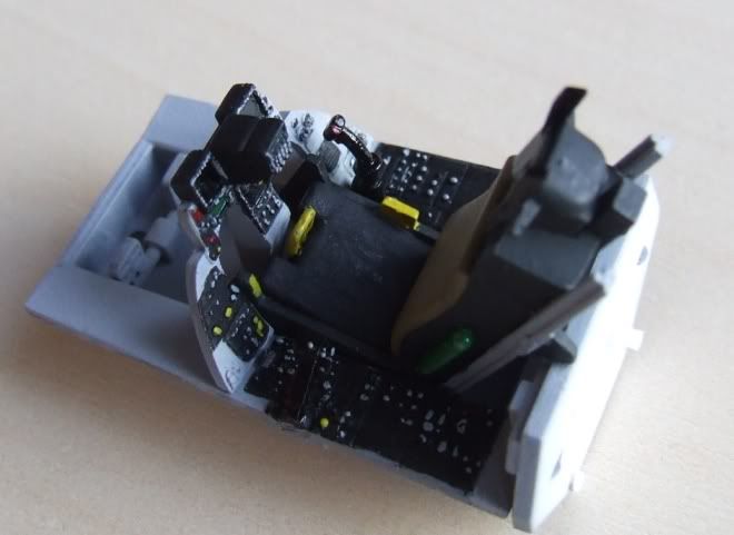

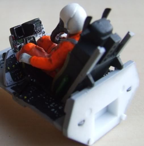

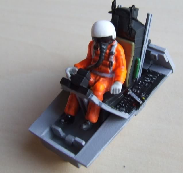

Nev Posted January 29, 2008 Author Share Posted January 29, 2008 Update: cockpit finished! Its actually a kinda boring cockpit. So plain and black.......and being so new they're not at all weathered either Pilot figure added (obscuring most of the cockpit detail ) He's a bit of a Tight Fit (aaaaaaaagadoo-doo-doo) in there Remember how I said the kit was so well engineered that even a coat of primer causes 2 parts to not fit? Well, without the cockpit in there, the 2 fuselage halves literally click together. With the cockpit in there, this is the result (and this is after 2 hours sanding, scraping, fettling and gouging to improve the fit!). I forsee much clamping and filling and sanding Link to comment Share on other sites More sharing options...
periklis_sale Posted January 29, 2008 Share Posted January 29, 2008 Its coming along nicely mate!!! First tiem seen a fit on this model as bad as this!!!!!! She is a putty eater too!!!!!!!!! Link to comment Share on other sites More sharing options...
Ian Posted January 29, 2008 Share Posted January 29, 2008 Stick with it, Nev Ian Link to comment Share on other sites More sharing options...
Nev Posted January 29, 2008 Author Share Posted January 29, 2008 Its coming along nicely mate!!!First tiem seen a fit on this model as bad as this!!!!!! She is a putty eater too!!!!!!!!! The halves actually go together if you hold them together, they just won't sit naturally like that with the cockpit in Link to comment Share on other sites More sharing options...

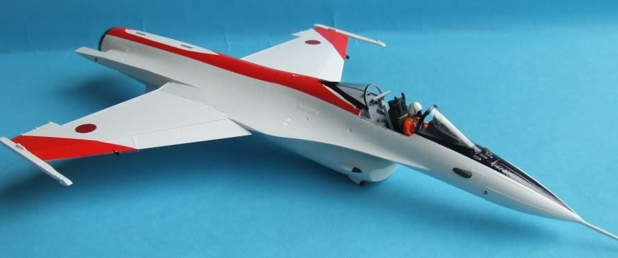

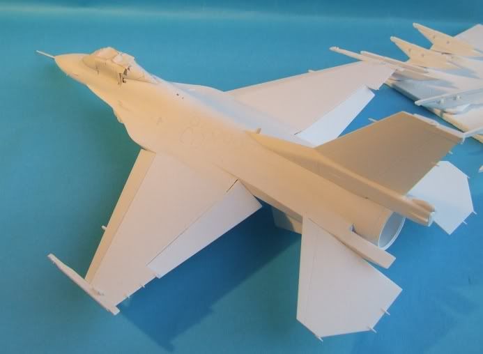

Nev Posted February 15, 2008 Author Share Posted February 15, 2008 Cooking with gas now. Couple of coats of white primer - needs touching up in a few areas still, then more primer, then the appliance white. The fin and a lot of smaller bits like ariels aren't glued on yet because of the complicated decal arrangement.... Link to comment Share on other sites More sharing options...

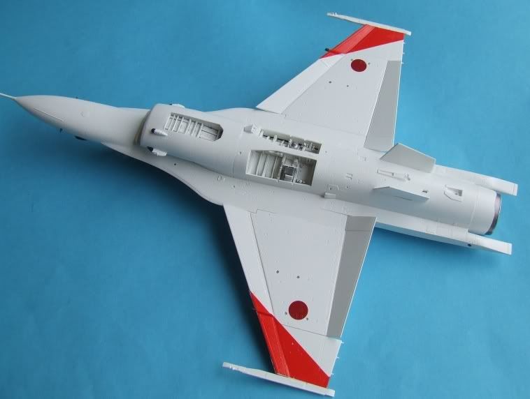

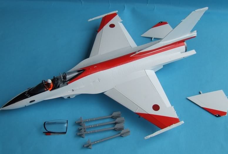

Nev Posted March 6, 2008 Author Share Posted March 6, 2008 (edited) Right, started decalling, but its proving......problematic 1) First off, the decal that joins to the canopy isn't right. There's a little nobbly bit on the spine that should be in the black trim - but is covered by the decal. This means that there is some black showing through the red. 2) Also the stripe down the spine around the rudder base isn't flush to the fin, leaving a white strip that will need touching up. 3) AND when I applied the red decal to the canopy and masked it off to apply the black (learning from (1)), the masking tape lifted off the decal.... 4) Oh, and the 2 decals that make up the spine are different widths.... So I'm going to have to try and mix up a match for the red decal - and we all know how hard it is to get good coverage with red/orange paint Having said that, and applying my mantra of "A fuzzy digicam picture hides many a modelling sin", it's looking quite pretty isn't it? Edited March 6, 2008 by Nev Link to comment Share on other sites More sharing options...
