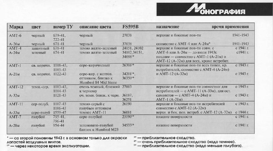

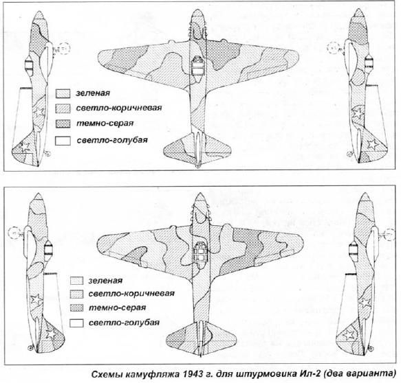

dragonlanceHR Posted December 29, 2010 Share Posted December 29, 2010 Hi Max, I checked the instructions on Eduard website (Kit no7410), the aircraft is wearing the bottom version of the standard 1943 NKAP 3-color upper camo. The colors are AMT-4 Green , AMT-1 light brown (grey brown) and AMT-12 dark grey (Or their slightly yellowed versions A-24m, A-21m, A-32m) . Underside is AMT-7 blue. Prop blades AMT-6 Black, cockpit, well, ALG-5 Green primer or the nominal A-14 steel grey over ALG-5, A-14 also goes inside the wheel wells. Speaking Humbrol: AMT-4 - I would prefer Hu-114, or in a pinch Hu-151 or Hu 105 AMT-1 - Is there an eqvivalent do Tamiya/Model Master NATO brown? AMT-12 - Hu-32 AMT-7 - 50/50 mix Hu47+Hu65. (I rather like my old tin of Hu-115 for faded look) A-14 - Hu-27 looks good, or maybe add a drop of white. ALG-5 - a 50/50 mix A-14 with your choice of Yellow/orange zinc chromate color (real mix was 50/50 A-14 and ALG-1 Zinc chromate). For an excellent IL-2 color discussion with stunning explanations of paints and repairs on a preserved wreck, go to http://tinyurl.com/2wjvvyr I also see that Massimo updated his VVS color table http://mig3.sovietwarplanes.com/colors/color-table.html HTH, Vedran Link to comment Share on other sites More sharing options...
Max Headroom Posted December 29, 2010 Author Share Posted December 29, 2010 Vedran! Many thanks! Lots of lovely detail there. Trevor Link to comment Share on other sites More sharing options...
