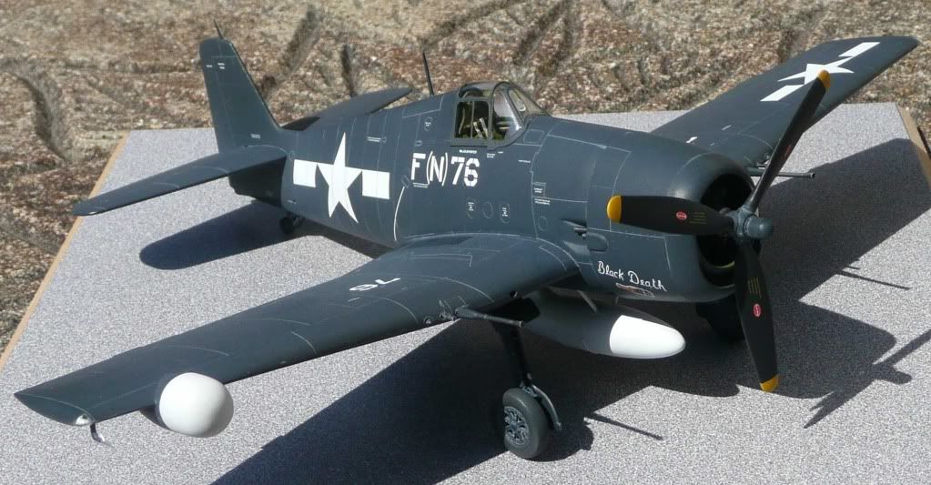

C6MSD Posted January 7, 2011 Share Posted January 7, 2011 You may be watching for some time... I only managed to paint the engine over the whole Christmas holiday. Nice kit. I built the same as my second after a 10 year lay off and enjoyed it as my introduction to Eduard kits. Was my first at the time, but nearly finished No 3 now: Have to say - I don't recall having any isses with the cowling at all - certainly not to the degree commented by others! Link to comment Share on other sites More sharing options...
