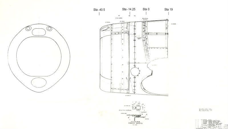

jimmaas Posted August 3, 2010 Share Posted August 3, 2010 This is Brewster drawing 12-31501, F2A-2 Cowl Assembly, which may help. Since in reduced size the Station locations are almost invisible, I've annotated it with four Station locations. As with most 1940's aircraft drawings, the firewall is Station 0; anything forward of the firewall is a negative number, so the front of the cowling is Station -40.5 inches. The rear of the engine cowling is Station -14.25 (actually, -14 and 3/16 inches but I rounded off!). By my measurements the width of the real cowling (Sta -40.5 minus -14.25) is 26.25 inches and the Tamiya kit measures a scale 26.5 inches. That's spot on as far as I'm concerned, especially since measuring a kit around curved surfaces has some built in error. The problem comes with the distance from the firewall (Sta 0) to the rear of the cowling. The real thing is 14.25 inches. The Tamiya kit measures a scale 11 inches. So it appears short by a scale 3 inches, a shade more than a millimeter. Hope this helps - Jim Maas WKBS, DBVW* *Defender of Belgian Ventral Windows Link to comment Share on other sites More sharing options...

Antoine Posted August 3, 2010 Author Share Posted August 3, 2010 Thanks Jim, so mr Couston's drawings are a bit overlenght. I've already added 1mm to the cowling, I'll see if I add 1 more after comparison with your own drawing. Link to comment Share on other sites More sharing options...
jimmaas Posted August 3, 2010 Share Posted August 3, 2010 Thanks Jim, so mr Couston's drawings are a bit overlenght.I've already added 1mm to the cowling, I'll see if I add 1 more after comparison with your own drawing. Maybe 1.5 mm, I think 2 mm would be too much. Link to comment Share on other sites More sharing options...
