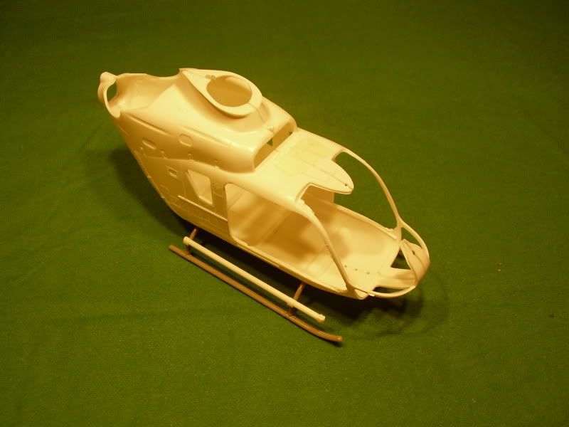

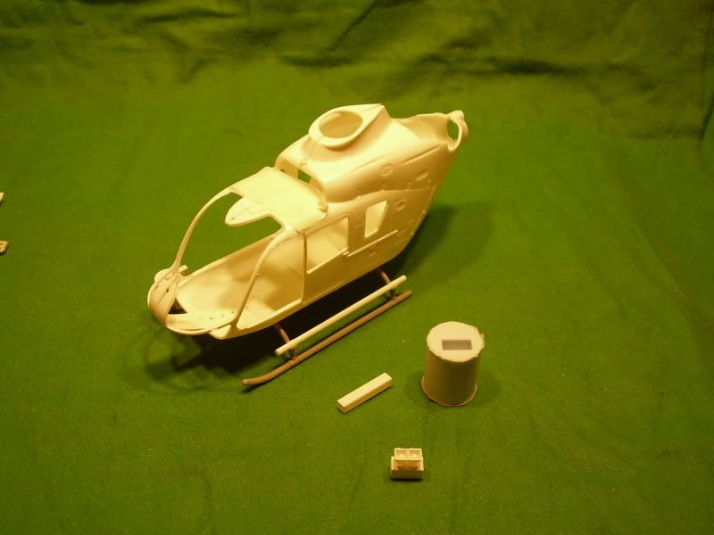

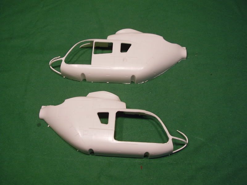

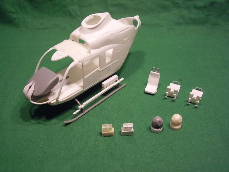

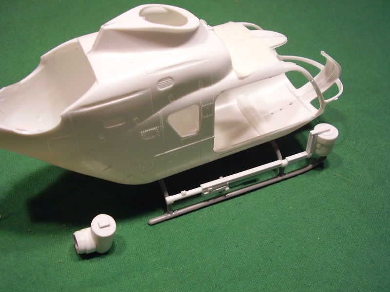

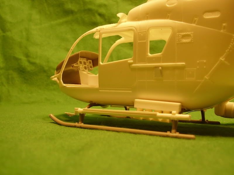

Paul @ Parkes682Decals Posted July 3, 2010 Share Posted July 3, 2010 (edited) Hi All I thought i would share my lastest build with you its the Eurocopter EC-135 P2+ for the West Midlands Police Air Support newest Police Helicopter due to be delivered in July/August 2010. The kit i am using is the Revell Eurocopter EC135 German Army version and heavly converting into a custom helicopter for police work.The kit is 1:32 scale so that i can put plently of detail into the cabin area.As before with the doors open showing all the scratchbuilt cockpit and of course the custom decals that i make myself (Parkes682Decals) The first thing is to cut out the doors,carefully not crack the thin area in the door area on the front doors.This EC-135 P2+ has got the shorter legs which is different to the previous EC-135 P2 (G-WMAO)which had the taller skids.The FLIR pod and Searchlight are mounted on to the starboard leg on special mounts.Well here's the photos. The photo is of the Suffolk Air Support EC-135 which has recently accuired there's but this is roughly what it will look like but different markings Paul Edited July 4, 2010 by Paul @ Parkes682Decals Link to comment Share on other sites More sharing options...

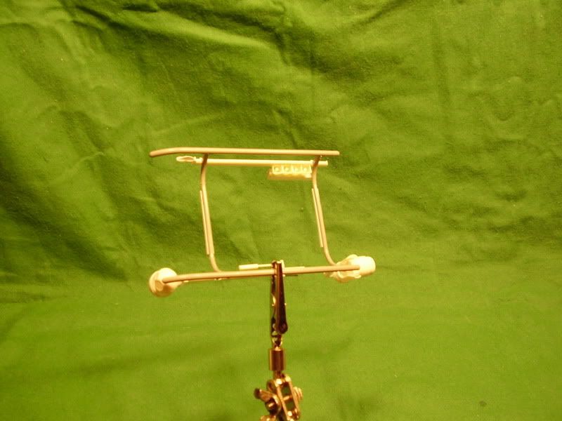

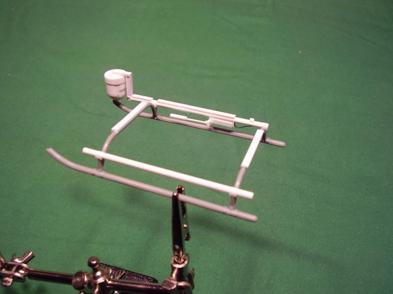

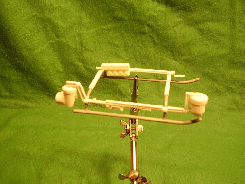

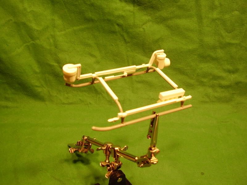

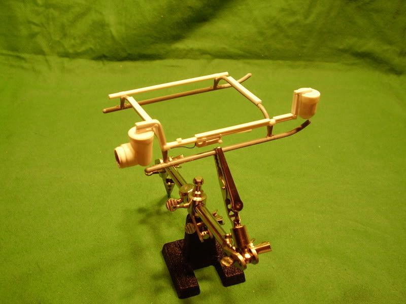

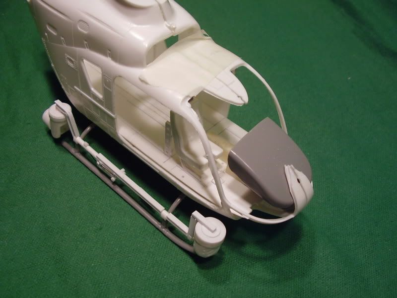

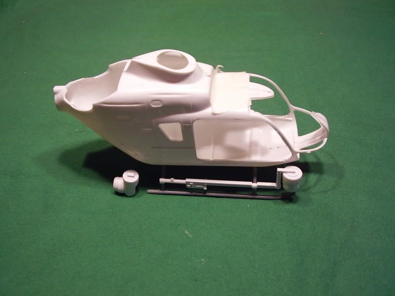

Paul @ Parkes682Decals Posted July 4, 2010 Author Share Posted July 4, 2010 Hi All Here's the next part's to the starboard skid. The front pod is the FLIR pod which is mounted on the front of the skid all scratchbuilt,the pod under the top skid/footplate is the data link that drops down when the Helicopter is transmitting live pictures/data back to the force Headquaters in Birmingham. The data pod again is scratchbuilt,the other part is the searchlight that is attached to the rear of the skid.Thats the next job to make/manufacture and mount. Keep watching Paul Link to comment Share on other sites More sharing options...

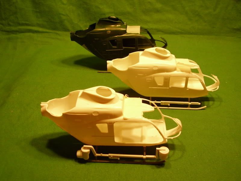

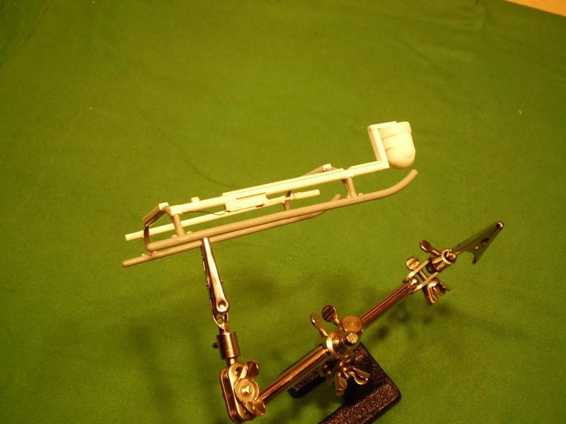

Paul @ Parkes682Decals Posted July 8, 2010 Author Share Posted July 8, 2010 Hi All Here's the next piece of work to the Starboard rear skid,the searchlight and skid mount Its totally scratchbuilt and there are power sockets to both units which will attach later in the build. The next thing is to make for the Port side skid is the Skyshout Loudspeaker system which is attached to the rear of the skid. The next photo show's the new EC-135 P2+ for the West Midlands Police,then in the middle (G-SUFK) also a EC-135P2+ version in the colour scheme of Suffolk Air Support.The third EC-135 T1 is (G-SUFF) in green plastic,in the current West Midlands Police colour scheme.You may notice that it has the higher version of the legs and skids. Paul Link to comment Share on other sites More sharing options...

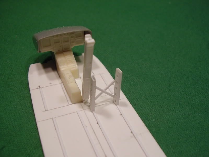

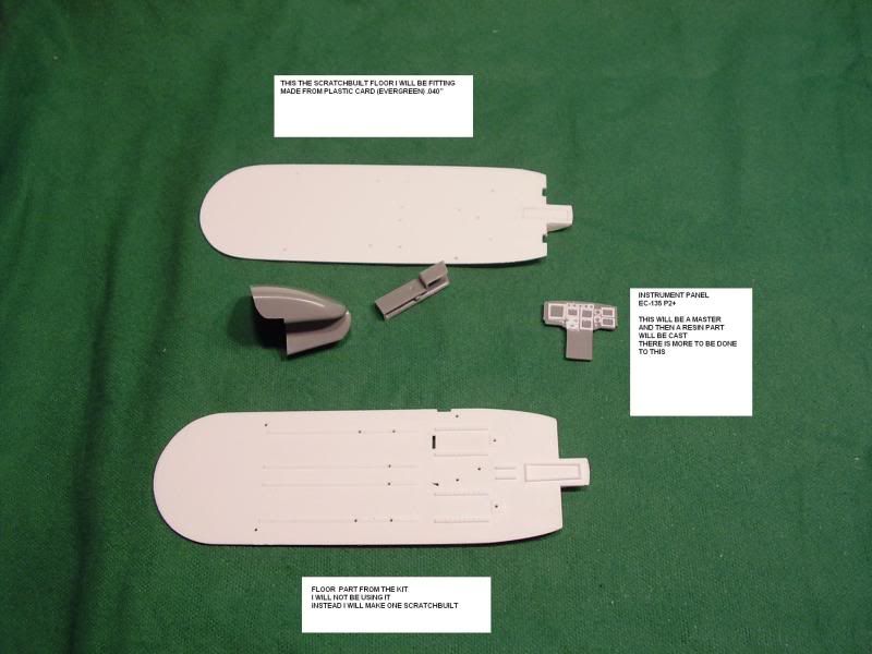

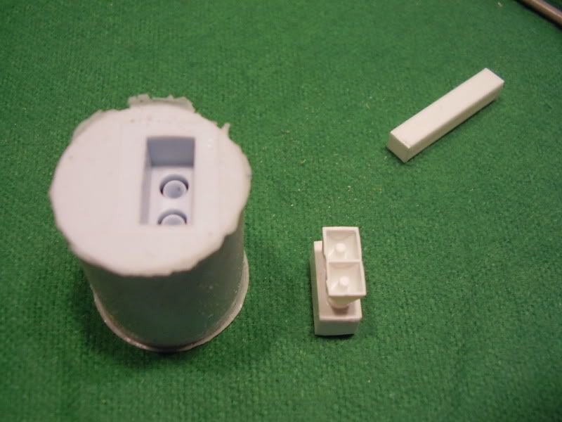

Paul @ Parkes682Decals Posted July 10, 2010 Author Share Posted July 10, 2010 Hi All Well here's the Skyshout system being made. The loudspeakers are from the kit but there are only two supplied so i have made a rubber mould ready to cast some more.Also i have started making the floor and instrument panel this also will be cast to make some more for future builds.The Skyshout system needs 4 loudspeakers so ive done some closeups.I like to use a "blank canvas" for the cockpit/cabin area as much as possible. I will show the castings as soon as they harden up Link to comment Share on other sites More sharing options...

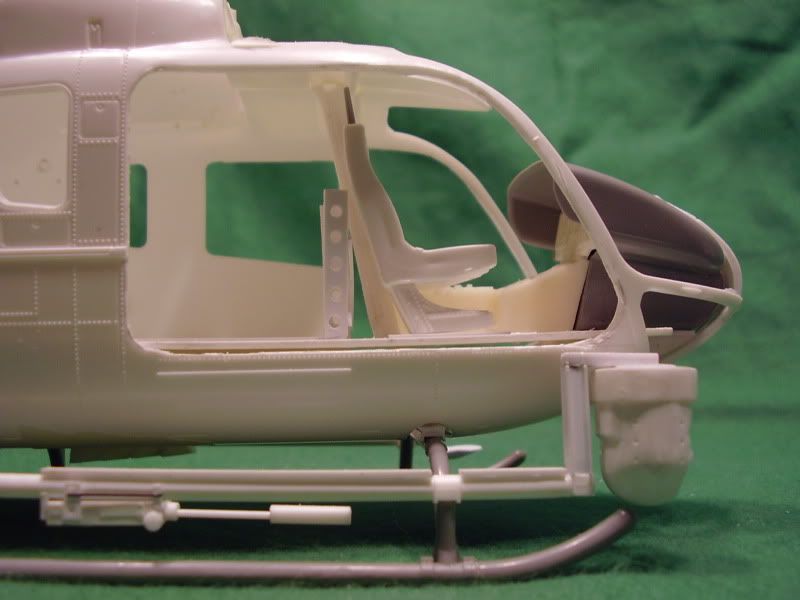

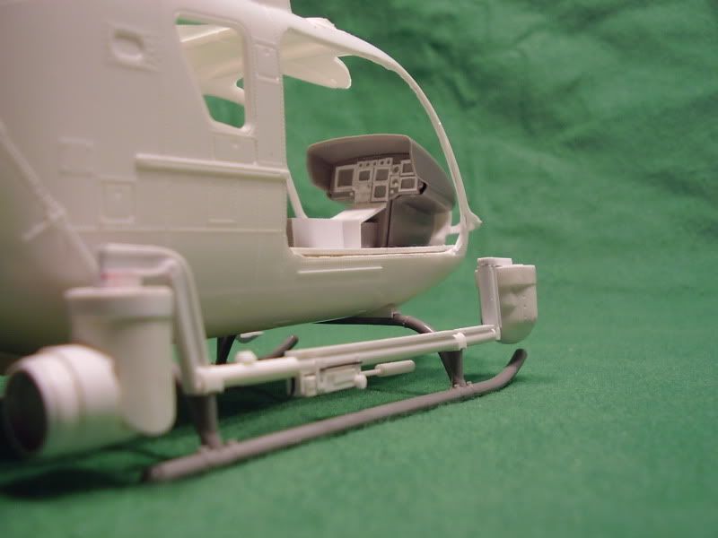

Paul @ Parkes682Decals Posted July 13, 2010 Author Share Posted July 13, 2010 Hi All Well the build continues with the cockpit/cabin area started. The skids are now done apart from some small work with electrical connections and small bits on the skid frame work. Here's the skyshout loudspeaker finished and fitted into place complete with the foot plate for the front observer on the front of the skid Port side The cockpit area is coming along nice with the instrument panels going in the seats are as the kit,they are the only parts in the kit i use inside apart from the instrument shroud. The rear observer position has 2 screens and a computer console with radio boxes on the ceiling to go in next. Well have a look at the photos Paul Notice the resin castings used for this build,which i cast myself Link to comment Share on other sites More sharing options...

Paul @ Parkes682Decals Posted July 16, 2010 Author Share Posted July 16, 2010 Hi All Here's the latest in the cockpit build,the instrument panel has been finished ready for silicone rubber moulding and casting.Here's the results in the photo's and the rear observer position has been started.Also the seat is ready to go in for the pilots posistion on the starboard side. Paul Link to comment Share on other sites More sharing options...
